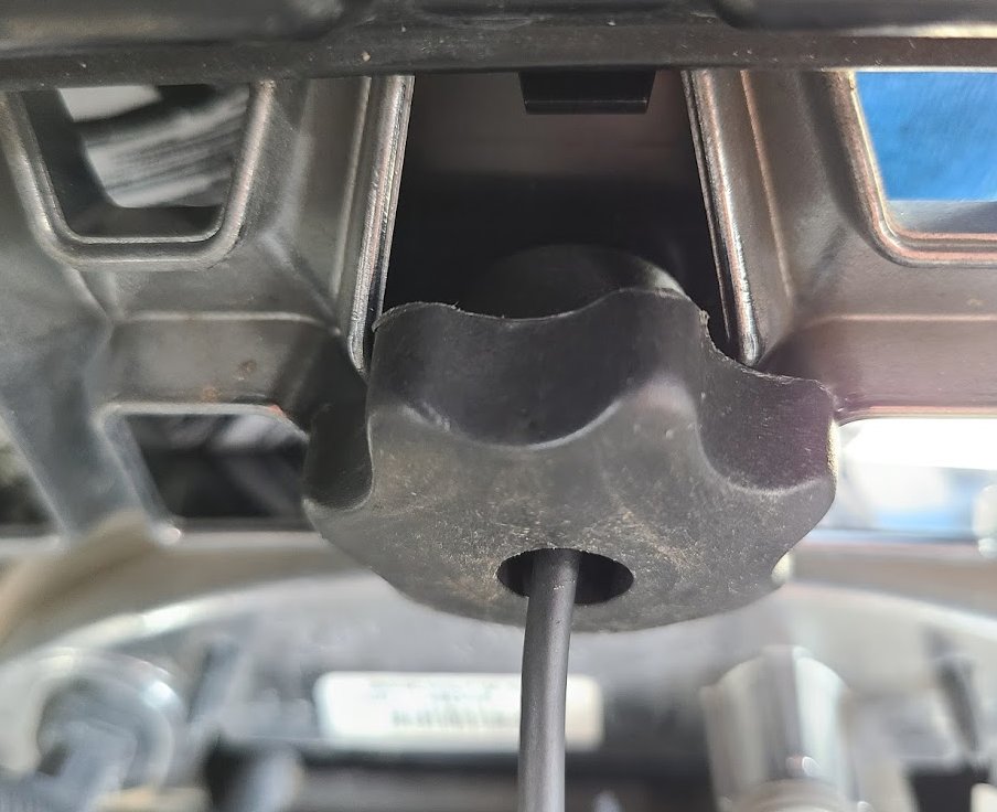

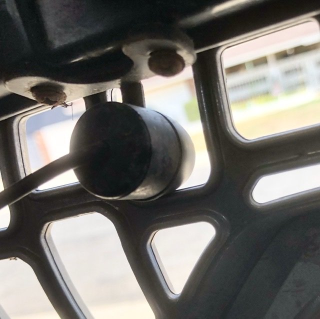

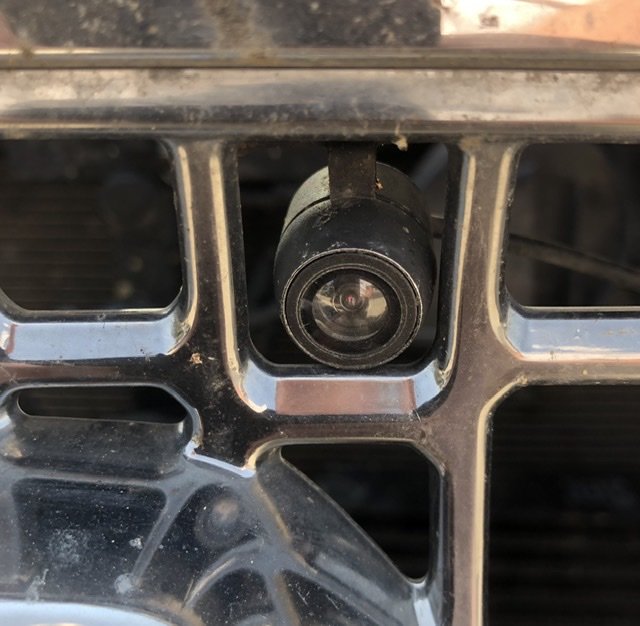

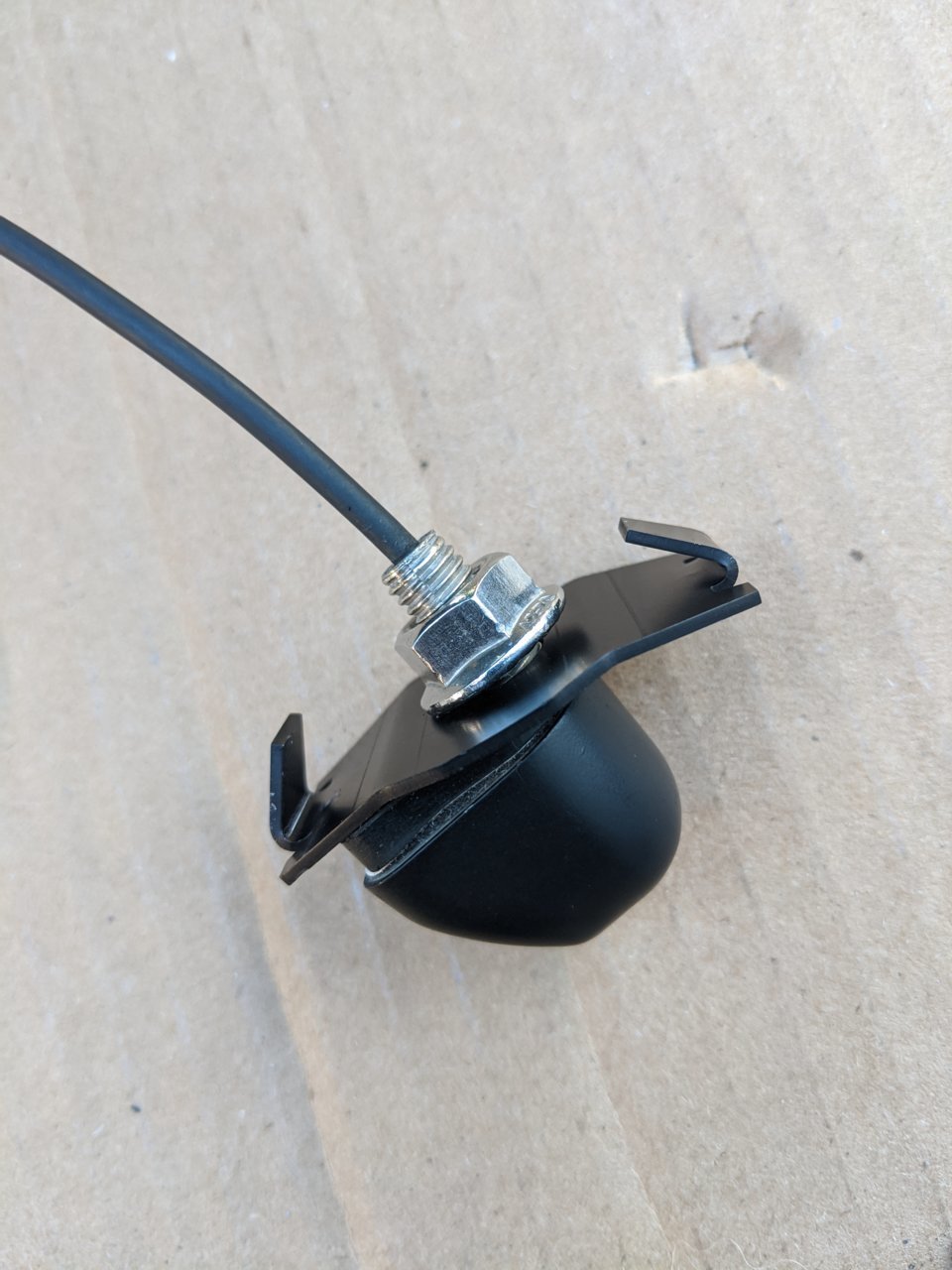

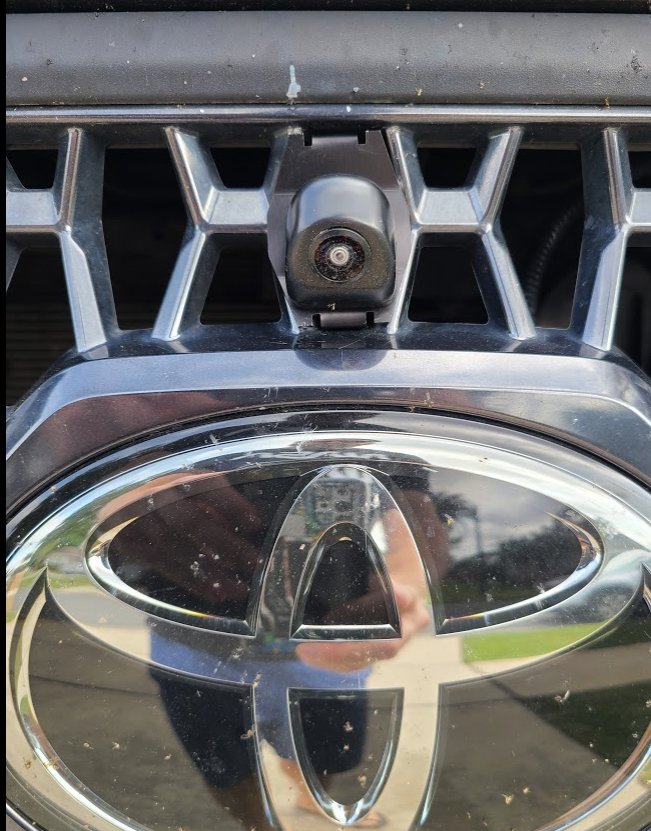

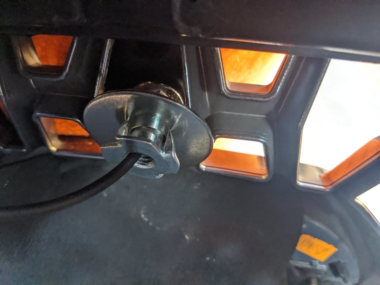

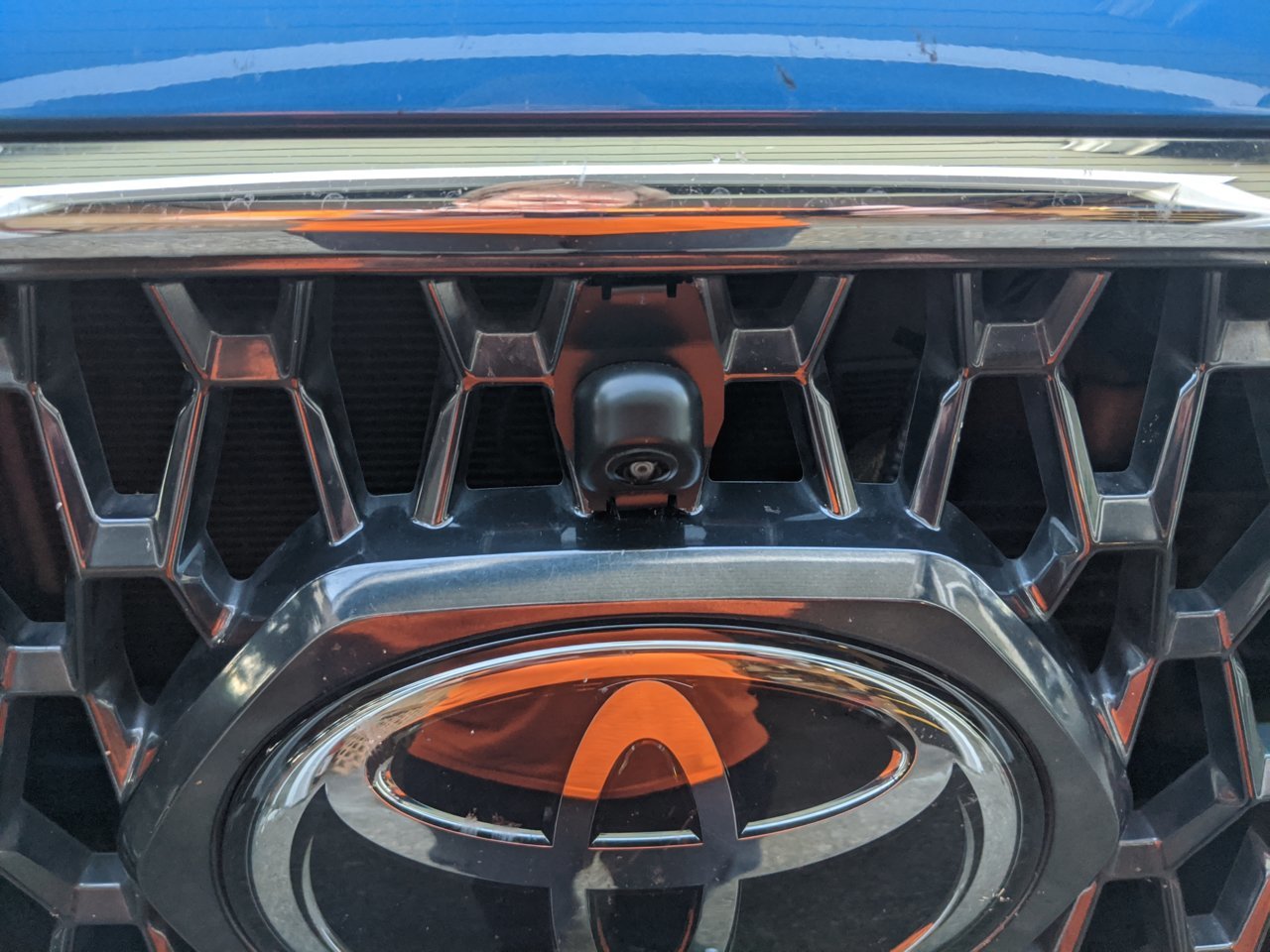

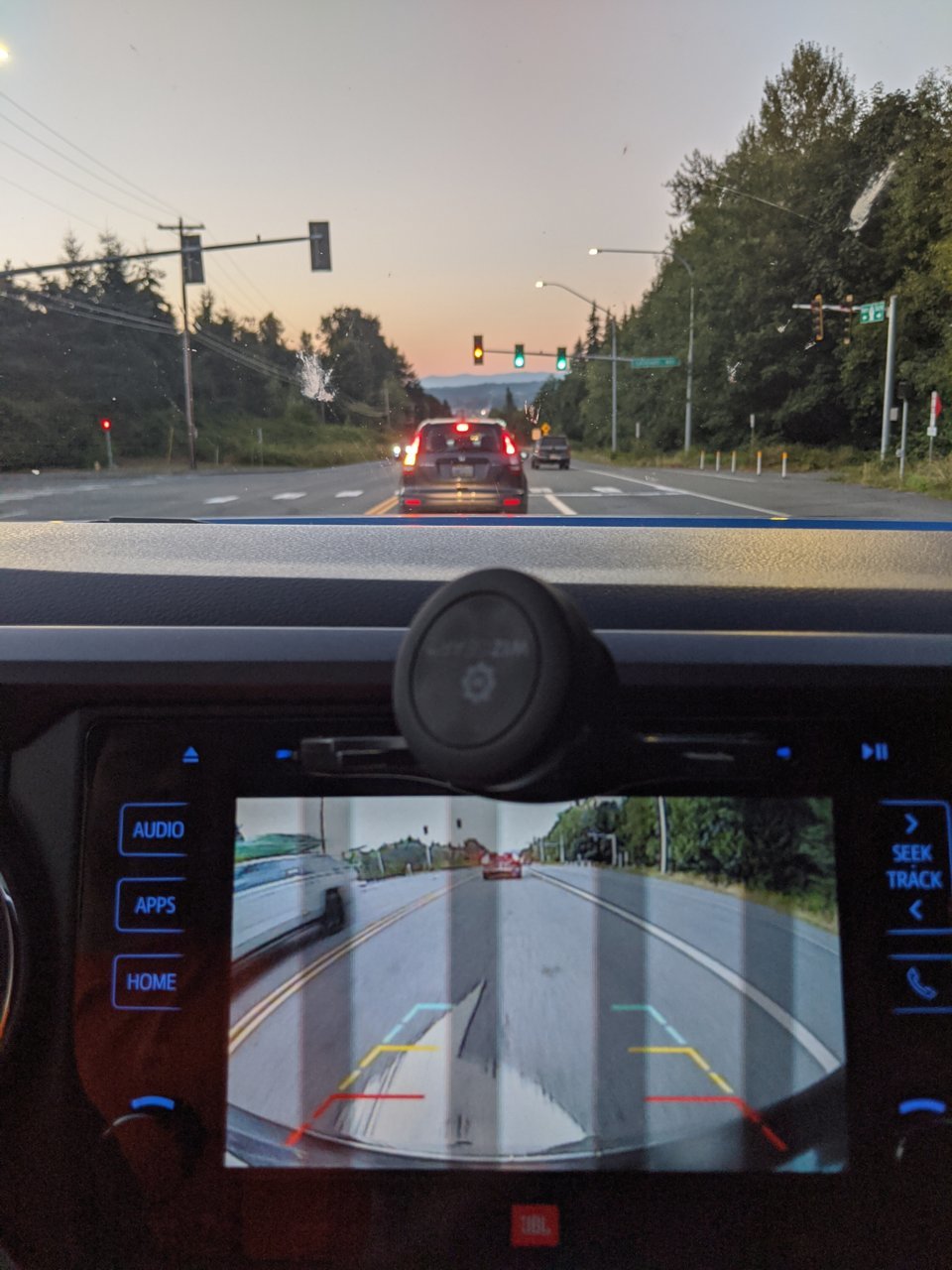

    So I moved my cam from under the bumper into the grill using the bracket and some fitting that allowed me to extend the screw on the nakita.
    The camera is good quality image and has a very tiny connection. I wanted to show a pic of that.
    This install is easy and no need to remove the grill or drill... IMG_20200825_175435.jpg IMG_20200825_175512.jpg IMG_20200825_180547.jpg IMG_20200825_181515.jpg IMG_20200825_193436.jpg IMG_20200825_200432.jpg IMG_20200825_182943.jpg

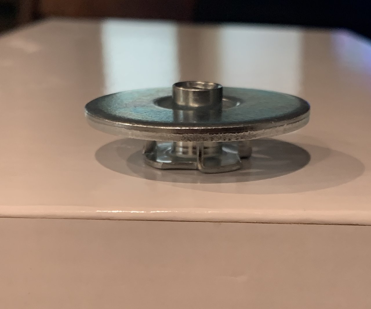

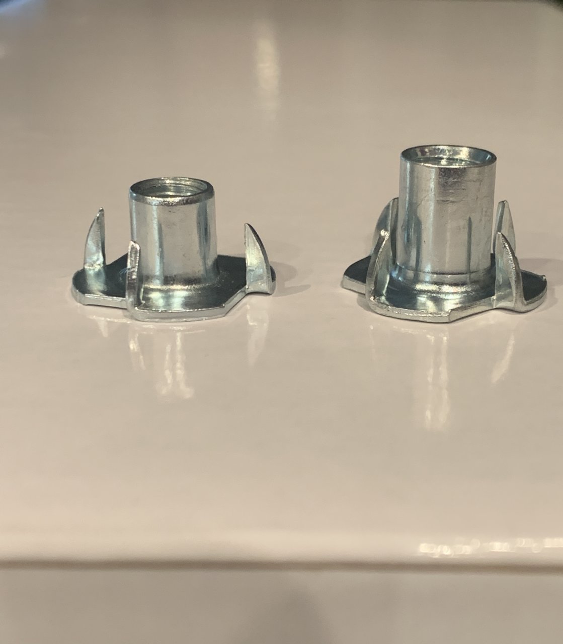

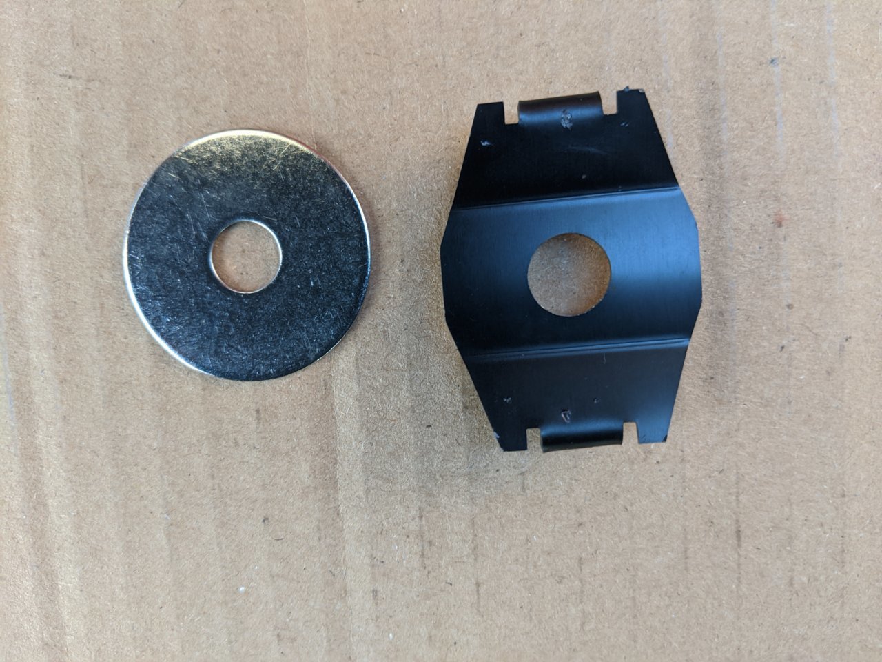

    So for anyone interested, here’s a pic of the long barreled pronged t-nut next to the standard one I bought. In my case, I needed it to reach through the washer to screw onto the natika camera thread while the prongs push into the washer to hold it in place behind the grill.

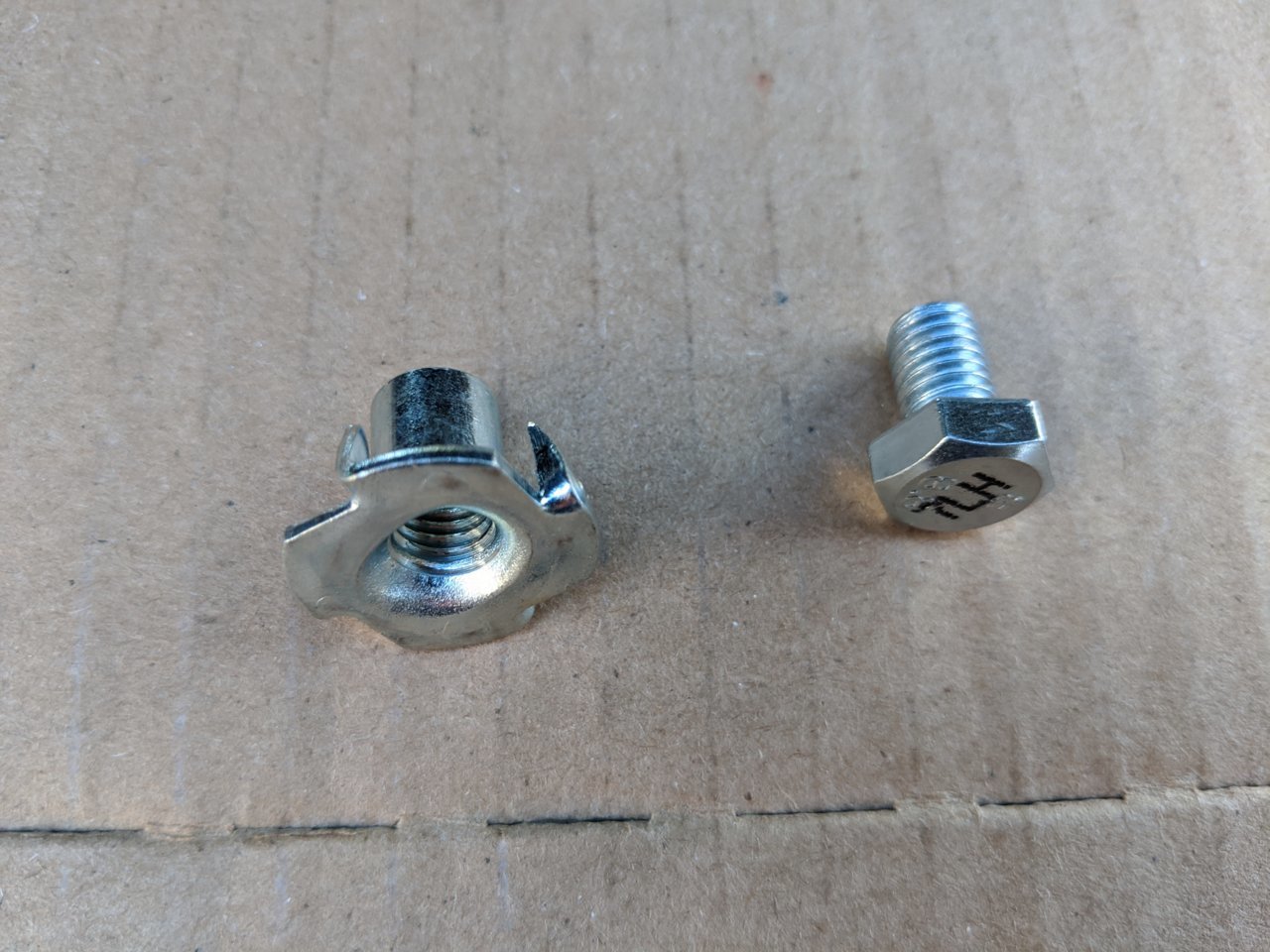

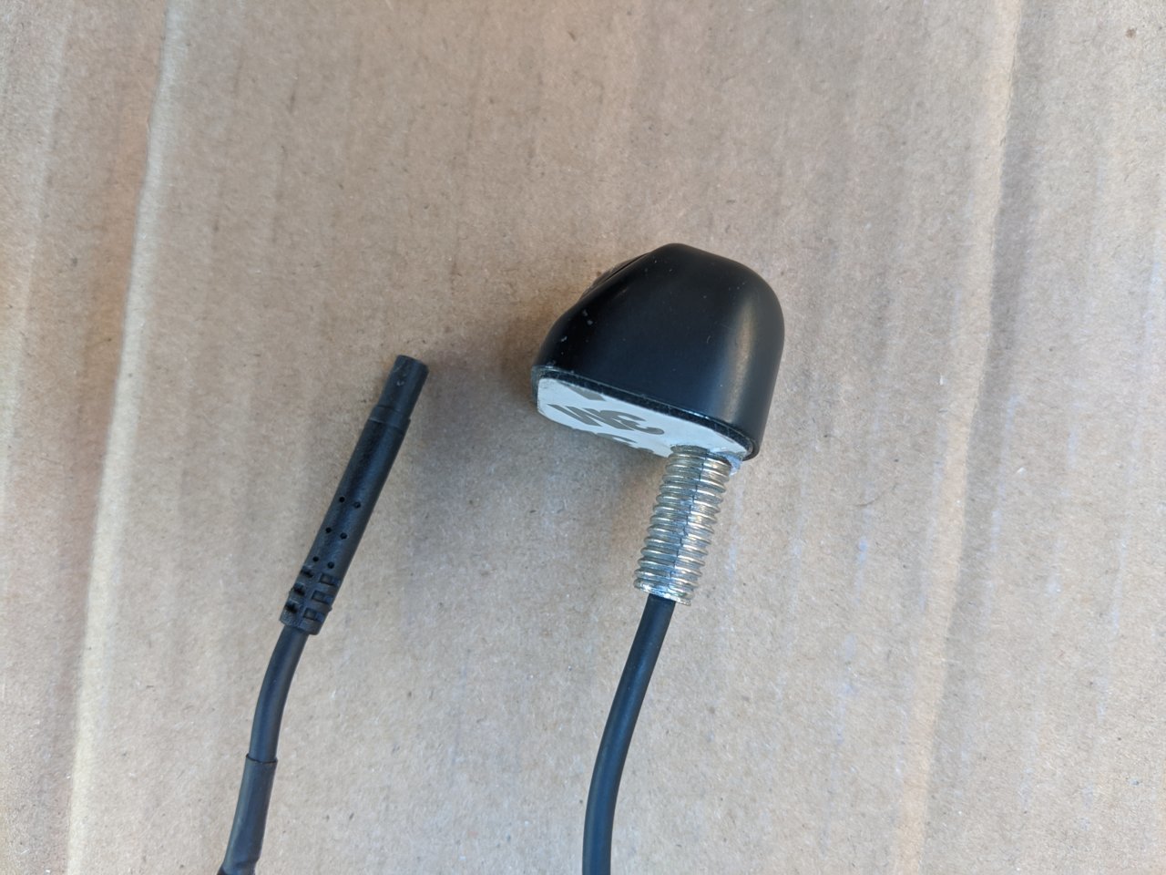

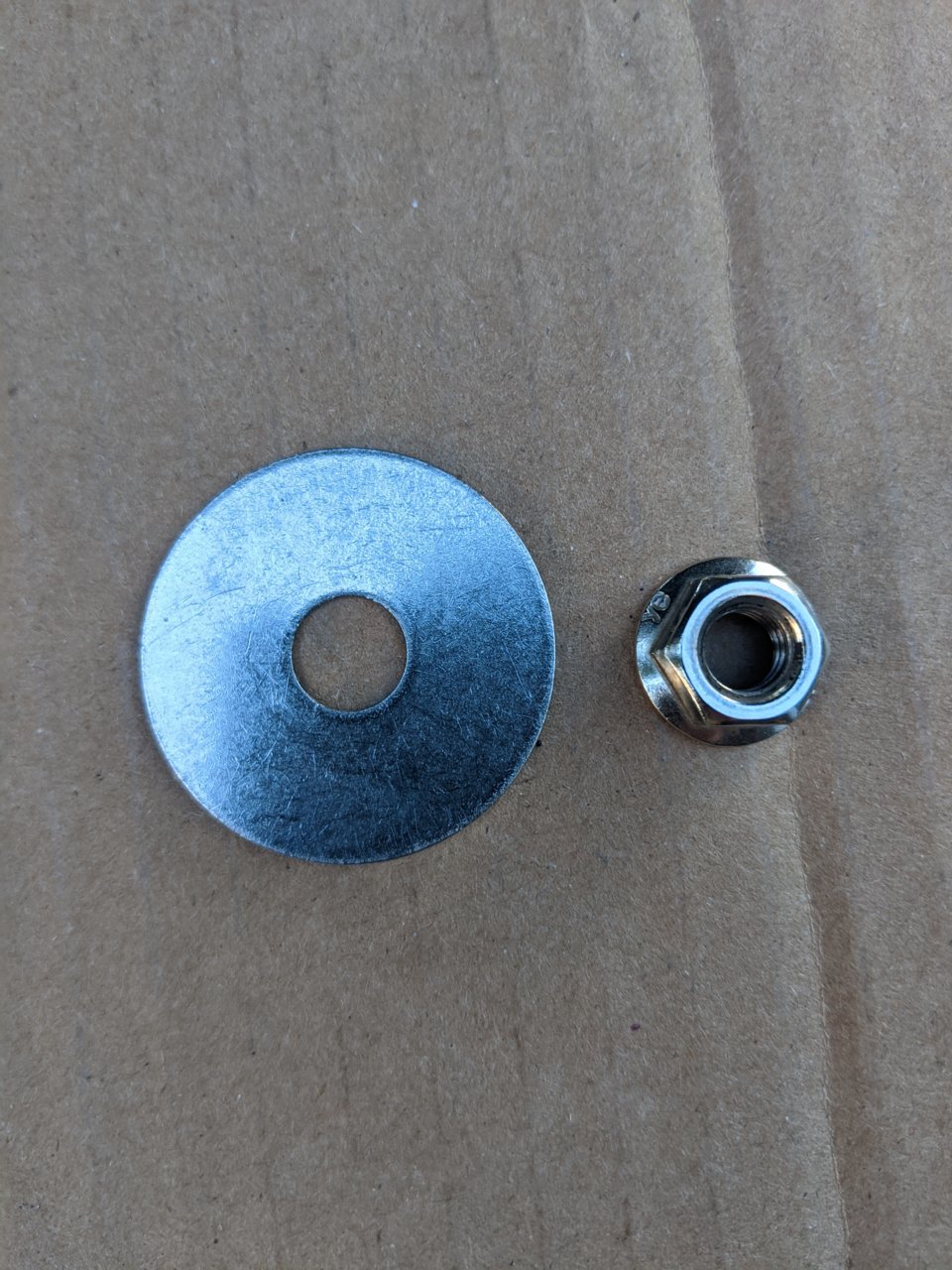

    This is what I did. Quoting from another thread. Hope this helps.
