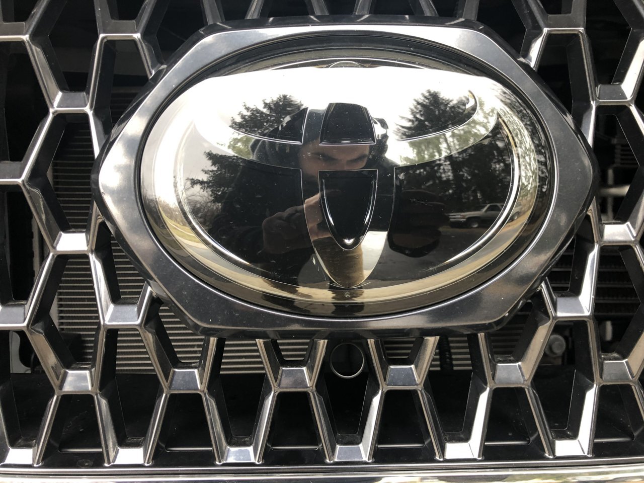

    Trying to figure out where to mount camera on front.
    Bought the camera designed to go into the toyota emblem - thinking it should go in a round space in the chickenwire - but I don't think so...
    Heres the grill:

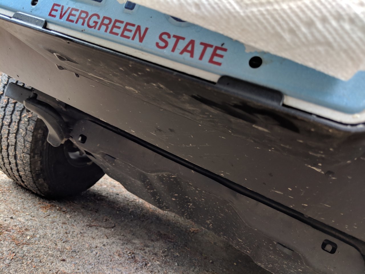

    Should I put it on the bottom of the grill surround trim - just take it off and drill a hole - or put it under the license plate holder:
    TYIA!

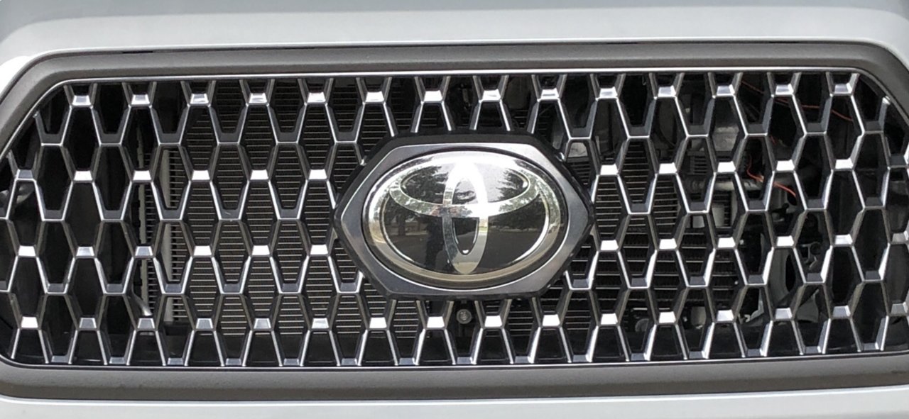

    My camera is like the second one you posted. I flipped the mount around so the wings faced forward. That will sit on a lip on the back of the grill where you see my camera is. I then epoxied it.
    I did all of this with the grill removed and the camera not in the mount. I spent a few days driving around with just the ring mounted to let it cure:

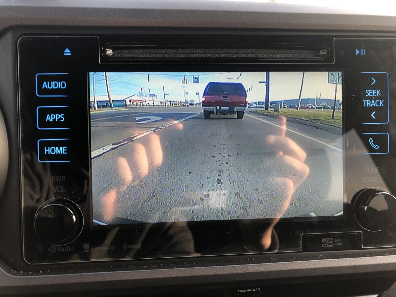

    Thanks! Yes, it goes back to the head unit where this device is installed inline with some of the cables that go to the head unit: https://car-solutions.com/en/rfcc-ttg2-car-camera-control-system-for-toyota-touch-2-entune.php
    With this installed, pressing the MODE button on the steering wheel brings up the front camera, then hitting the down arrow switches to the read camera. You can switch back and forth at any time using the arrows. Hitting the MODE button (or 30 seconds of inactiving) makes the head unit go back to whatever it was showing before. This does not interfere with anything that is currently playing on the head unit.
