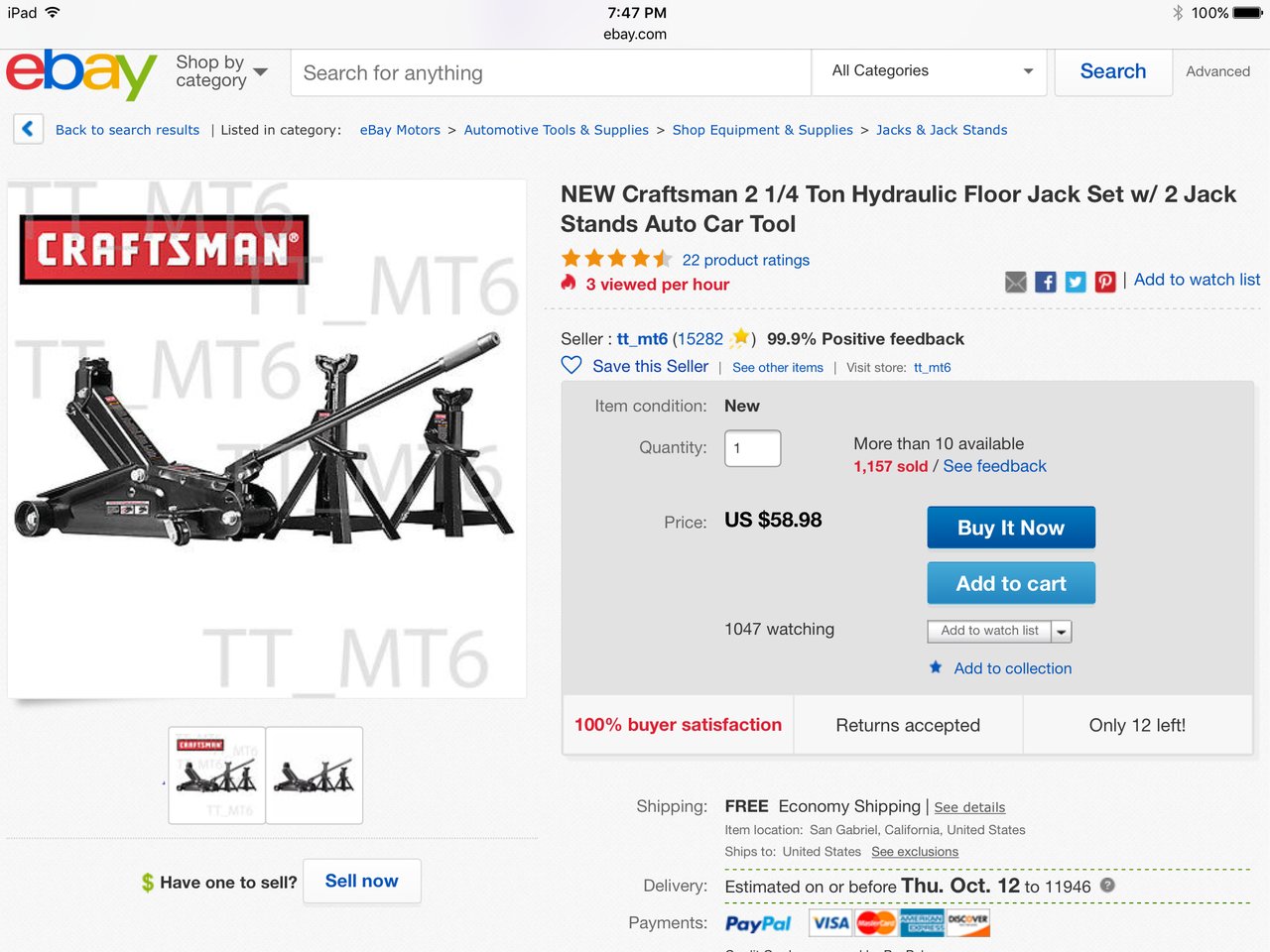

    3,992

    Hmmmm, I'll check on there too, I've been avoiding ebay because the last thing I ordered I was charged for and never got, had to get ebay to step in and refund me.

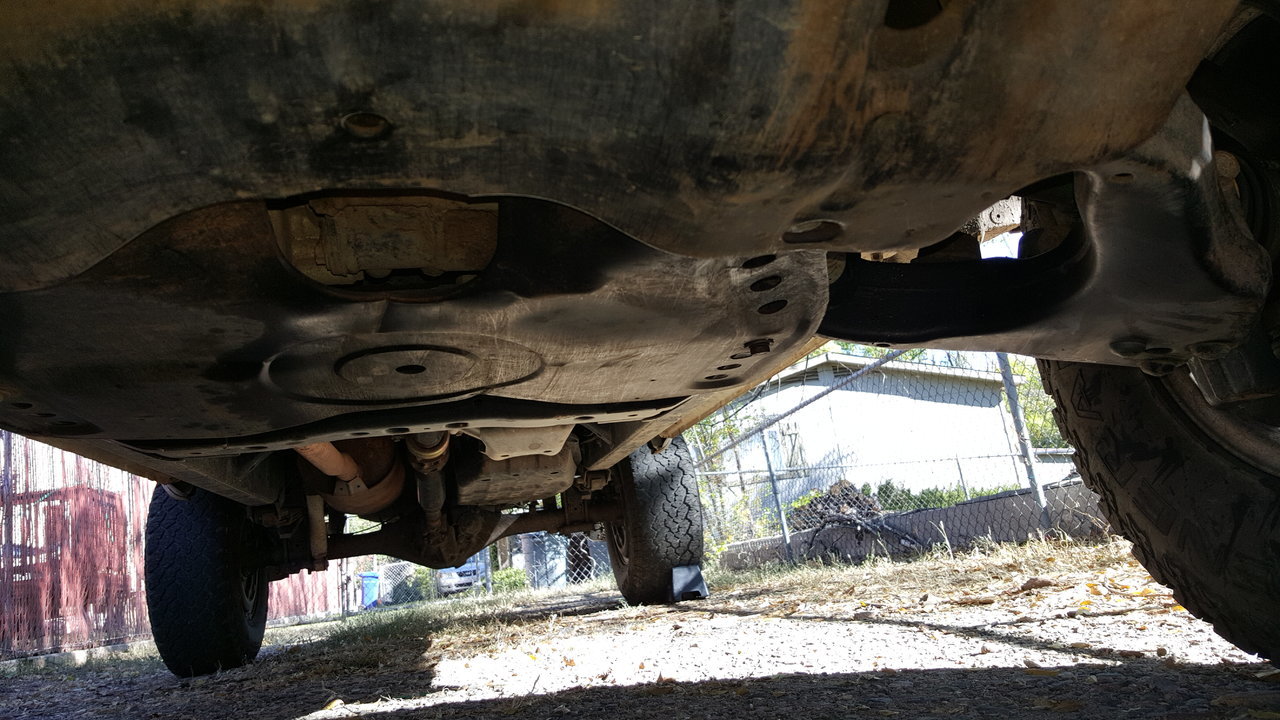

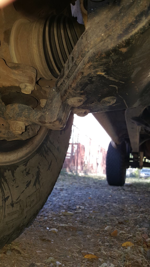

    So I got some pictures. This is where I've been lifting at

    And, if I'm reading that picture right, I should be lifting from here. But my truck is armored, so how does that change things? There is a little bit of room between the plate and the truck, not a lot, but it's rather not bend it or have to fight with taking it off whenever I lift

    The front jack goes directly under the crossmember, center of vehicle, some people may have armor that covers that up. Also in that case, if the skid plate is pushed up against the crossmember you should still be able to still use that position. If the skid plate is not touching the crossmember you may bend it do to the weight of the truck and thickness of the skid.

    You jack it up on the LCA?

    Maybe you could stick a piece of 2x4 in between the armor and crossmember while you jack up the truck. Just don't forget to remove it when your done. That would help not to bend the skid. It just depends on the gap distance you have.

    i guess looking at the LCA, I don’t see it has really that strong enough to hold that much weight without damaging it.
