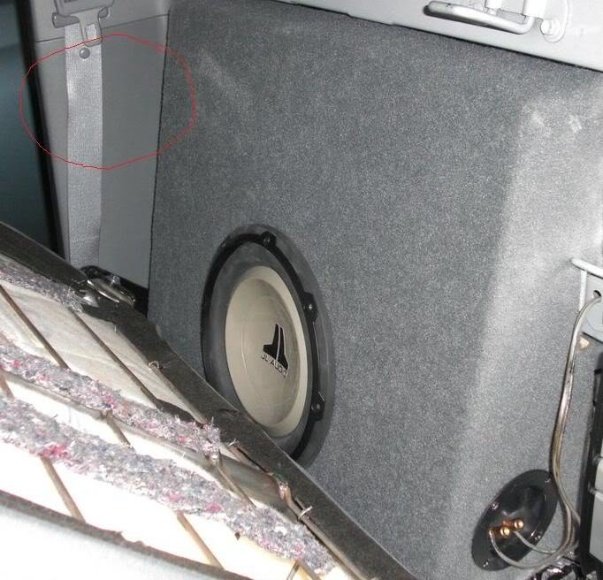

    When I did my friends extra cab I installed them in the picture below thats circled in red.

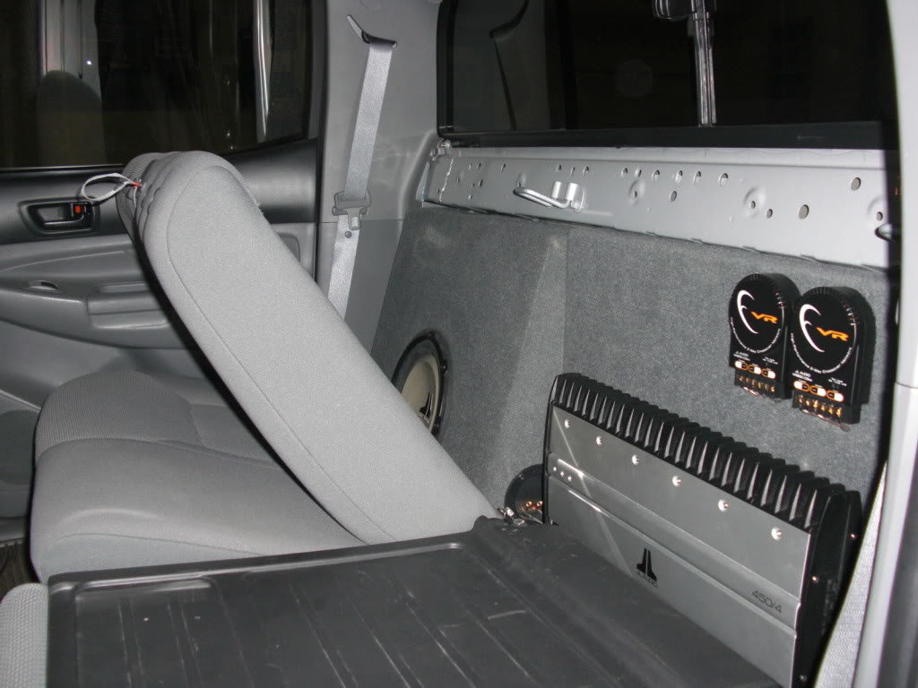

    This is how I did my system
