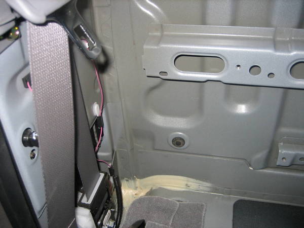

    Here is how I ran the Coax antenna cable to the antenna.
    Here is the grommet that I am going to use.

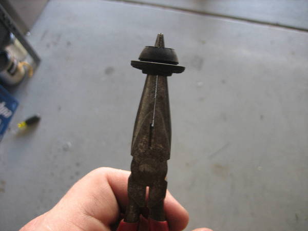

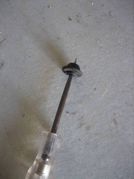

    I pulled out the grommet and used a sharp tool to poke a hole into it.
    I shoved my needle nose pliers through the hole.

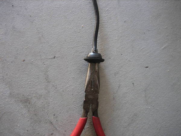

    And grabbed a hold of the wire.
    [​IMG][​IMG]
    Slide the grommet over the wire.
    [​IMG][​IMG]

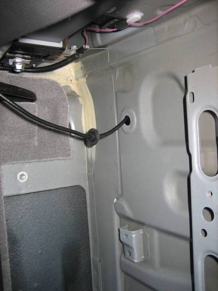

    Finally put the grommet back into the hole.
    [​IMG][​IMG]
    Its water tight and you don't have to drill any holes in your truck. Now I ran the cable under the right rear door floor panel to the passenger seat. There is already a channel with wires under that floor panel with room for 1 more wire...
