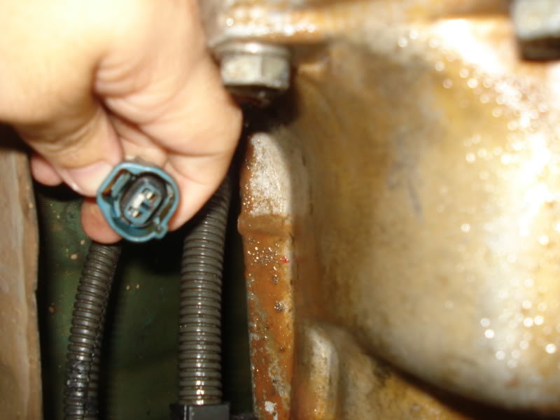

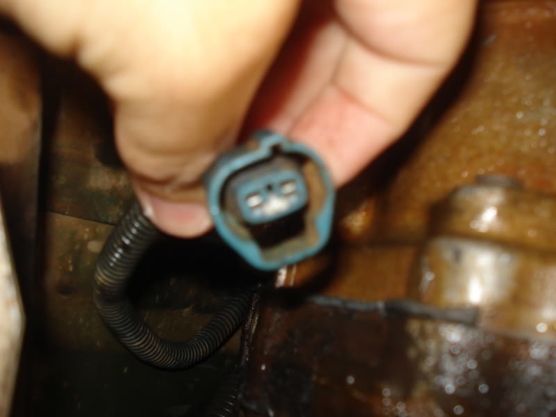

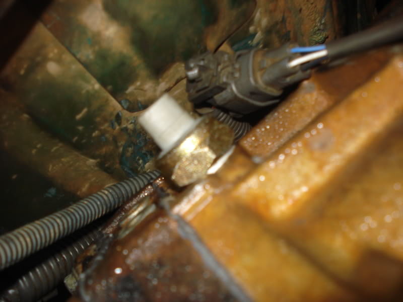

    I recently removed and install a transmission and dont know where these wires go! Will they affect anything?

    What was in there before as far as tranny goes?

    it was the same kind of tranny

    Well i would say Rever light and Nutral safty switch.
    But i think i am wrong.
    If it was the same tranny, look at the old tranny and see if it has the same fitting.

    Reverse switch, 4x4 indicator, speedo, and one looks like an O2 plug (the black one).
