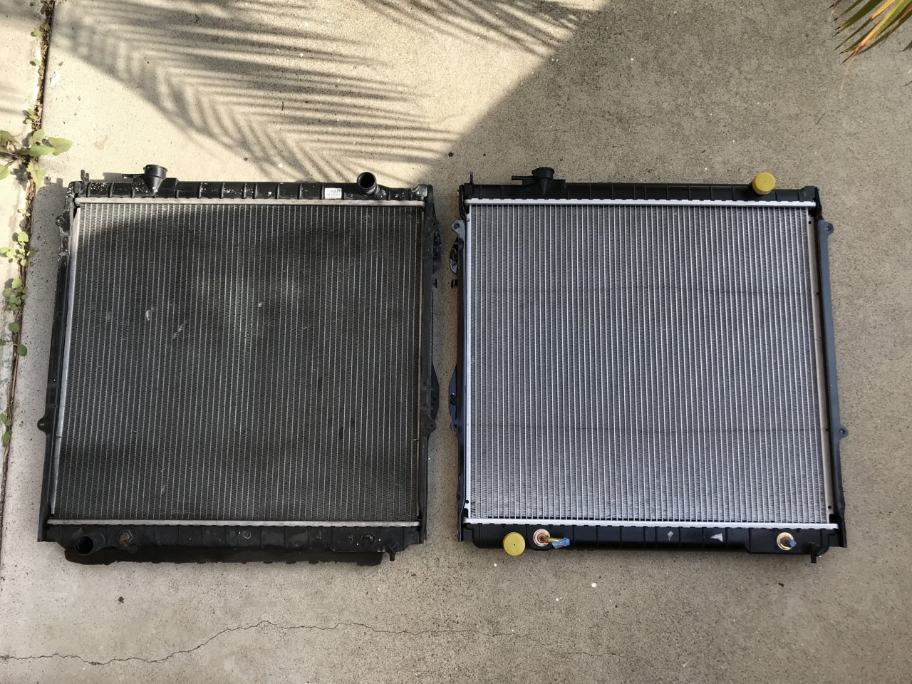

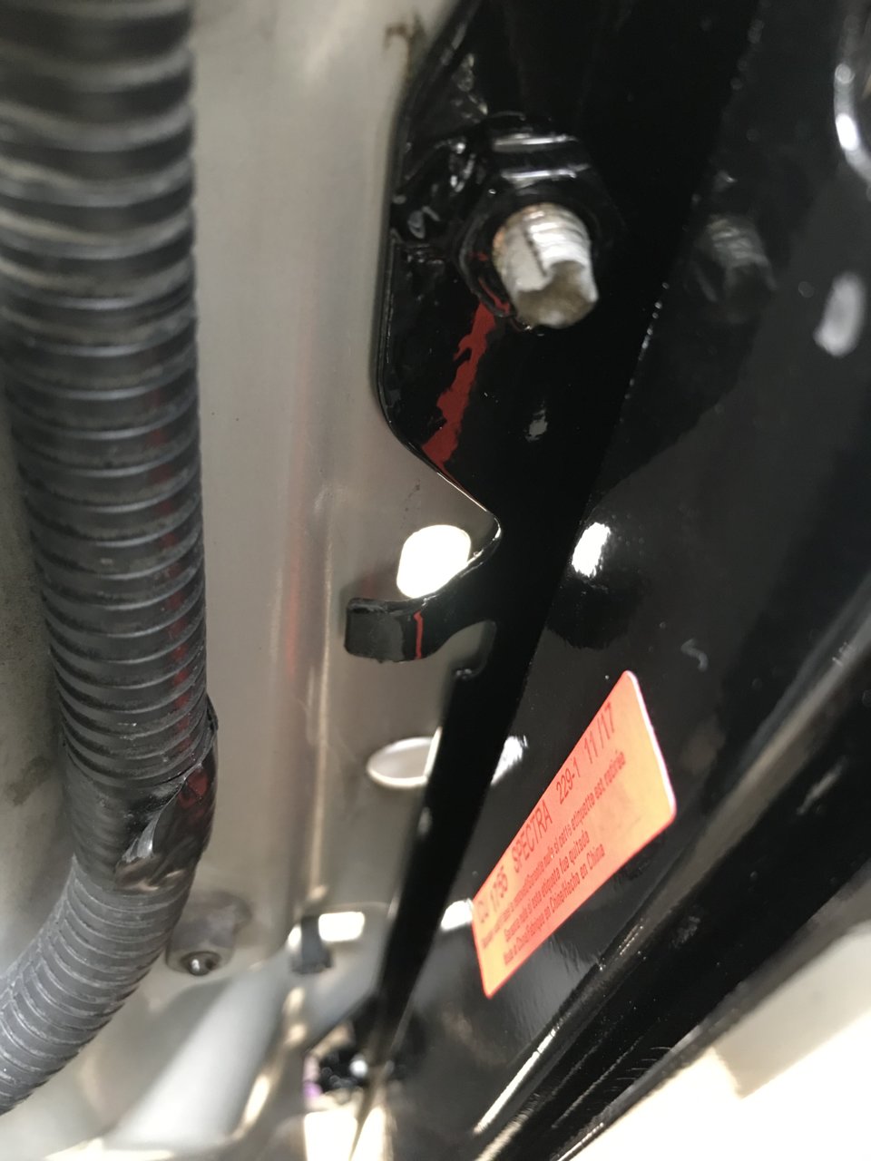

    Just started doing the swap. My radiator cracked/leaked at the top, plastic tank.
    For reference if anyone is concerned I picked up a Spectra for my 2002 Tacoma Prerunner (2.7L automatic) from Pep Boys. If you have a Pep Boys in your area, order online and you get 25% off always. I got my with a radiator cap for under $100.
    Below pic is (left) the Harrison (oem?) old one and (right) the new Spectra radiator. We'll see how long it lasts...

    Update on the Spectra 1755 radiator install. I ran into a common issue of the four mounting bolts not lining up with the OEM holes. However, the problem was the hangers -one on each side of the radiator. I bent one of the hangers away so it wouldn't hook and the four holes lined up enough to bolt the radiator in place. Hope this helps if anyone runs into this.

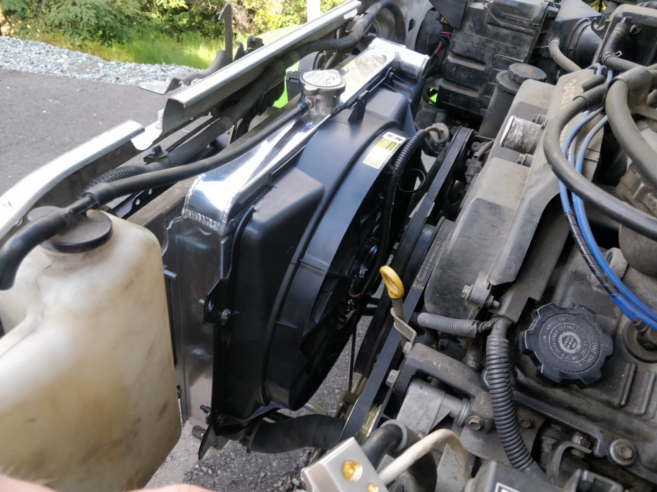

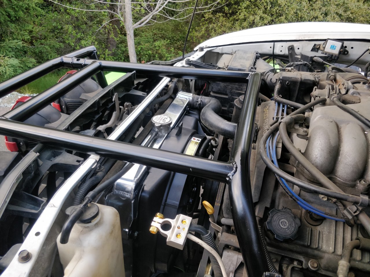

    22re champion radiator version swap with Ford taurus fan mod. Did it for clearancing reasons.

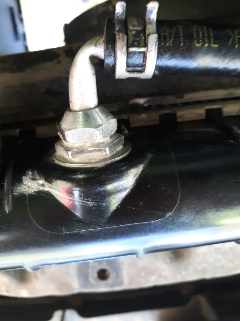

    Has anyone else had an issue with the fitting for connecting the transmission fluid line? I did mine a year ago and have not been able to connect it so than it doesn't slowly leak fluid. Am I missing something? I even got a replacement under warranty for the first attempt thinking that the silver metal piece protruding from the radiator was crimped closed during shipping.

    Where the hoses connects to the fitting or where the fitting connects to the radiator?

    The hose to fitting

    I'd try a smaller hose, or bigger Barb fitting, or a standard hose clamp and tighten it down good.

    I may have misled you on the type of fitting. It doesn't have a clamp, it's got a nut on it that you use a wrench on.

    So the fitting that screws into the radiator? Not the hose that attaches to the fitting?

    Right, the fitting that attaches the hose to the silver tube protruding from the bottom tank.

    Gotcha, this is what mine looks like.
    I put some Teflon tape on the threads before I threaded it in. If you want an even better solution Teflon paste will definitely do the trick.

    That's a good idea, although I was thinking of that previously and didn't because I figured the tranny fluid would just eat it...I have some paste at home that I'll give a whirl.

    Nah I don't think so, seen plenty of people do it.

    That's what I get for overthinking it...

    20190420_141200.jpg thread sealer applied during my oil change today. So far so good I don't see any leaks...

    :bowdown:Thanks for the suggestion RedManRocket! You're my hero...
