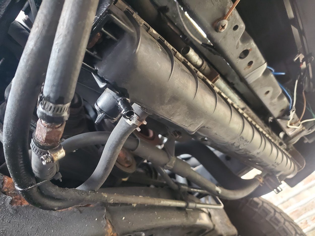

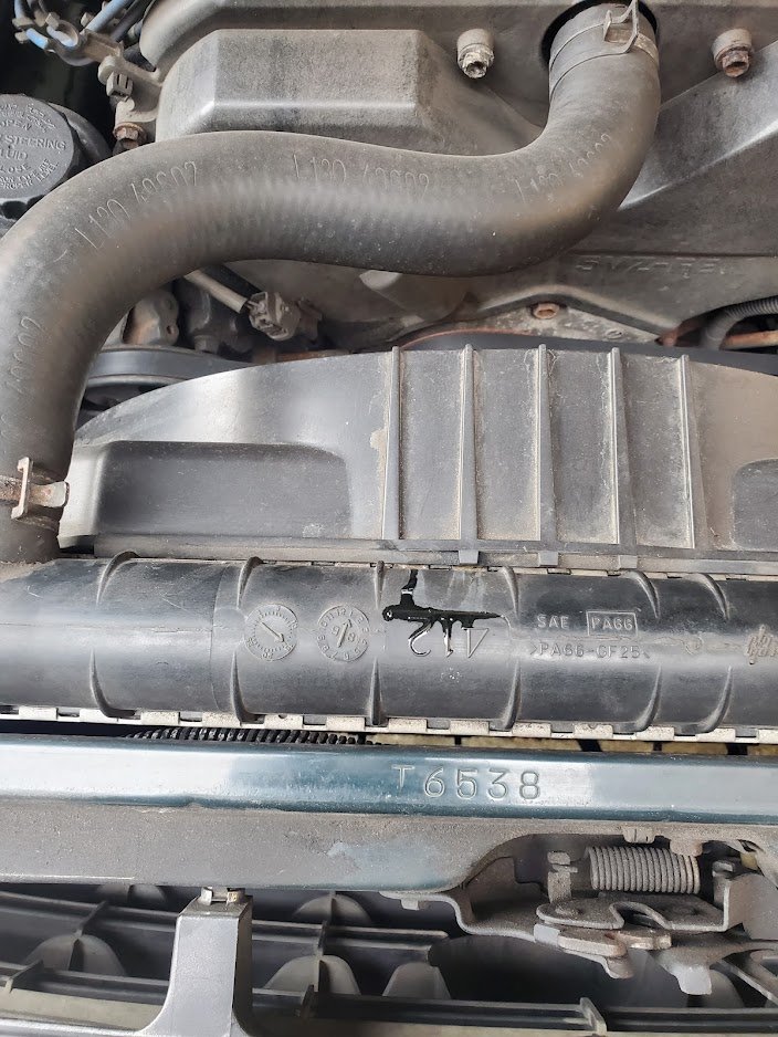

    186k on my 98 sr5.. noticed some rad fluid drip by the petcock.. then realized the fluid was seeping from the plastic seams and the stamped areas of the radiator.. just bought new rad, upper / lower hoses and fluid... looks like there's a small trans cooler rad and another small mystery rad zip tied to the original rad.. installed by the p/o.. not sure if either surplus assembly are hooked up proper.. or at all

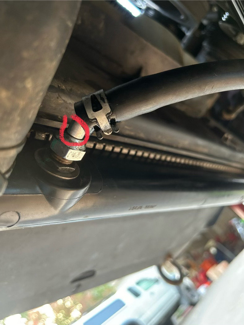

    Hey peeps, I discovered a small leak on this fitting (driver side) back in March. Over the course of about 2 months it drains about half the coolant in the reservoir. I think it's time for a replacement but I couldn't find any vendor that sells this fitting individually....? Or do I have to replace the whole radiatoro_O?
    PS: there is some play btwn where the elbow meets the nut (circled in red). I tightened the nut just earlier today and ran the truck ~ 5 minutes, seems to stop the leak a bit, but if I can replace the whole fitting, I would. Send me links pls
