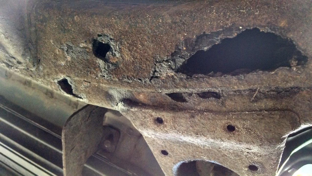

    I sprayed off the undercarriage and found my situation has advanced considerably faster than I would have anticipated.

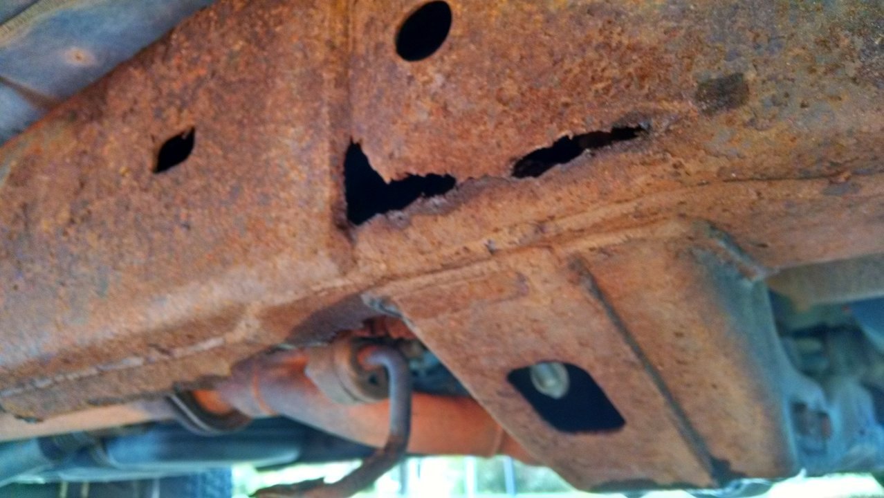

  6. Jul 3, 2017 at 2:20 PM
    #106
    20RustyTaco06
    20RustyTaco06 [OP] Well-Known Member
    Jun 21, 2017
    #222088
    434
    Allen
    Dublin, GA
    2006 sr5 Tacoma DBL cab auto/4wd
    Complete Pioneer audio Supreme Suspension 3" spacer lift 255/75-17 Kuhmos/Sport wheels 1.25" wheel spacers Tint
    IMG_20170703_161906583.jpg My exhaust hanger has rusted from the frame so now I'm developing a leak at the union.
    This is what's behind the hole on the passenger frame rail.

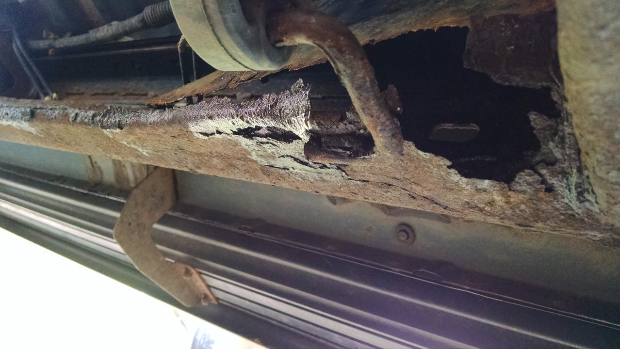

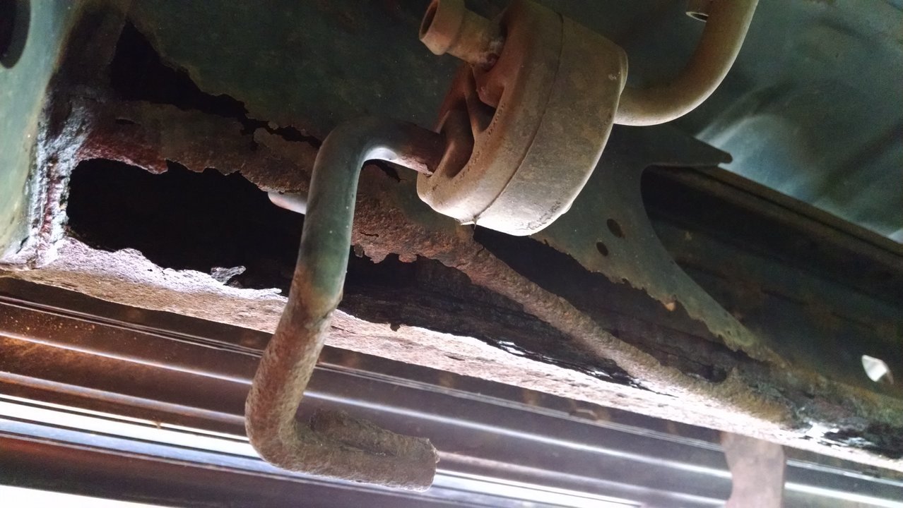

  7. Jul 3, 2017 at 2:23 PM
    #107
    20RustyTaco06
    Jun 21, 2017
    #222088
    434
    Allen
    Dublin, GA

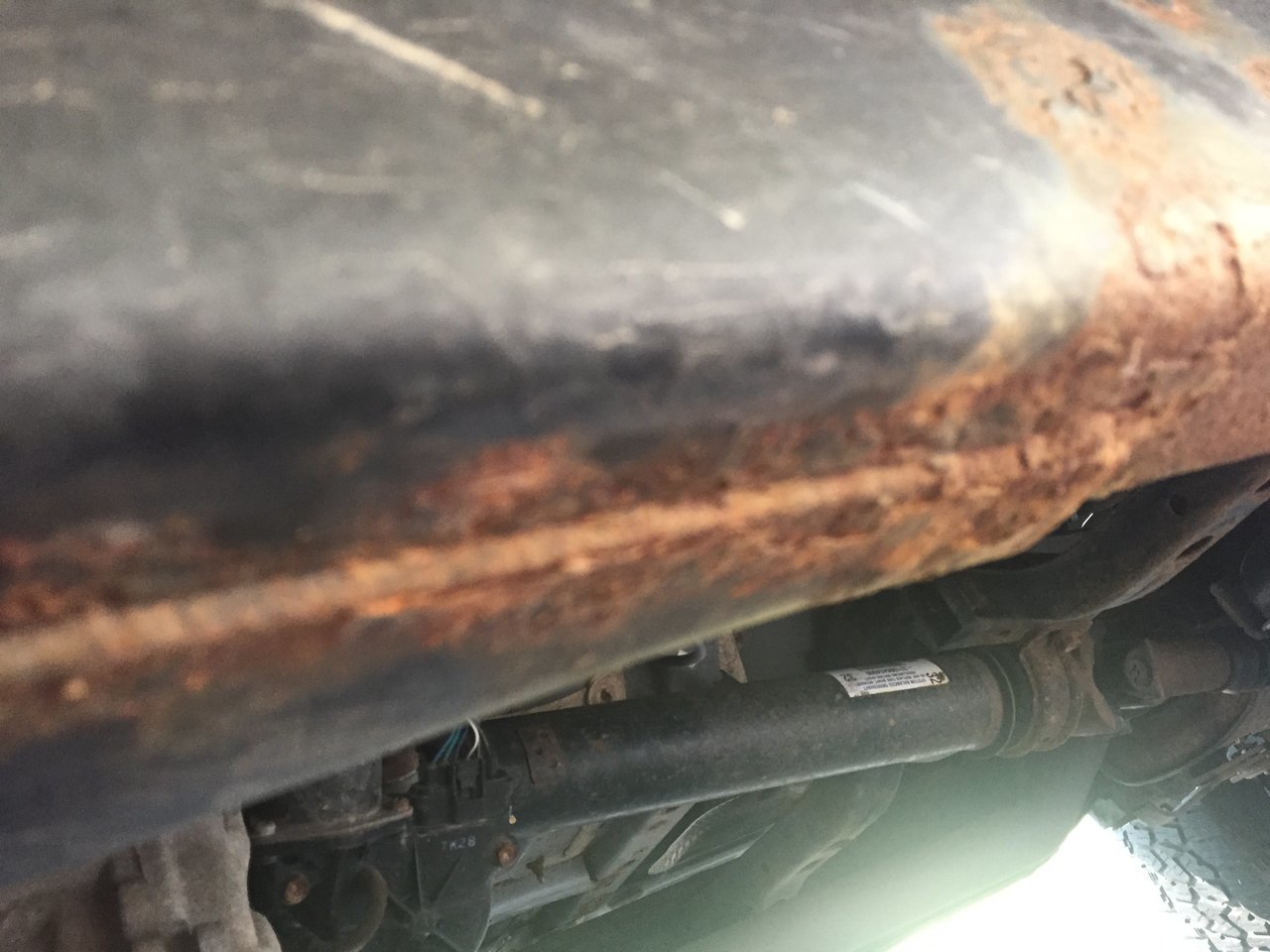

    IMG_20170703_162139605.jpg This one's of the driver's side.
  8. Jul 3, 2017 at 2:27 PM
    #108
    20RustyTaco06
    Jun 21, 2017
    #222088
    434
    Allen
    Dublin, GA
    IMG_20170703_162313410_HDR.jpg And this here's a new one. I sprayed the area with the water hose and guess I knocked the slab of rust that's been covering it up.
    This is the first holes to develop on the underside of the frame rails. Located on the driver's side rail by the catalytic converter.

  15. Jul 3, 2017 at 6:10 PM
    #115
    03maurderman
    03maurderman Well-Known Member
    May 1, 2016
    #185801
    180
    Bought a 2014 Tacoma new.... the frame was coated inside & out, the springs, axle, front suspension, all either coated or painted...Before the undercarriage got wet, I put it on a lift, removed all the wheels, wrapped the exhaust system & rubber boots and sprayed the entire undercarriage with Cosmoline RP-342 military grade translucent wax coating...Everything got sprayed oil pans, transfer case, drive shaft, anything that could get wet in a rain or salt storm storm.... Toyota in their wisdom covered the holes in the frame behind the front wheels with one time use plastic clips...which broke upon removal...There's about 12 of them at $7.50 each... $90.00 for $24.00 worth of clips at 2 bucks a clip of their worth...As I was doing my rustproofing I discovered a 2-1/4 hole right smack on the side of the frame rail behind the cab mount behind the front wheel....You got to get down with a flash light to find it...but its there, I promise.... So all of the splash from the front wheels kicks up all the dirt & salt and packs nice and tight in an area most Tacoma owners don't know about, as its so well hidden...This very large hole is in the boxed section of the frame..... You just have to wonder after this bloodbath of frame replacements for Tacoma owners, and Toyota which I don't feel sorry for, would simply ignore addressing this hole to cover it with a plastic 2-1/4 CAPLUG....My local dealer told me the visible plastic clips are available, but the cap for the hidden secret is not..and I'm having a difficult time trying to find something to plug this hole with....But the bigger problem lies with the states using these harmful chemicals to "pre treat" the roads prior to snow fall... It really doesn't matter what you drive as that liquid chemical is far worse than salt will eat away anything that drives over it.......
    http://www.cosmolinedirect.com/cosmoline-rp-342-heavy-spray-military-grade-rust-preventive/
    lynyrd3, TOY33 and 20RustyTaco06[OP] like this.
  16. Jul 3, 2017 at 6:11 PM
    #116
    20RustyTaco06
    Jun 21, 2017
    #222088
    434
    Allen
    Dublin, GA
    I would put my money on it being a temper issue. It seems that the metal is delaminating like a soaked piece of plywood.
    I had a piece the size of a hand fall out from above the fuel tank and when I broke it in half there were 4-5 layers all separated by a thin red line of rust. Each layer was 5-10 mil thick.
    2002Tacoma4x4 and TOY33 like this.

  19. Jul 3, 2017 at 7:52 PM
    #119
    cliffyk
    cliffyk Well-Known Member
    Oct 27, 2016
    #200890
    2,031
    Cliff
    Saint Augustine, FL
    2009 DCSB SR5 TRD Sport 145k miles

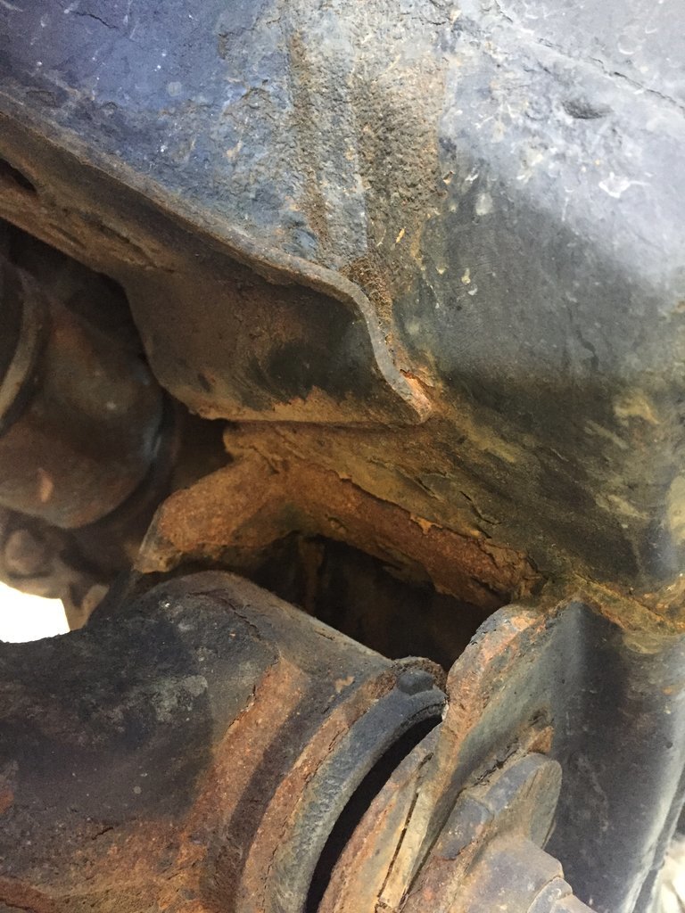

    I posted these earlier in this thread. This is what the frame on my '09 DCSB--always a Florida truck--with 141k miles looks like.
    That being what it is, in my looking at the photos that have been put up here and in other threads, my opinion (and yes, I have one of those apertures too), is that the cold rolled steel used by Toyota¹ to form these frames was not of the "finest kind" by a long shot². And that when subjected to the corrosive effect of the crap spread on the roads in the "CRC States" (as defined in the Brian Warner v. Toyota USA suit), and when maintained as any "normal" person might (define that as you will), it could not hack it and almost literally fell apart.
    Perhaps they should have included a warning indicating that "special maintenance" was required in the rust-bucket states...
    ¹ - Or more likely their sub-contractor, with piss-poor QC on Toyota's end.
    ² - The lamellar and exfoliation corrosion endemic in the Tacoma, Tundra and Sequoia frames in question is a near textbook example of poor process control during the manufacture of the steel from which the frames were formed--most likely a result of temperatures being too low during the rolling process (heat = energy = $$$).
    20RustyTaco06[OP] likes this.

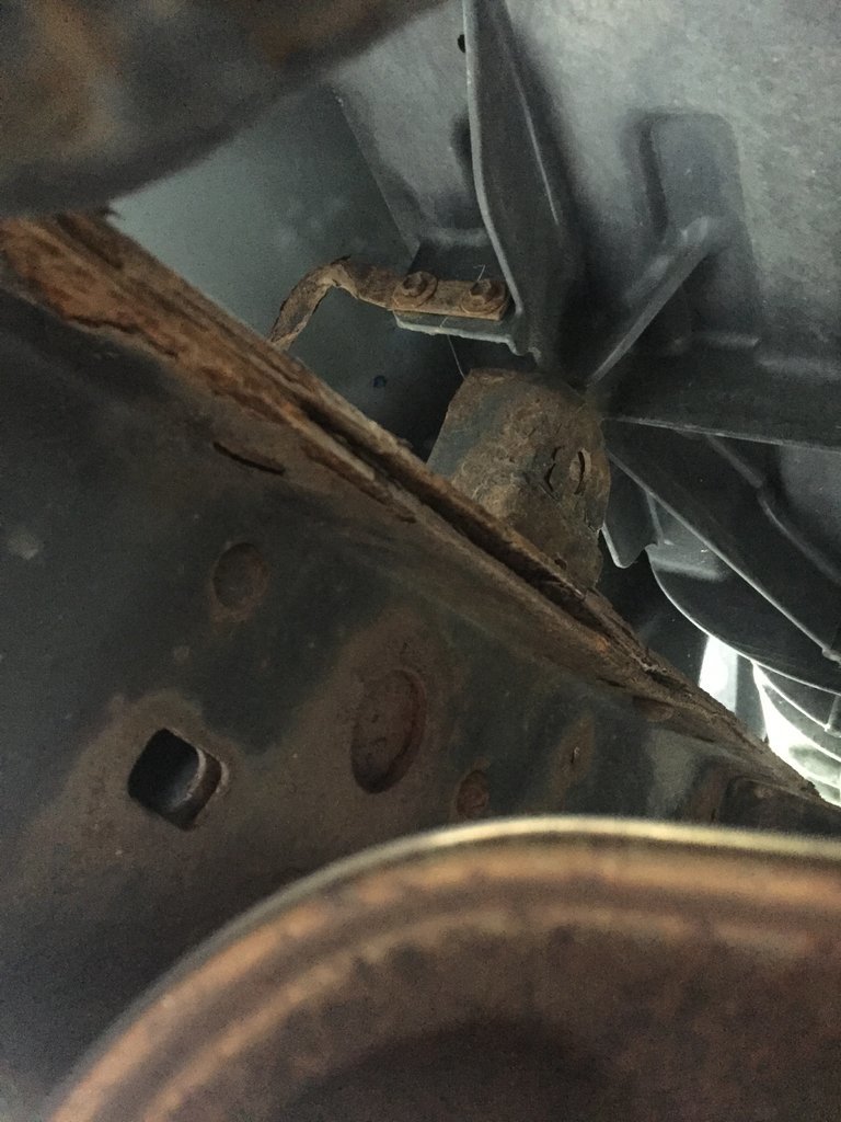

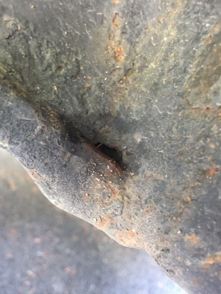

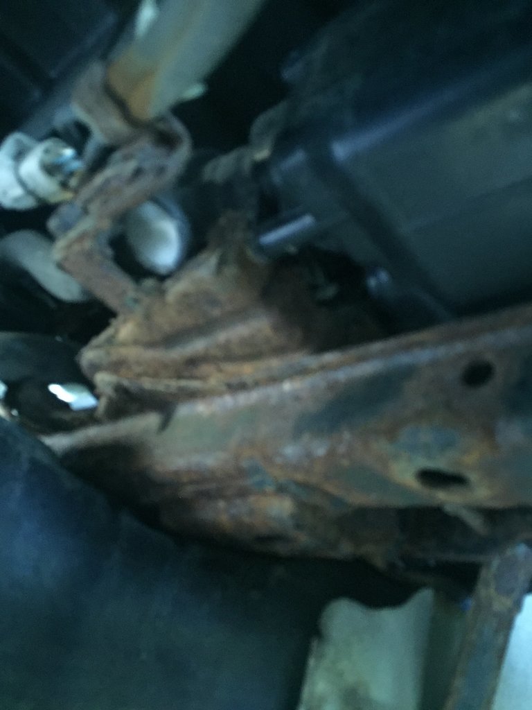

  20. Jul 7, 2017 at 1:27 PM
    #120
    lynyrd3
    Apr 9, 2008
    #5848
    35,777
    Bill
    East Central Upstate NY
    IMG_4686.jpg IMG_4685.jpg IMG_4684.jpg Took another peak under my 2008 with 98000 miles .IMG_4682.jpgIMG_4683.jpg
