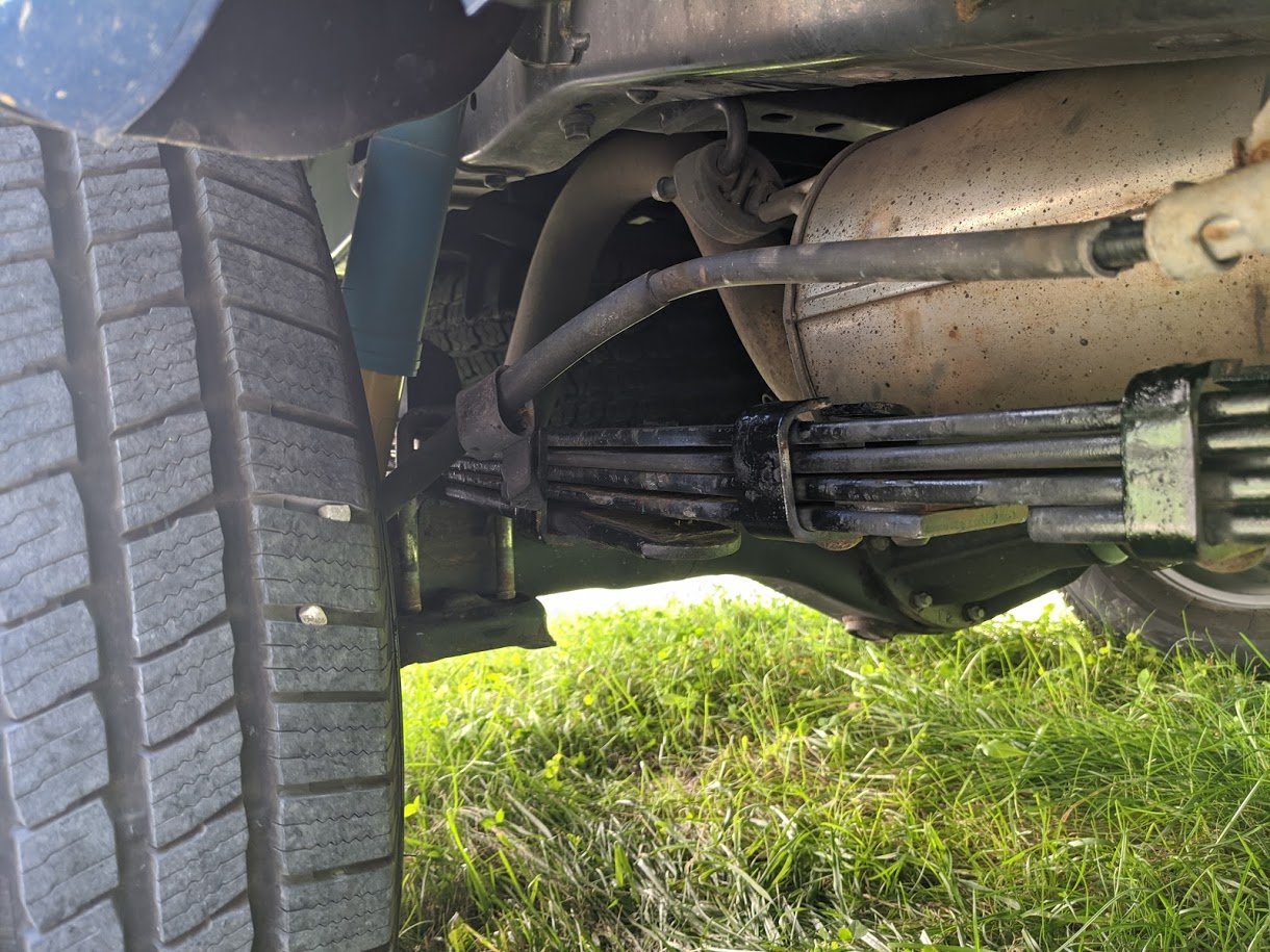

    So to stick a pin in this since there were a few followers. I ended up going to Midway Spring & Trailer in Afton MI and it turned out great. They added in a single long leaf just under the top leaf in the pack. It may settle a smidge, but I gained right around 1.75" which basically put me at or just above stock height (I can't really tell) and the shock has plenty of travel both directions. After a bit of driving the ride quality is also spot on. More money than the wheeler single leaf...but I'm really happy with the solution.

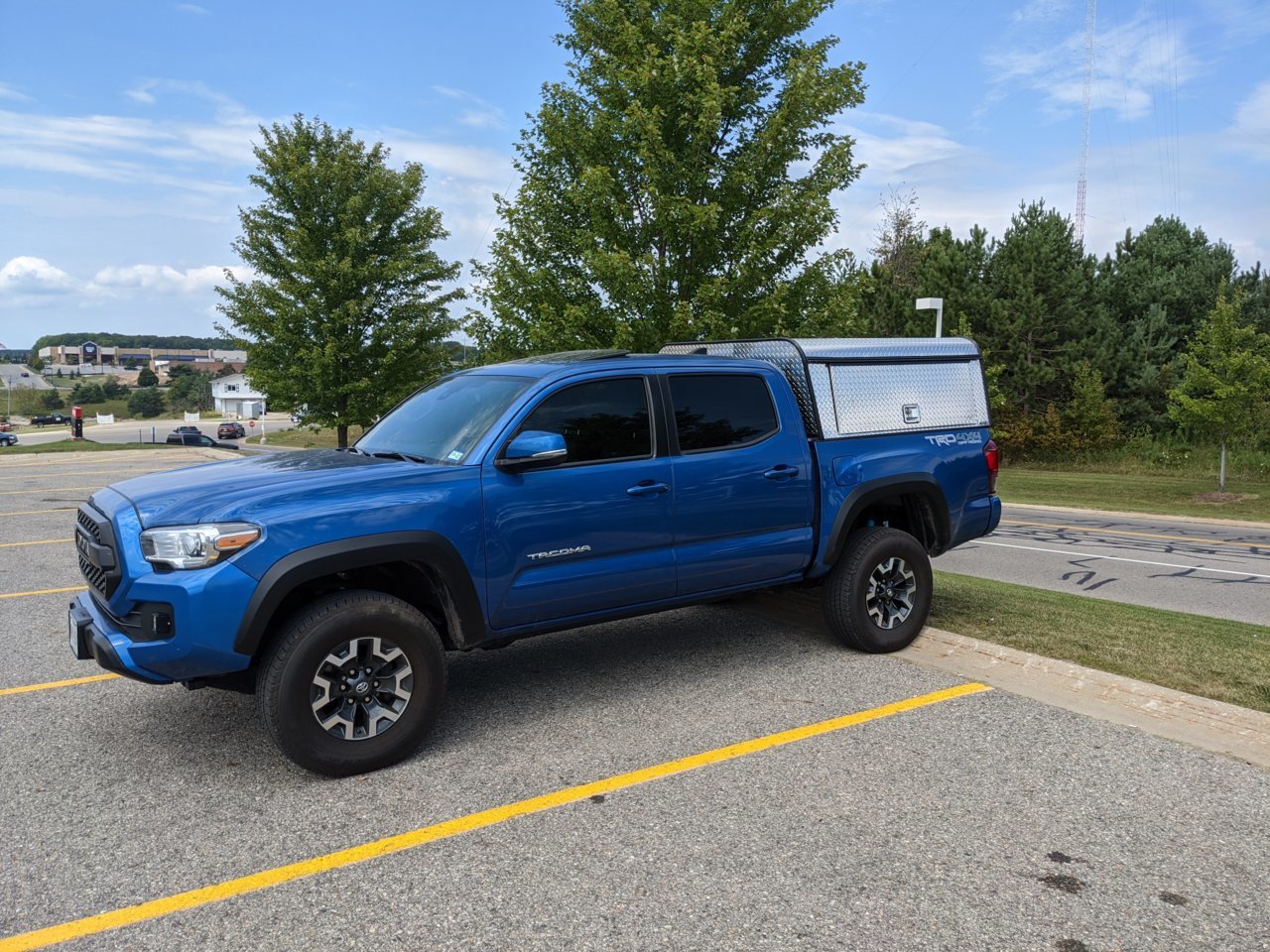

    Are you planning on lifting the front? If so that should level it out because it looks a little rear high right now. You might get a little settle, but I wouldn't expect much more than a 1/4" or so with that leaf.

    Not any time in the immediate future at some point I'll grab a better picture since that one makes it look more exaggerated, but I like a little bit of rake on pickup trucks...maybe I'm crazy. It drives great though no more bouncing off of the bump stops. I'm also looking forward to seeing how it sits with my bikes + camping crap.

    I'm with you on appreciating a little rake. These ass draggers that I see all the time with the lifted fronts and lowered rears make me cringe.

    Yep, the measurement in post #23 is from the bumpstop to the frame, which as I'm typing I realize would be impacted by the additional leaf by ~.25" so in reality it picked up 2 inches. Unfortunately I never had a measurement stock without the weight in the bed.

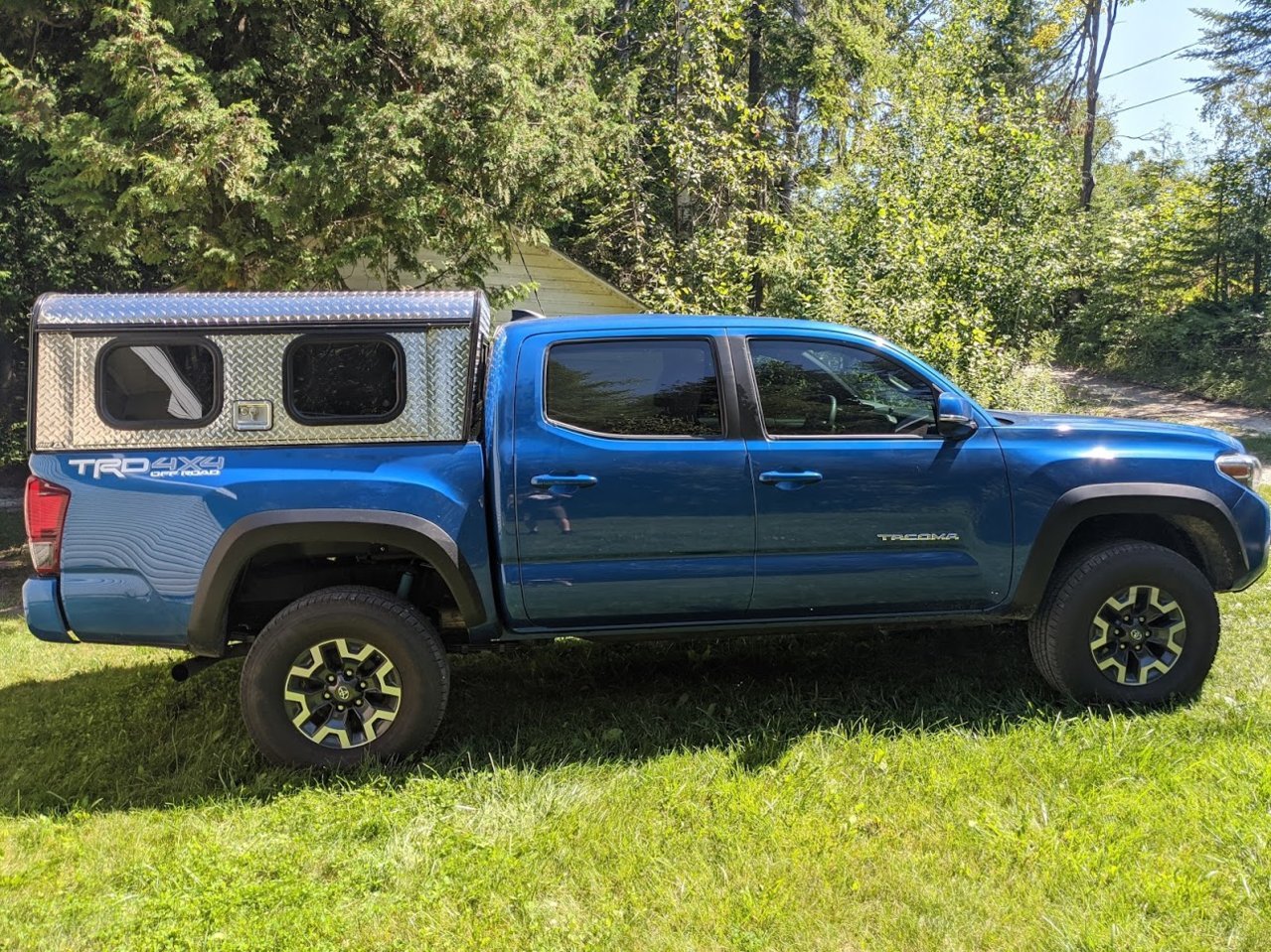

    Better picture of it being more or less level with a small rake

    Nice I prefer a nice rake than to be level! HAHAHA
