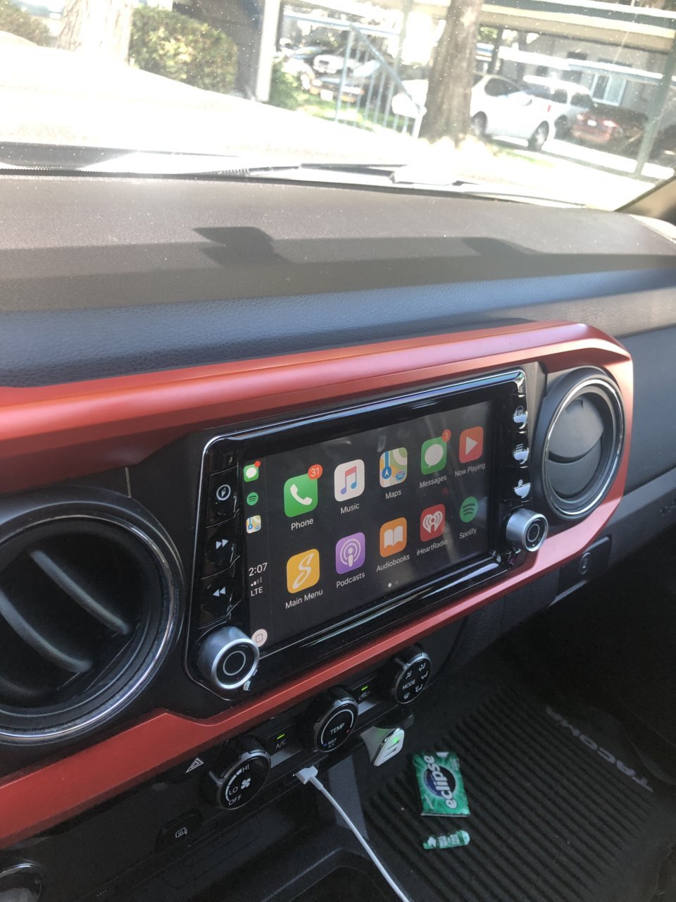

    I have put in Racesport gen3 leds I'm the process of doing a custom audio overhaul which will include Hybrid audio unity 6x9 mid bass, unity 3 inch mid driver in the dash and fiberglassing tweets in pilar soundeading all the doors, floors, and headliner and I will be using a helix processor to retain the factory radio and as far as subs I might make custom brackets to move rear seat foward a few inches to get a full size sub in there or I might just go with a pair of jl tw5 or tw3 and it will all be powered by jl audio HD amps or I might try out the new hybrid amps

    Wow, that looks really good. How is this Stinger treating you? I like the way they look in our 3rd gen. I’m just not quite sold on the brand. Does everything work properly as far as oem function? How is the quality and very importantly, how is the operating system? I am looking for a smooth and user friendly operating system.
    So I’ve been messing with this radio since before it came out for resale(I got a demo unit) and I love it. I’ve done a few installs and it’s smooth the operating system is great super easy to navigate. It has built in steering wheel controls so I did not have to buy a separate adapter, it also has optical out which was the main reason I got it. Also has four camera inputs(rear,front,left turn, right,turn) hdmi input,optional built in nav and if your fab savy you can flush mount it like I did and it looks dam near factory.
    Also stinger is a great brand is owned by aamp of America they are huge in the 12v world. I know one of the head designers of this radio and he is a huge audiophile and actually cares about what he puts out in the market he has been a iasca(sounds quality competition) judge for years.
