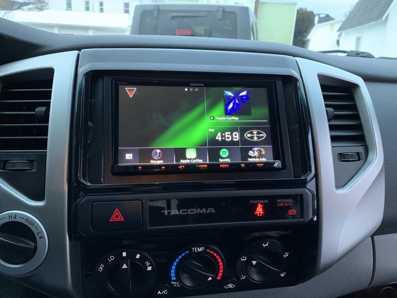

    TRD wheels, Kenwood DMX906S HU, Kenwood front/rear speakers, Window tints, weather tech floor mats, aftermarket HU in factory dash skit
    Kenwood DMX906s
    Awesome interface, Wireless CarPlay with firmware update, adding the iDatalink Maestro for on screen gauges is the cherry on top!! I recently installed new Kenwood speakers for the front and rear, and the build in Amp on the DMX906s really makes them sound amazing!
    The only thing it doesn’t have is HDMI
    Other than that, I’m not sure there’s a better aftermarket head unit on the market
    tacoman45 and grrck like this.

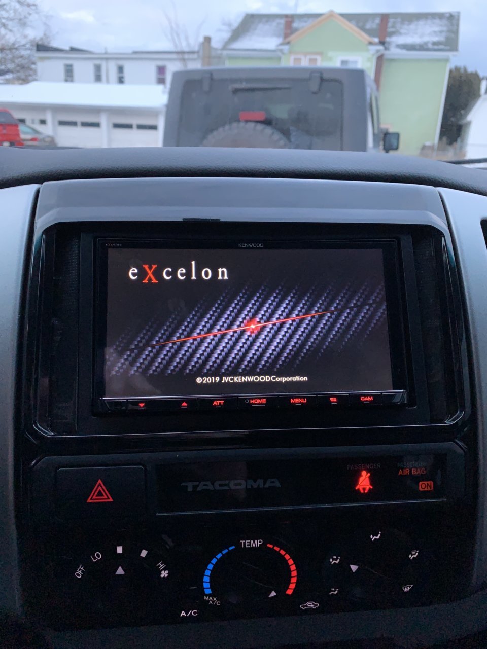

    I integrated mine into the factory dash, no kit needed. Looks great, didn’t take much effort and looks like factory
  19. Jan 19, 2020 at 4:24 PM

    2008 Silver TRD Sport DC
    Looks sharp!!
