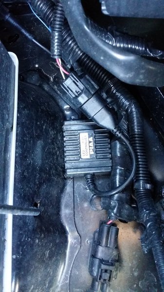

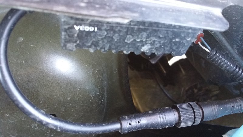

    Never delt with the 2stroke led but heres the piaa. Controllers were small, kit was easy and includes built in cooling fans in a package small enough it does fit without bending anything. 20161010_100655.jpgPass side installed. Not much clearance but it did drop in.
    Pass side ballast i 3m double sided taped under the radiator support

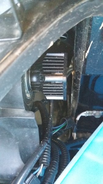

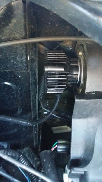

    Drivers side is cozy also
    And drivers side ballast just got taped down to an open spot. Will make a couple brackets to hold ballasts when i upgrade to hid and move these to high beams
