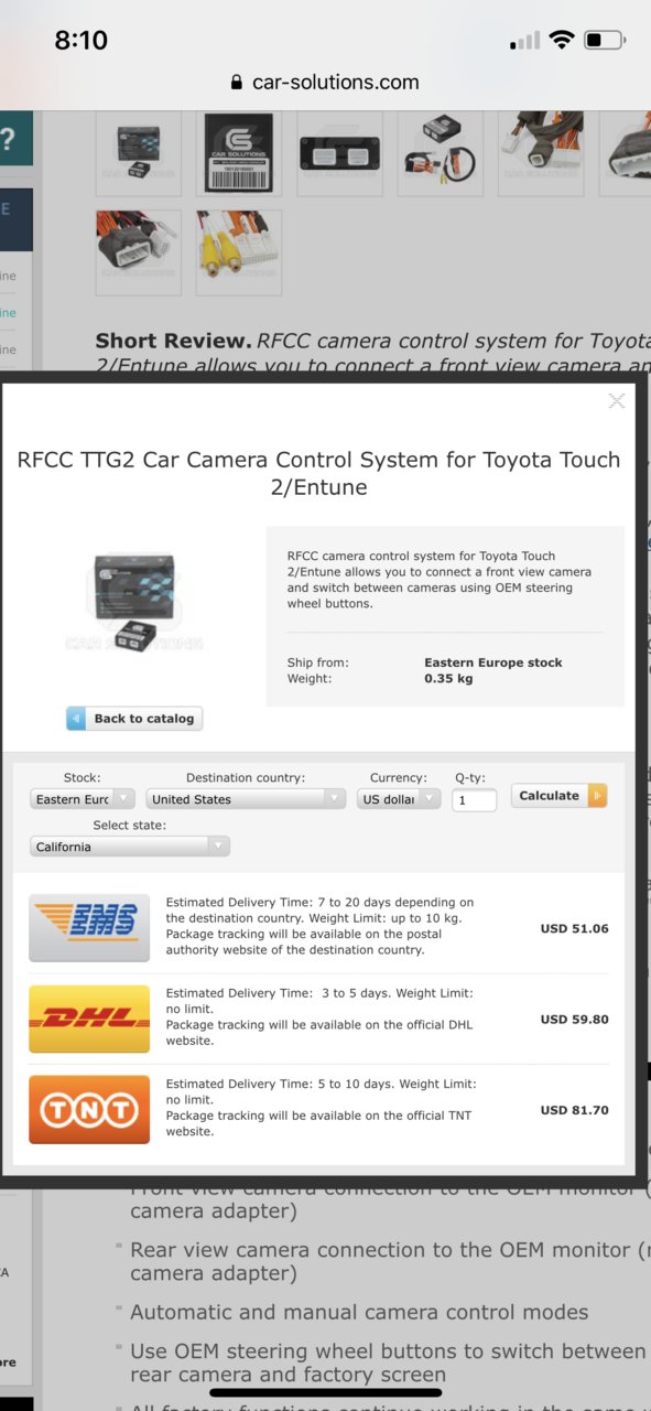

    You got in in 4 days shipped from Europe? Here’s the shipping quote it gave me.

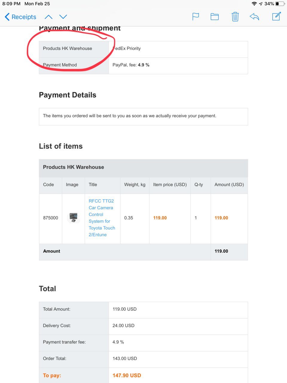

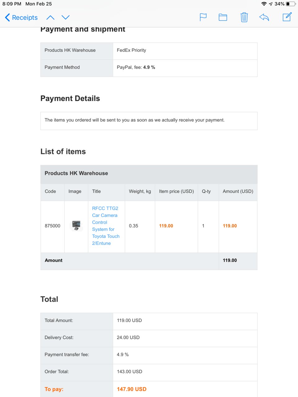

    I just checked as well and I’m seeing the same shipping options. Looks like they are not using FedEx at present for some reason. Like my invoice shows, I only paid $24 for 3 day air, and the product was delivered in 4 days from ordering. Perhaps contact them and inquire if they can ship FedEx... they responded to my questions within a day on two separate occasions.
    Edit: it appears the stock location may make the shipping difference... my unit came from HK stock, and at present they are shipping from Eastern Europe. Check back later or call/email and see if you can’t get the product shipped from HK stock instead.

    Yours was shipped from HK:

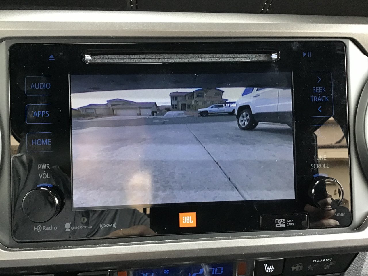

    I just did the Car Solutions install over the weekend and am very impressed with it; install was pretty straightforward. This is the camera I used:
    https://www.amazon.com/gp/product/B018800TR2/ref=oh_aui_search_asin_title?ie=UTF8&psc=1
    Didn't have to cut any wires to flip the image or anything. It doesn't have the lines like a backup camera does, which is how I wanted it. Image quality is excellent.

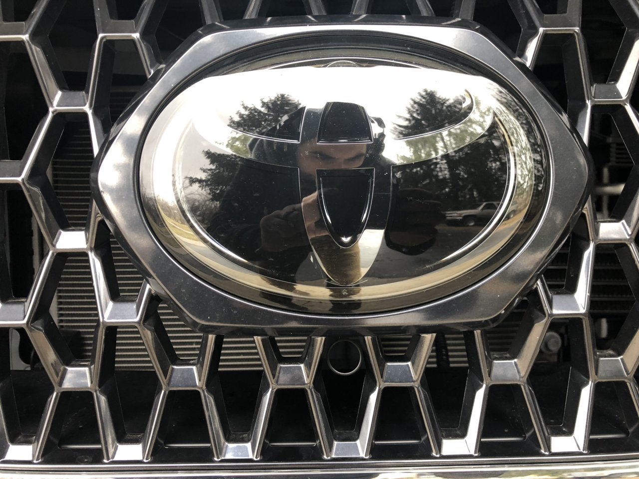

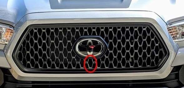

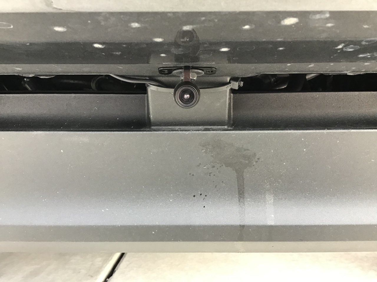

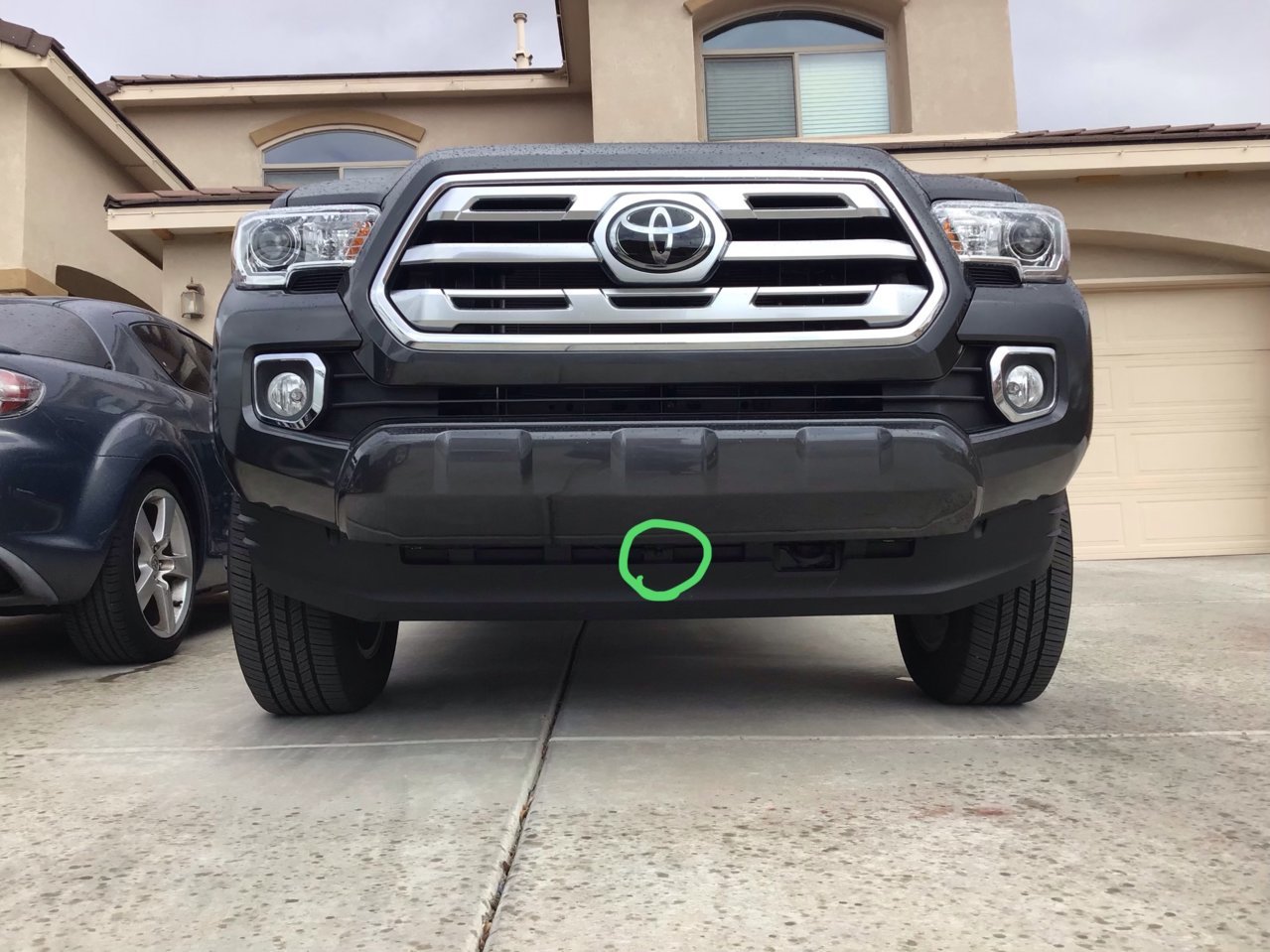

    I haven't taken a pic since installing it, but I did take a pic of where I mounted the camera mount one day last week when I had the grill off. Right below the TSS:

    Gotcha, that camera should work good for you. I removed the pic and added it a different way, so it should show up now. I just used some superglue to hold the mount to the grille, and then once that was dried I used epoxy to reinforce it so it's solid.

    That's exactly what I am looking for. Right in that same spot
