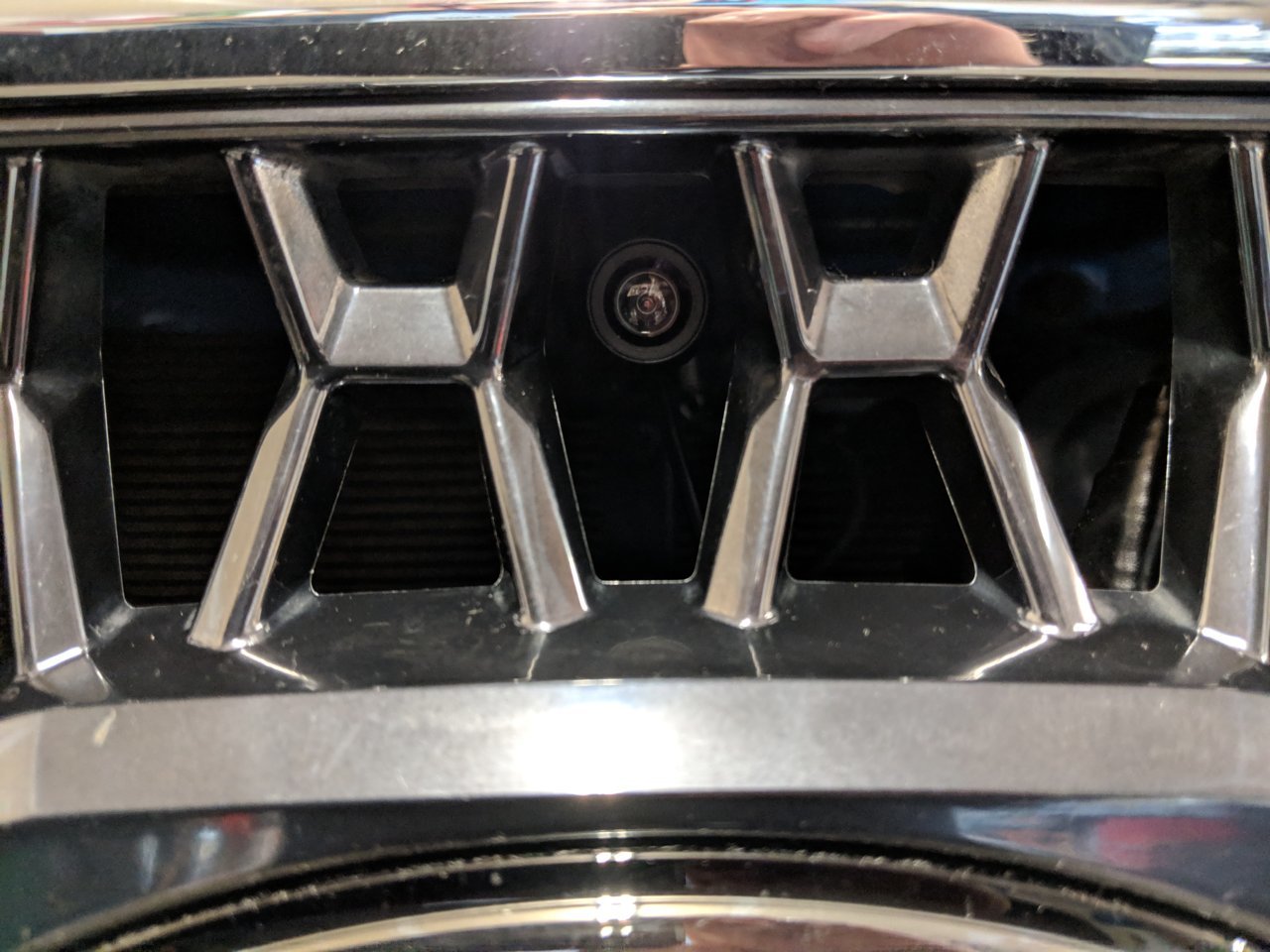

    Mounted my camera, waiting on the integration kit....

    Is that over the Toyota emblem? How is your camera mounted?

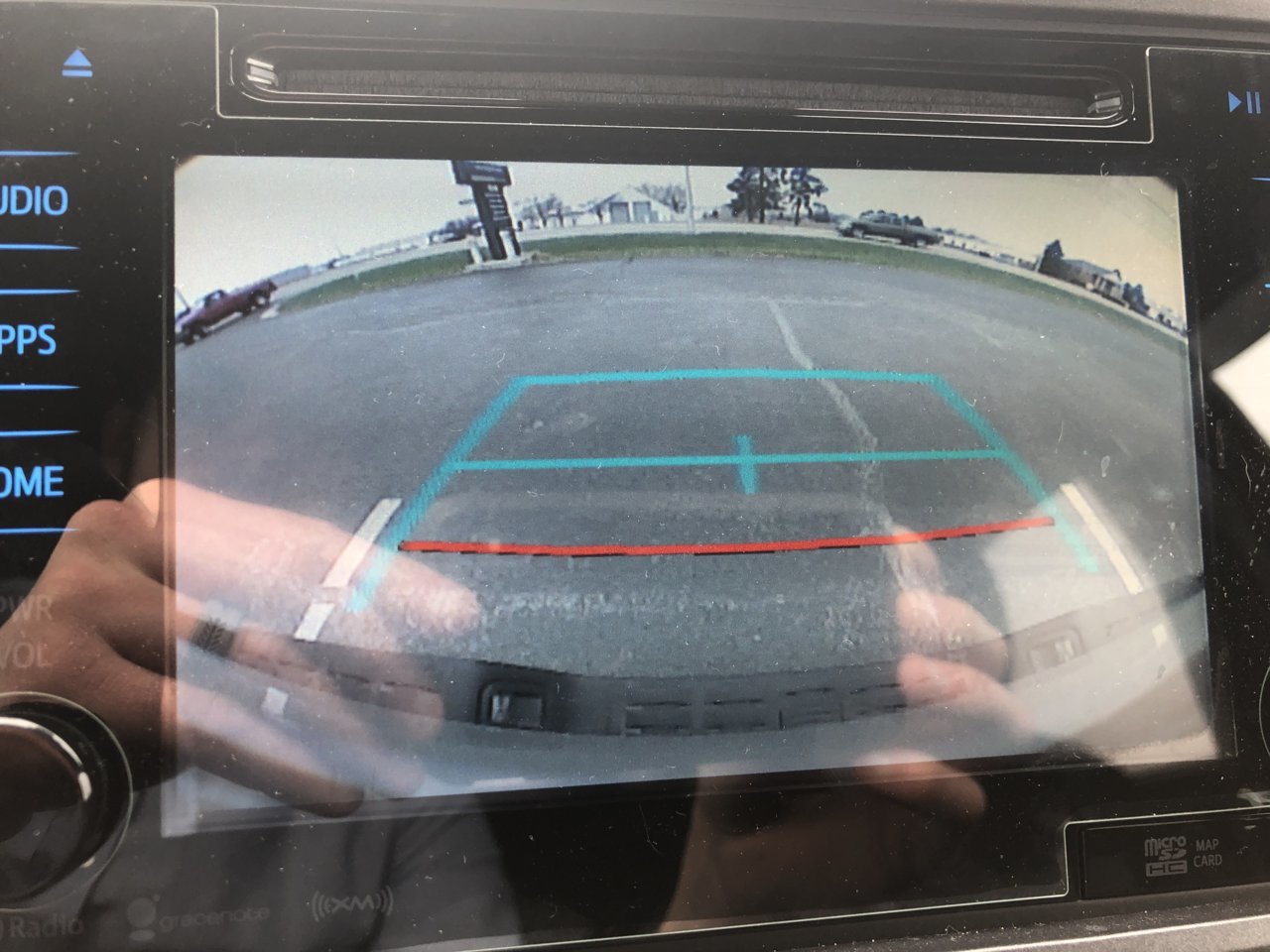

    I got my RFCC TTG2 installed. I put the cam on the center bolt under the bumper. The view is really good. There's only one problem. The video is reversed. Damn! I thought I had it correct before I installed it. Oh well. I had dressed the wiring up with sticky backs and encased the connections at the camera with heat shrink and rtv. Now I've gotta go back in and swap the video around. I think, while I'm in there, I'm gonna enable the guidelines. It's just a matter of disconnecting one of the wires and reconnecting the other wire.
    Edit: I went back in and reversed the video and enabled the guide lines. I also made a cheat sheet for the guideline distances. Yours might not be the same as mine though. For those on the fence about installing a front camera on you 3rd Gen Tacoma, it's a no brainer. Do it. I really like how the front camera comes on automatically when I'm going slow in drive. I don't quite have it figured out yet but I really like the feature. I want to test the front camera out in different places. I'm not sure I want to leave it under the bumper. I like the idea of it being in the grill if it turns out to be a good view.

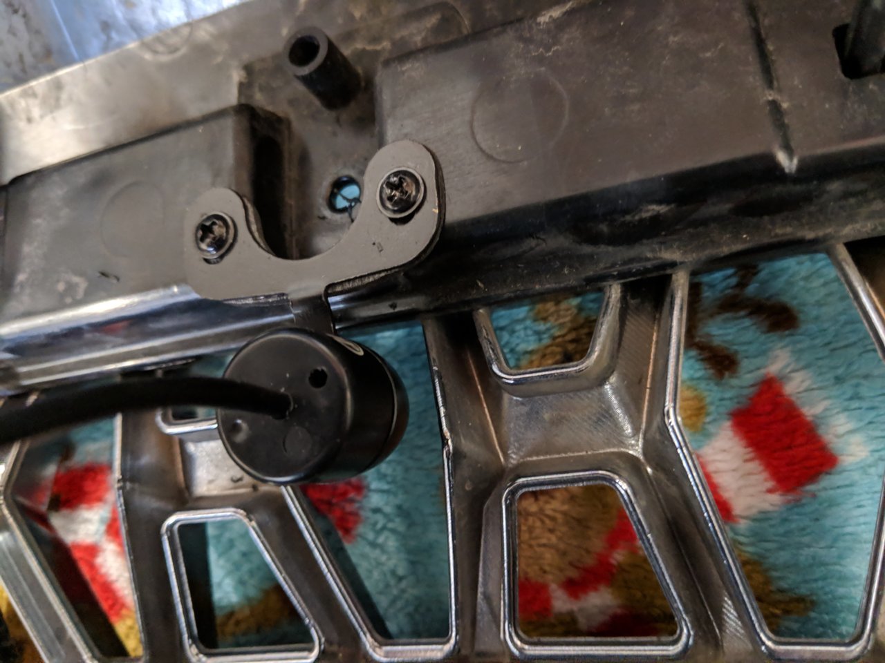

    How did you mount it? Did you screw it in? I want mine to be removable if possible, so no epoxy or glue.
    porterx likes this.

    Screwed it in.

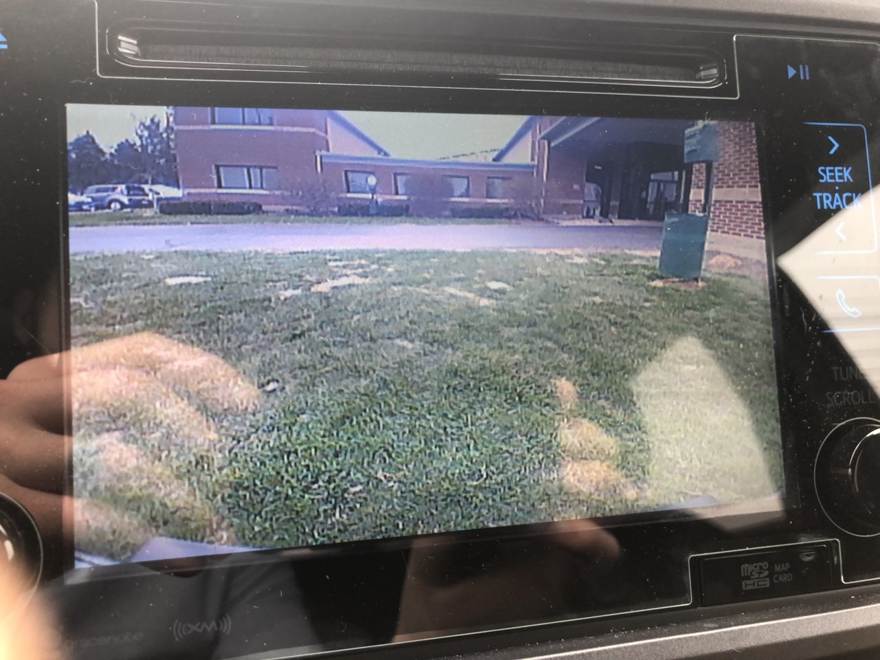

    I dont have it hooked up, so maybe the view sucks....I wanted to use the nikita cam but could not really get it to work with this grill and could care less about buying a pro grill. I like the size of the openings in this grill for towing.
    here are the pics:
    supralee, TheSharksDen and porterx like this.

    Yeah, I'd be interested in the view as well. If it's a good view, that'd be great since it'd be easier to work on being there as opposed to under the bumper.

    Awesome, thanks for sharing. I have the same camera too. Let us know how you like the view!
