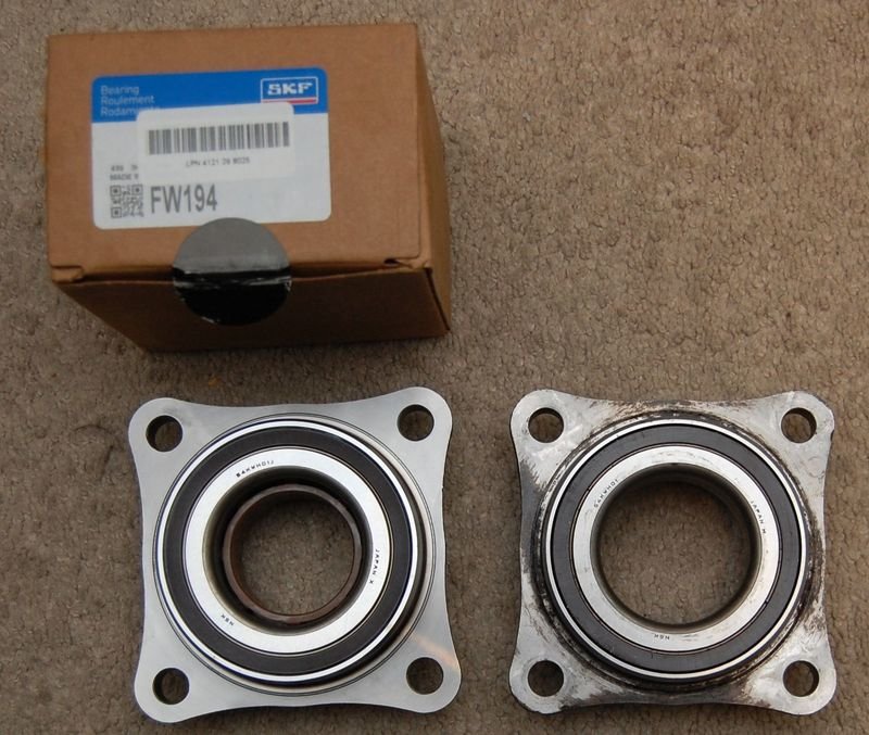

    After ordering a SKF FW194, I contacted SKF to see what kind of grease they used in this bearing. I became a little concerned when they responded that this bearing was from an OEM and they did not know what kind of grease was used. I received the bearing today and it appears to be the same bearing sold by Toyota. Both the Toyota and the FW194 are NSK 54KWH01 bearings.

    I looked around on the forum & decided to go with Timken front bearings. The Koyo were about 30% more than Timken on Auto Parts Warehouse & too pricey.
    When the bearings came I opened the package to check them out. The boxes said Timken BM500007. Looked at the bearing assembly & the bearings are Koyo! Same bearings for 30% discount! Yeah baby!
