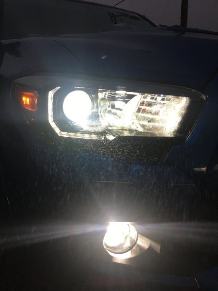

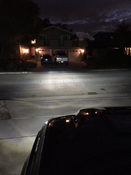

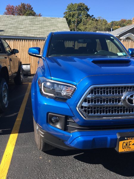

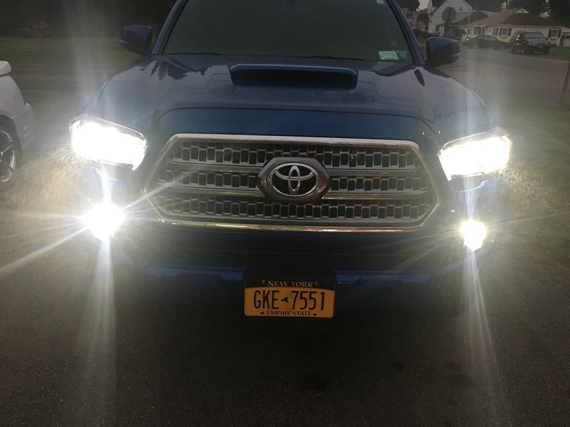

    This is my truck.
    Osram CBI bulbs (5500k) in Lexus RX350 projectors
    Factory LED DTRL
    Morimoto LED Tacoma fog assemblies
    I captured the glare intentionally to show color, everything here has a cutoff and no glare.

    Well if OP wants matching this is probably the closest setup I've ever seen.
    Do you know what temp your fogs are? They look like low 5k (in the first pics)

    I'm surprised the HID projector matches the LED fogs so well. Same temp sure but different housings and light sources usually throws them off.
    Looks really sharp and less blue than I would've though.

    Does the DRL have a bulb you can change out or no? If it does I would replace it with a brighter one but I don't think it does

    IMG_4011.jpg No, they are much brighter when the headlights are off. They dim when the headlights are on.
    When you are in DTRL mode, they are very bright. Stands out even in the sun
