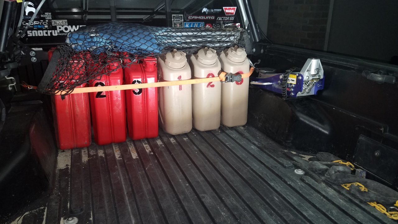

  11. Apr 12, 2019 at 2:46 PM
    jbrandt
    jbrandt Made you look
    Feb 12, 2011
    #51038
    17,612
    Justin
    El Dorado, CA (NOT El Dorado Hills)
    '04 TRD Tacoma 4x4 DC
    Kings, J59's Total Chaos UCAs Custom skids Sticker mod
    alexplb and SR-71A like this.

    Someone on here bought the arb ome version not too long ago

    Race truck understandable. Quick tire changes

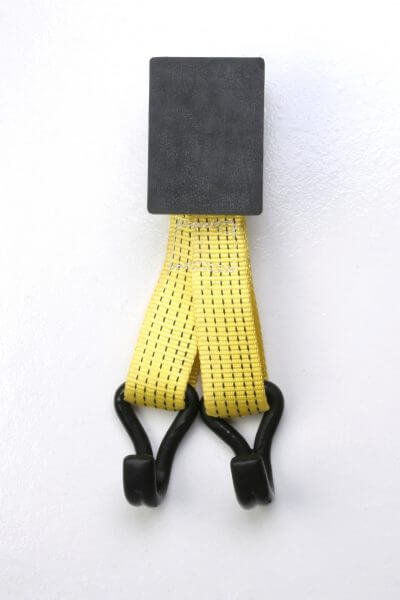

    https://hi-lift.com/accessories/lift-mate/
    While not always the perfect solution this is actually very versatile. Part of my off road kit along with some cribbing and a cheap scissor jack to use as mobile light weight jack stands.

    The lift mate is one of the best jack tools around - I've been toting a high lift in various outfits for nearly 40 years. This has made it fit whole variety of wheels and tires even when the one I used was "homemade" out of chain and old hydraulic hose for a cover!

    The Lift Mate is extremely handy but not much use for changing tires. For that its a bottle jack + 4x4 cribbing for me normally. I've used a ratchet strap to compress suspension but I don't trust doing this any more than the Hi-Lift itself, so it would be a last resort for a tire change personally.

    Agreed that is why my quote has “not perfect” in quotes. I do it anyway of course, first I do the lift with the jack mate, then I use the cribbing and scissor jack as my jack stand. It is a light weight system, quick and even the cheap OEM holds the truck in place fine.

    They're pretty quick with the floor jacks, too.
    You can still use the lift mate thing to change tires. Lift it up, load up the axle with cribbing or something, then release the jack and change the wheel/tire.
    Bottle jacks are only useful if you can get them under the vehicle. Useless if you're bogged in frame deep mud.
