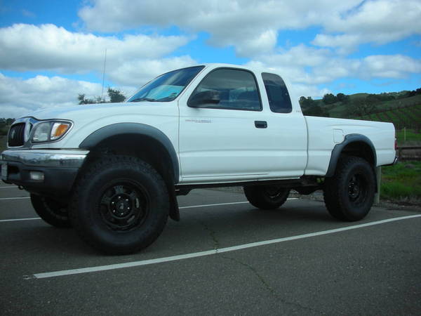

    Mine sat pretty, almost perfectly level, it was awesome. ive done alot of off road and wear and tear tho on it, so the front to me looks like its saggin just a tad, like maybe half inch at the most. but yea, it sits nice and level.
    im running 285/75s with it too no problem. i just want the front to be higher, and i want the front to be higher than the rear.
    check it out

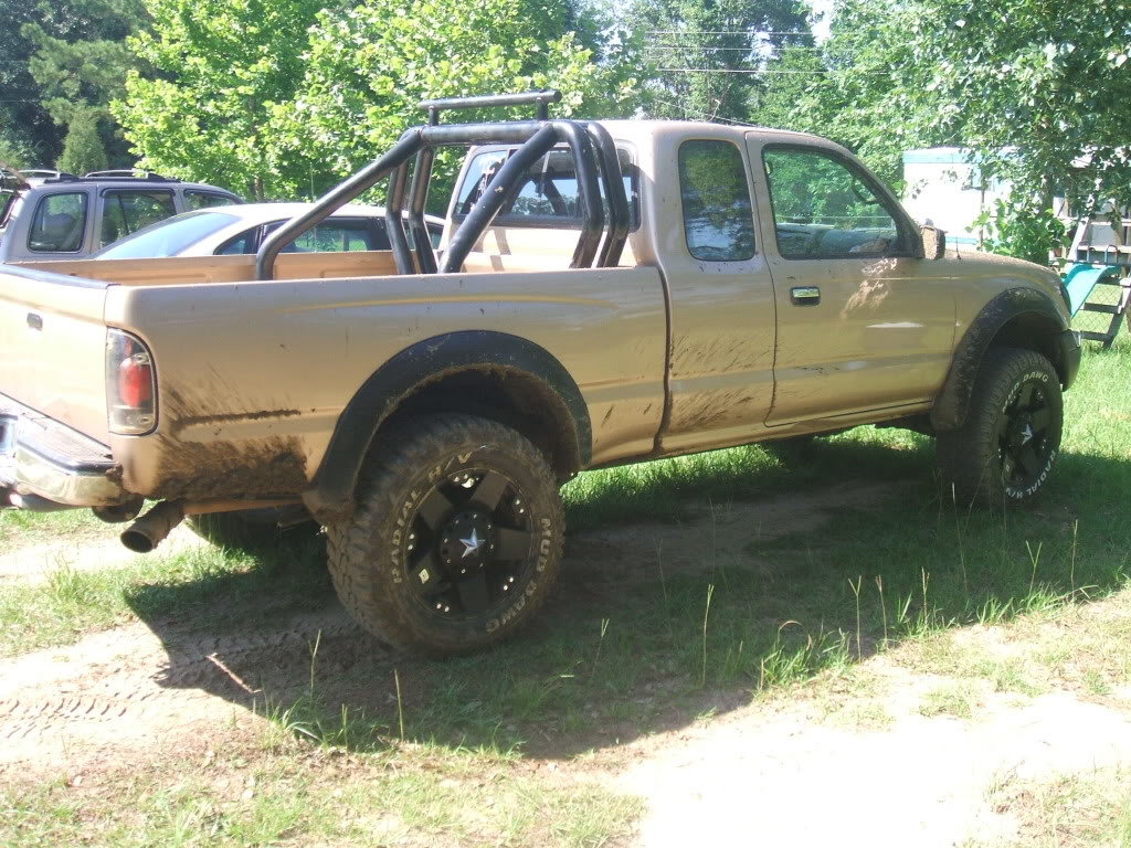

    i have a spacer lift and if your just wanting to clear larger tires and the cheap way out then spacers would work.. the ride is rough.. and its not worth it.. if you want a true 3 inches then go with a coil over lift so even if it does sag in the front a little you can always adjust it up a few more clicks to level it back out.. mine is starting to sag again and i need new leafs in the rear truck008_0e8e4bd89686578d351ecccce31f78c1eded49ec.jpg
