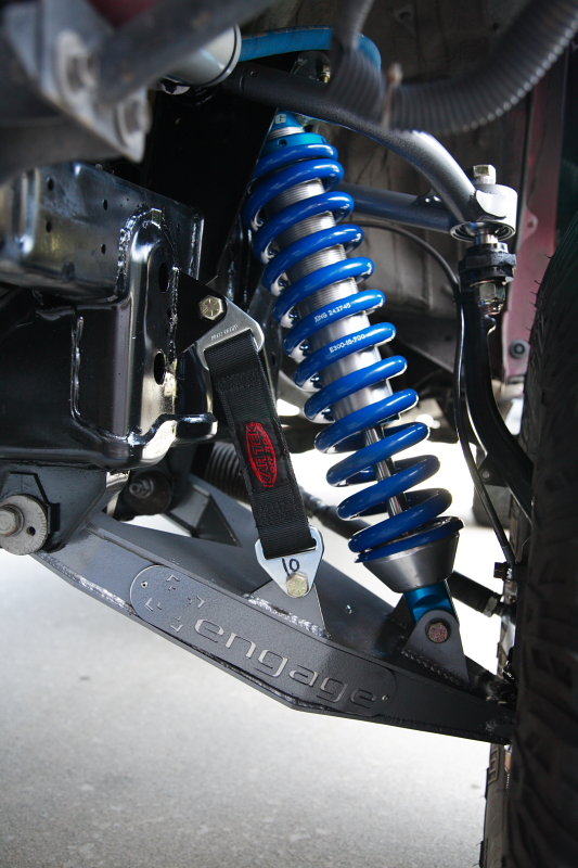

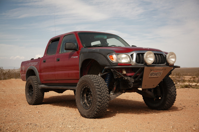

    for a pre 05, im running the Engage kit...
    16" of travel and based on an actual tacoma race truck (1482)...
    so far, i have tested it out in the Mojave on 3 trips from stateline to barstow upwards of 55mph through sandy washes, rocky hills, and hucking it on whoops...
    we will be back out in Lucerne weekend of 4/25 if you would want to see the kit up close and in action...
    complete front end including King coilovers valved specifically for the kit, is $3,200...

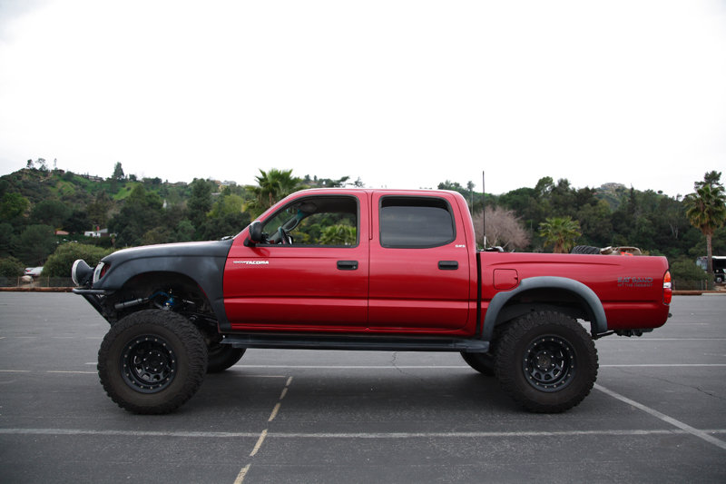

    word... Engage makes a bolt on kit for the 05+ tacomas too...

    Damn thats sexy! Mike was giving me info about the kit and the guys the run engage very informative good service.
