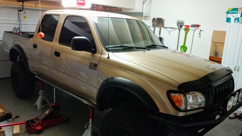

    Really REALLY liking the angle of this setup! 7b0b8009cac157a2f3fefb01ae4591d0.jpg

    i was thinking at least 3-4" off, the legs are quite long. Ill use the floor jacks as well

    those are nice, I do want to be able to use as a step as well, just not my whole foot

    Yeah, they are just under 12".

    That's exactly what I'm trying to do. Like em at w a good amount of angle and as close as to the body I can get w/out interfering with the cab body

    Just holding them up with jack stands, ill be taking about 4.5" off leg length

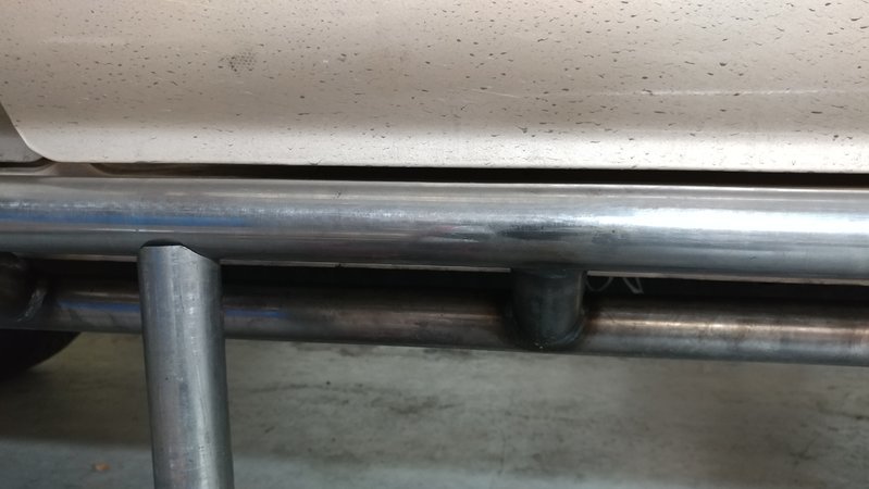

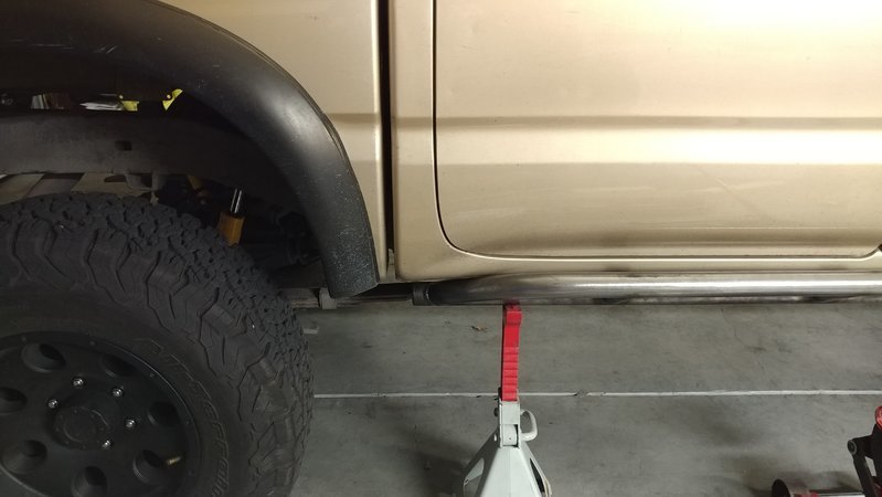

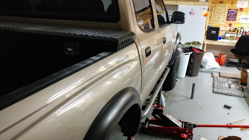

    Ha! Just realized we have the same name. Anyways, I mocked mine up and it seems like I'll be taking around 6" off. Not 100% sure though. Here's some pics. A little tight to body so might cut 5".

    Looks good there! Wanted to prep and paint today but it was a bit cold and rainy. Hoping to get them installed later this week

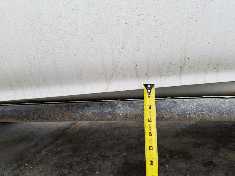

    Yea, weather plays a big factor when painting. Since we're mounting them close to the body, it's def a good idea to paint before installed on the truck. It'd be a pain to paint once they're on the truck. Might mount them off center. Liking that way (see pic) also how much clearance when u open the doors? Mines at .5" lol. Super tight! Again gonna make a few adjustments and gap everything accordingly.

    .5" is close! Not sure of angle yet, but you're probably not far off

    Yes it is :) might drop it some more

    I recommend more clearance 0.75"-1"
    Mud, ice, snow, etc. can accumulate on the sliders impeding opening or closing the doors.
    ALSO, make sure you have enough clearance between the sliders and the rocker panels to allow for body & frame flexing. Otherwise, they will bang together until they self 'clearance' - that's what happened when we put them on my brothers Taco.
    Good luck!

    Thx for the advice and good points. I will do an inch from doors and take body roll into consideration.

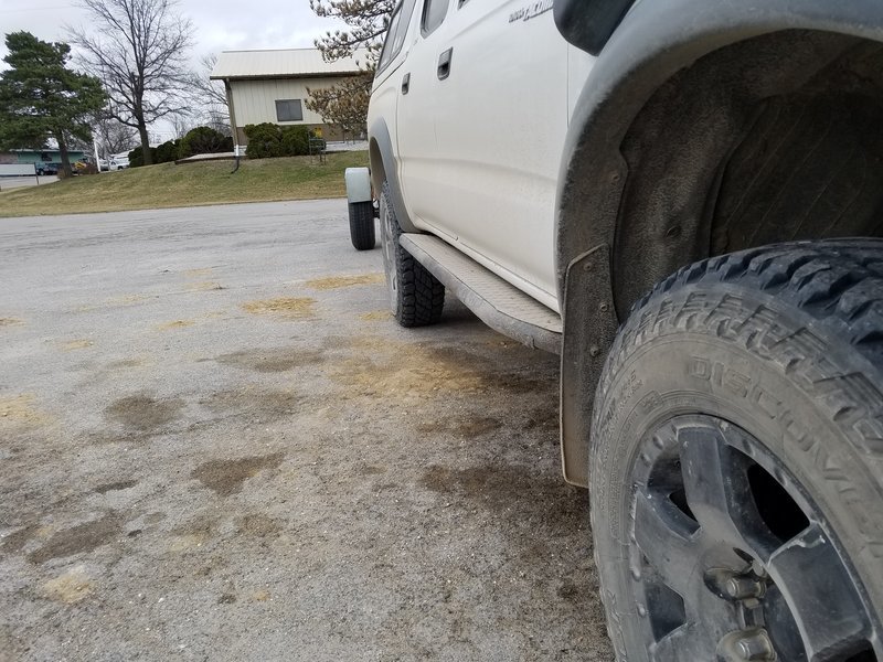

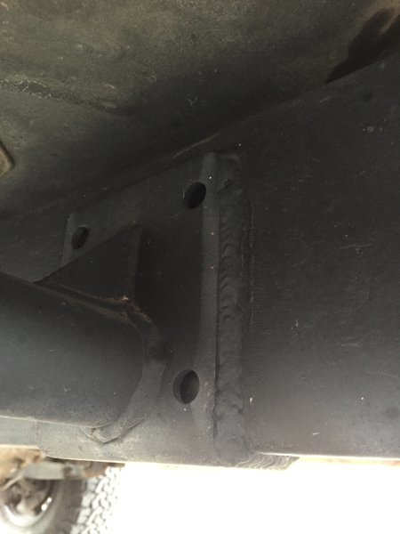

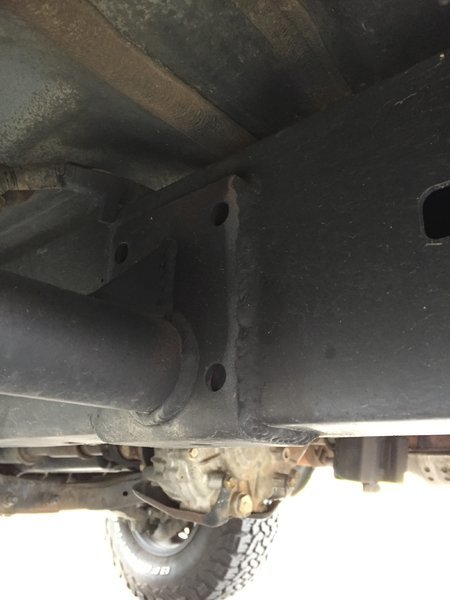

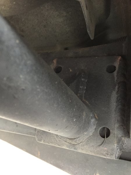

    I finally got some pictures of how mine are welded to the frame. But they're not the TG sliders you guys purchased. They're the ones I showed you in Post 3. Still perfectly happy with them.

    Looks good!! Thx for posting. All I know is, it's gonna be A LOT of welding for my poor brother. Hahaha
