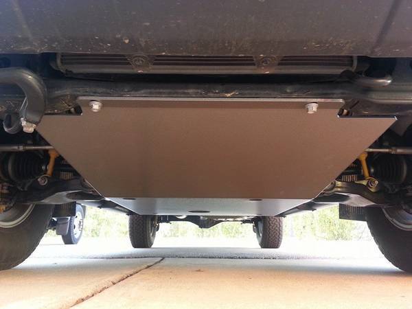

    Here's mine lol 2$ swap meet!!!

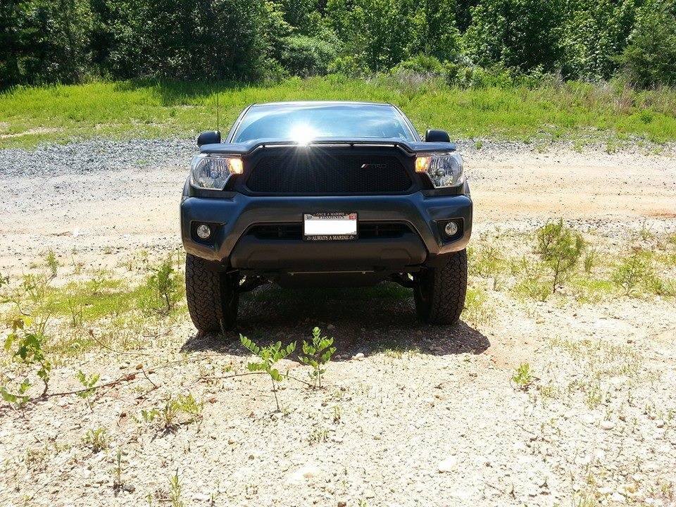

    Here is my Matt123 front skid. It's not a hard core bash plate, but does do well in the snow...
