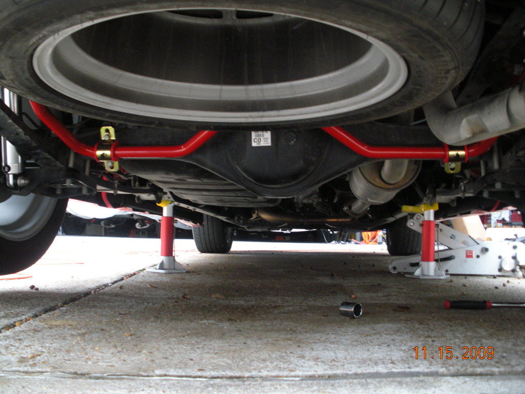

    A few
    Pics of bar . Try holding up or down . Bent up, might block diff plug .Think bent should go down . :playball:

    This is an aftermarket bar from XII.

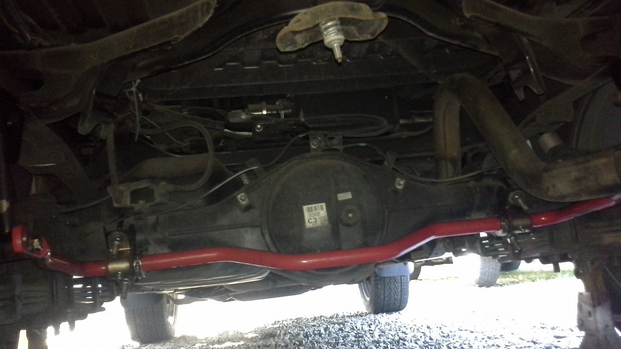

    I got VII bar also on prerunner with TR drop kit . mines mounts like this .20160402_164610.jpg

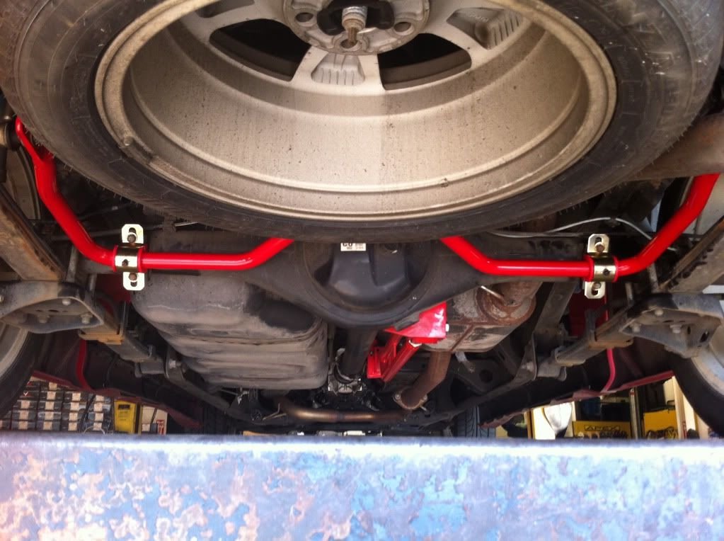

    Thanks everyone. I got a hold of the manufacturer, and he said the bend should point down, like the second picture. I appreciate all the replies.

    I am not challenging the manufacturer on installation, but I went back and looked at several x-runners and they were all mounted with bend pointing up. The one I have was in the very first batch made, so I do not know if it was an early release or if the sway bar fits better inverted on dropped trucks.

    malibu
