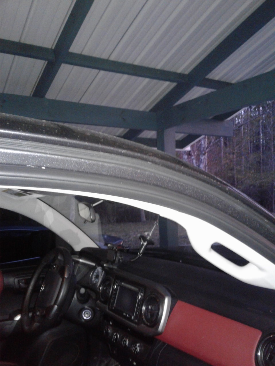

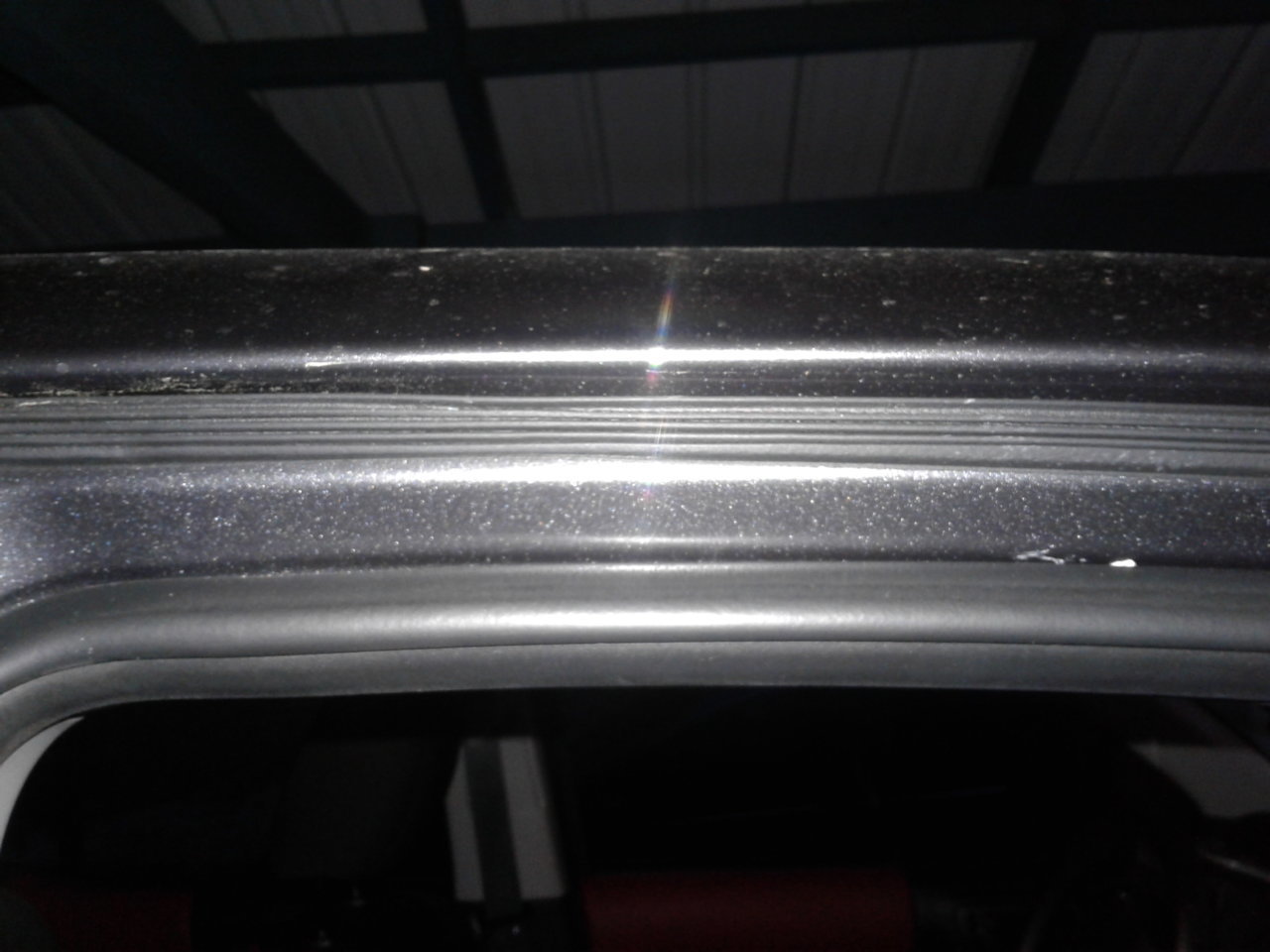

    I had the same issue with my 2016, along the top of the doors where the door weather stripping is, what I've done is added another layer to it. But I applied it to the truck side and not the door. I put right above the weather stripping that is already there. It cost about 10.00 at Home Depot. All the whistling has stopped....20200211_182009.jpg
