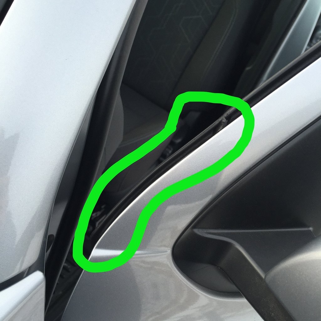

    So... went to see about the supposed fix for this at my dealership after a master tech had stopped by. The one i mentioned earlier in this post. One of the shop managers took me out to my truck and showed me exactly what they did. Theyve only done it on one truck so far, and i havent heard anything back about whether it fixed it completely, but apparently it fixed in the shop when they blew compressed air across the windshield trying to replicate the crosswind.
    5695cc90-3d5e-454b-8e43-13c2e755fcdb_zps_7a162ba95983e16ad74a2da2b2cc31351cb49c27.jpg
    So i was told they were able to successfully replicate the sound with the compressed air and someone sitting in the cab, and upon inspection, the portion of the door seal in the picture was flapping back in forth in conjunction with the sound occurring. So, the quick fix was to trim just that section down with a razor or scissors. The guy at the shop said that its not just 16's because the seals are the same with 2nd gens (which i can attest to the fact that i had the same sound out of my 13). I havent trimmed mine back, because he said he thinks theres going to a new door seal designed for the issue, and i havent heard it much as of lately. But thats what i have back to report.

    Thanks for the info Slip!

    my 2015 was making noise a few weeks ago while driving crosswind. came from the passenger side. might need to get ahold of a compressor and see if i can replicate it

    That's about the right area where it sounds like it's coming from on my truck. The mirror area. Maybe we're on to something.
