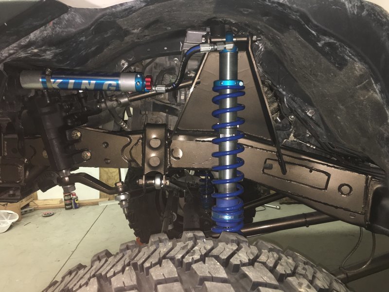

    Thanks for the support dudes! I've been slacking on the thread but I need to finish it. The speedometer is within 1 mile per hour with a 32 tooth gear. :wink:Mixed with 37s and 4.88s. Also I been hearing a lot on the steering linkage being too small for my application. If you haven't bought yet I would search around for maybe a bigger steering linkage. Mine made it through a winter in Utah and an abnormal amount of aggressive wheeling :bikewhoops: I ain't worried but I still wanna up the heim sizes and linkage when mine goes out. The build is totally worth it guys! The front axle is one beefy sucker. Lockers rip. 14" Kings are mans greatest invention. And 37s are sooo sick lol it will turn your truck into a wheeling machine! I'm always up for questions if you guys have any:thumbsup:

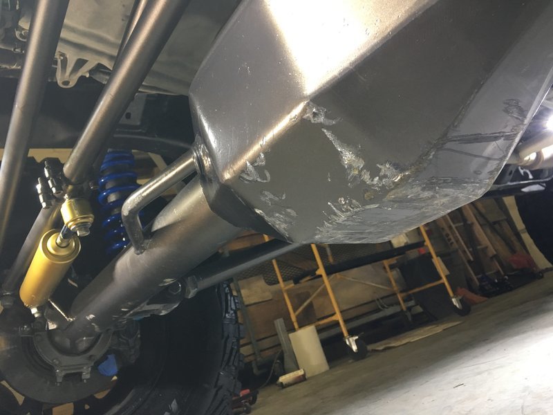

    Where'd you get the brake lines from slacker? :D

    Haha :fenforcer: shots fired lol. I went to Evco house of hose. They might have one in Hawaii? It was something like 56" long if you mount your little 90 brake line deal to the right of the drivers side bucket. With your truck having passenger side upper link I would run my brakes down that side on the link. Same setup just opposite side. :taco:
