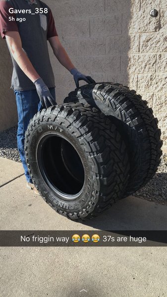

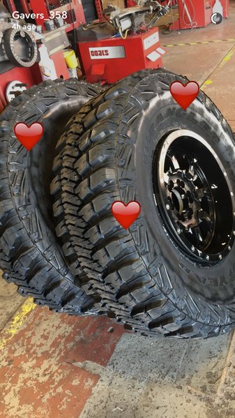

    Haha I see your getting wild with the like button lol I dig it! The tires are 37s. They are compared to a 295/70/17 in this pic. The rims are the same fuel kranks 17x9
    2,000 for 5 of the tires and 800 for 4 of the rims. (I've had the rims for a year now)

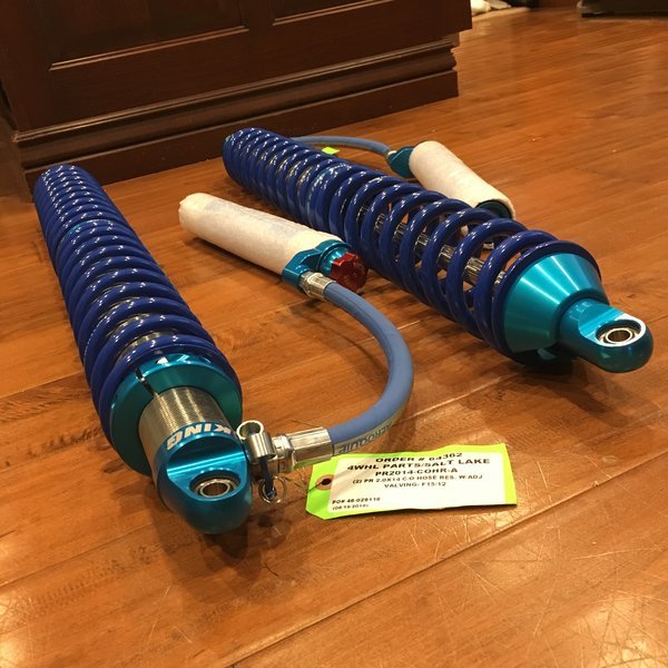

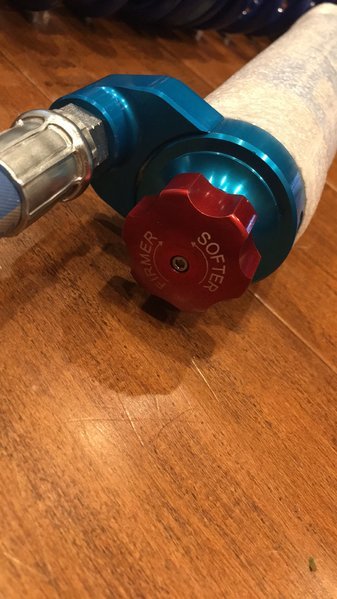

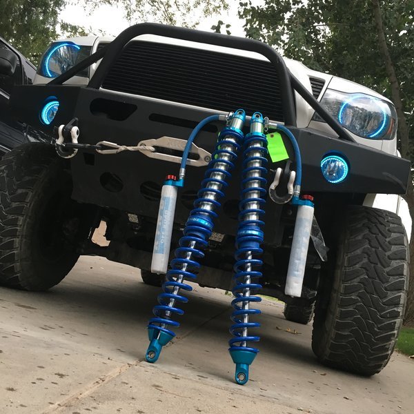

    So the coilovers are dual rate 14" kings with a 16" 250lb spring on top and 15" 350 lb spring on bottom with adjustable reservoirs. 24 clicks of freedom I believe about 1,000 from 4 wheel parts

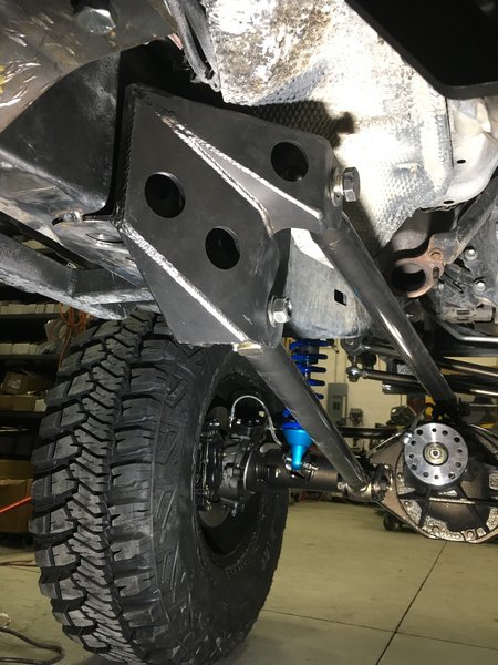

    Any More pictures of Upper/Lower Link mounts on Frame and axle?:popcorn:

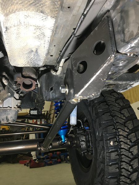

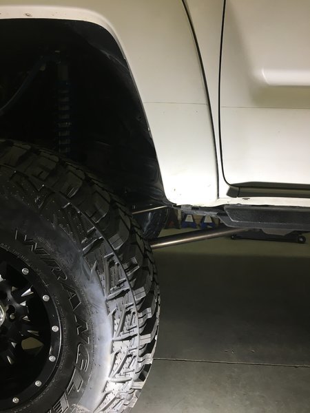

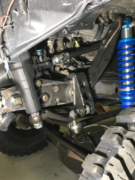

    YES! This is what I wanted to talk about!!! Need some help here haha So the directions, They have awesome some awesome guidance but Every truck is a little different. I followed them but had to extend the Johnny joints a whole 1" 3/4 barely getting the 37s to not scrape on the body. This is a picture of what they look like now fully collapsed and tacked forward an 1 3/4 from the directions.

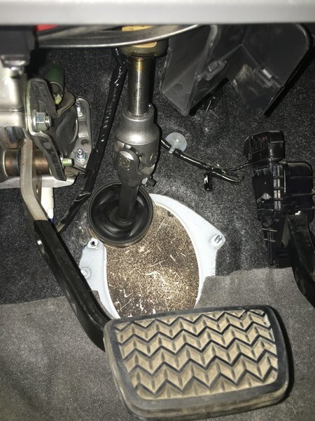

    The steering gets overlooked a little in the directions. I ended up making my own firewall plate and Offsetting the hole up higher to the side in order to use the steering shaft they provided.

    Oh Wow...Maybe some of the guys from the "Solid axle suspension" can chime in, I bought the same kit but I'm paying a shop to install...That's out of my league!! Have you contacted Jon from All-Pro with questions? He has been a great with helping me :thumbsup:
