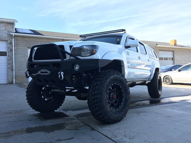

    amazing look what a stance god dam beautiful

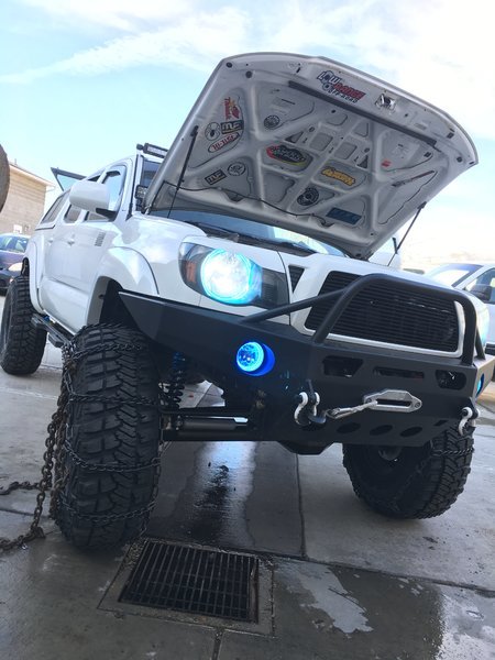

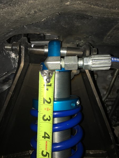

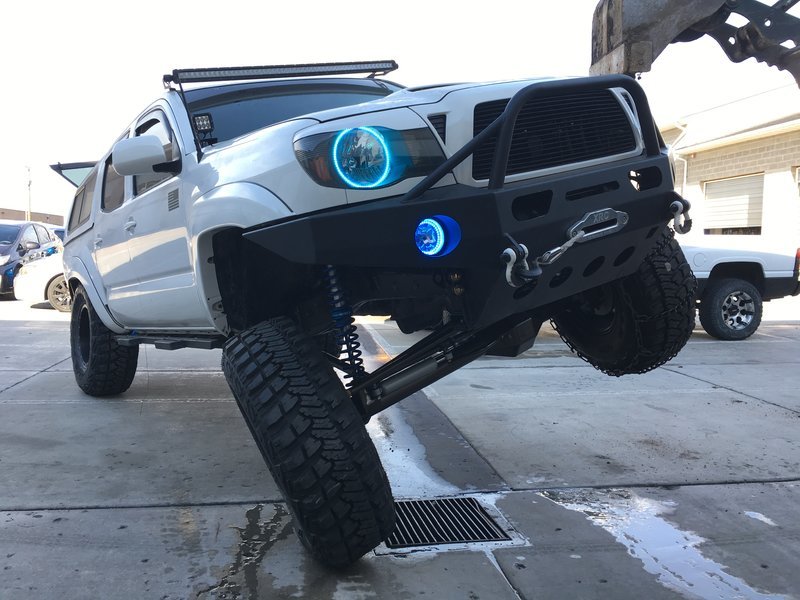

    That should be killer, I have heard those bamf hangers are very nice... I can't wait to see 14" under bed:bananadance: I'm going to run something like this, and mount the reservoir to the hoop:hattip:

    That looks so mean! I need to order some bump cans when I get money. When are you starting your build?

    Hey this stuff adds up way to fast...The Bumps will make a world of difference, well I pick up another pallet tomorrow and waiting on just a few more small stuff. No start date yet:angrygirl: Until then I will just keep drooling over yours...Hey when you have her on all fours can you measure overall truck height for me:) (Top of Cab) One small detail I overlooked was my GARAGE...:frusty: Guess I will be sleeping outside with it!

    Ya I can get some measurements for ya. Haha my frame height is almost 24 inches so from the top of the truck to the bottom of the frame + 24" should get you a height to see if you fit :fingerscrossed:

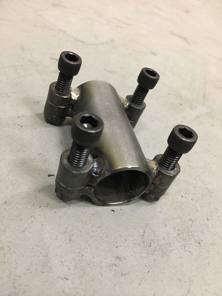

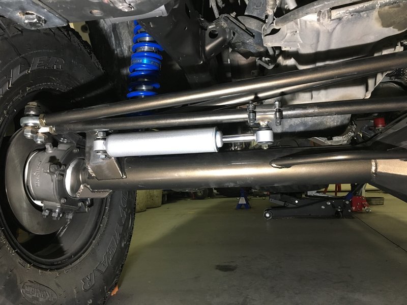

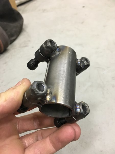

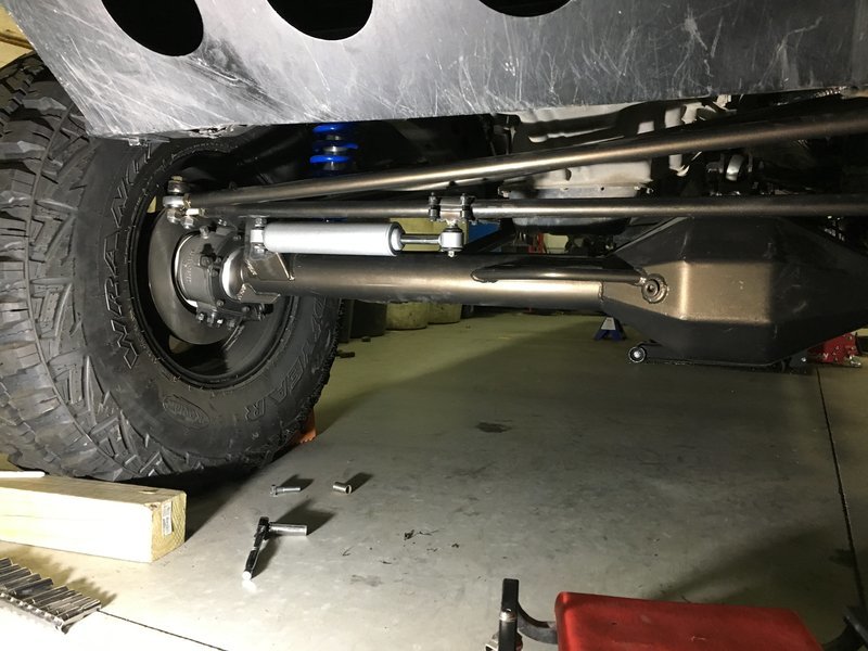

    And boom just like that we got ourselfs a steering stabilizer. My buddy fabbed the clamp piece with stover nuts and #6 Allen bolts. Then I made some tabs real quick and went to the panhard bracket.

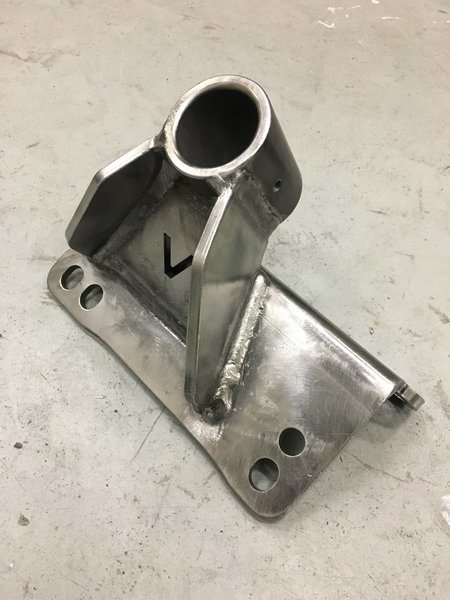

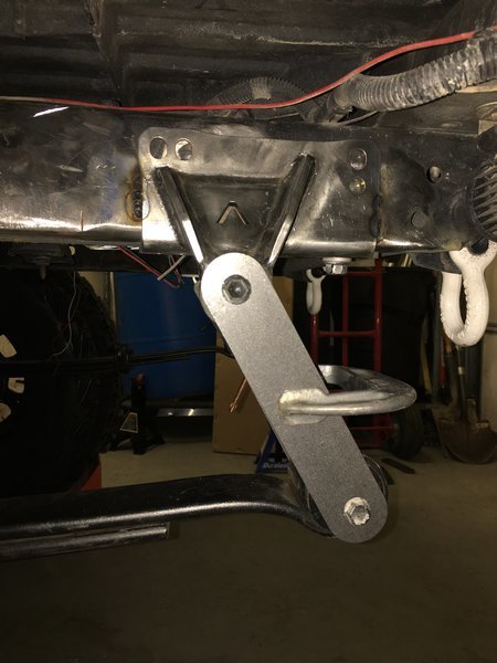

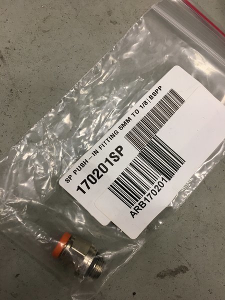

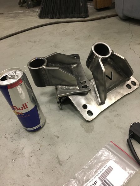

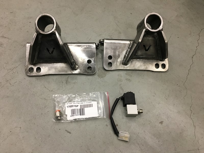

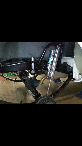

    Parts are coming in like wildfire now! I bought the ARB air solenoid from a local shop (my front Yukon zip locker didn't come with nothin) the solenoid didn't come with the air line adapter, bought that from north ridge 4x4. Then I am so stoked on the ARCHIVE GAURAGE shackle flipps!!! Again Kevin Bradley hooked it up if you don't follow that kid on Instagram you need to! Had me Talk with Eric down there for a while and we made A plan for my setup. These things are beefy! :militarypress: Tonight I will align the rear leafs with the new mounts and try to get er back on the ground. Then of course measure roof height for throttle231 :ohsnap:

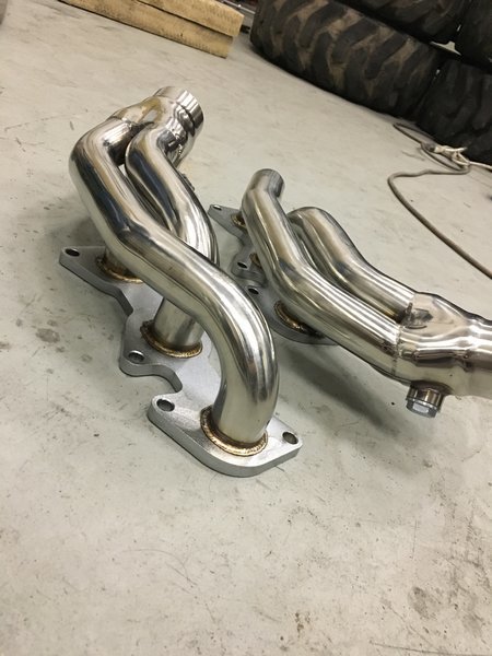

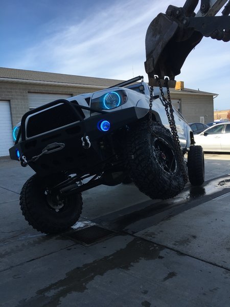

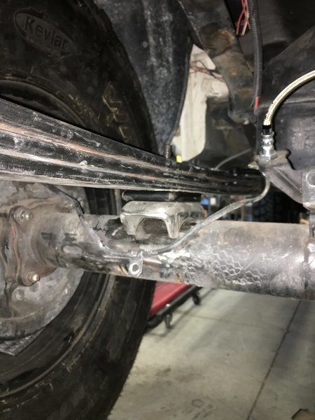

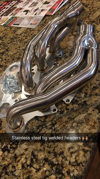

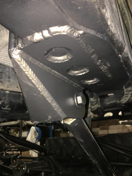

    The last 2 days have been nuts. I've put in around 20 hours of workin this truck. I welded and painted the lower links and engine bar after we flexed it. I set the kings 1 1/4 different and added that 1/2 inch block in the rear to level the truck out. No lean anymore :taco: I Got my headers in!! Wrapped them with the heat tape to reduce engine temp. I have almost finished the rear end, might scoot the shackle mounts forward for a better angle. 7" shackles. Took the kings out to tune them and get some nitrogen in em. Then she's getting drivelines real soon. Exhaust will be last. I can't wait to get this thing rollin! :bananadance:
