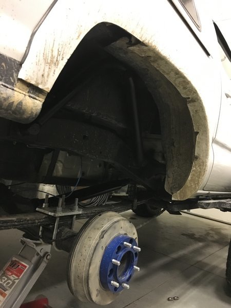

  1. Dec 10, 2016 at 11:02 AM
    #161
    Rattletrap66
    Rattletrap66 (ノಠ益ಠ)ノ彡┻━┻
    Aug 25, 2014
    #136901
    23,784
    Frank
    Tampa, FL ☜(゚ヮ゚☜)
    2014 TRD Off Road DCSB
    ╭∩╮(ಠ۝ಠ)╭∩╮
    I have 14" but if you go hoops through the bed you could go 18" like in @SMKYTXN 's build
    SMKYTXN and ChadsPride like this.
  2. Dec 10, 2016 at 11:08 AM
    #162
    Gavin Goodfellow
    Gavin Goodfellow [OP] White delight
    May 3, 2015
    #154481
    84
    Gavin
    utah
    2008 2nd gen white delight
    Brute Force Fab Front plate bumper / Heretic 50 inch light bar/aurora pods/pro comp 6" lift/toyo mt 295/75/17 with fuel rims/k&n cold air intake with throttle body spacer/kenwood 7 inch touchscreen deck/2 rockford fosgate 10" subs with custom box/tool box/led concepts color morph halos/instrument panel lights/offroad light switches/led headlights/custom rock sliders
    Oh I got you. I want to stay in the wheel well so I don't soak the campin gear when I cruise out. 14" should be plenty. You seriously have some mad flex on the rear :goingcrazy:

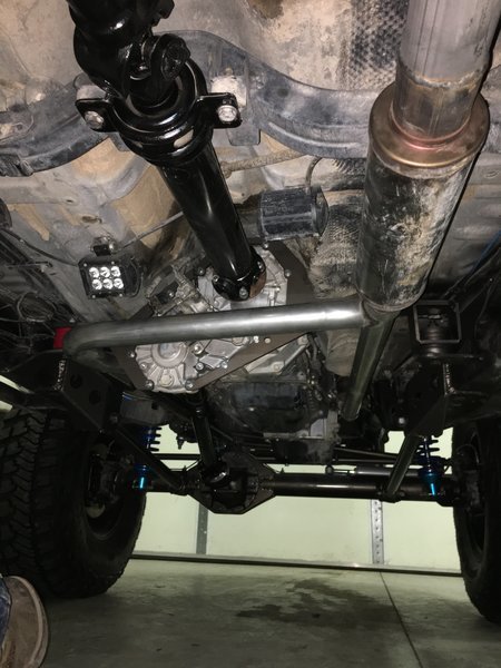

    Exhaust is done! Brakes are done! Steering is almost there. I'm re arching the leafs so I don't need an 8" shackle then set pinion angles. A little safety and emissions work then she's driving!

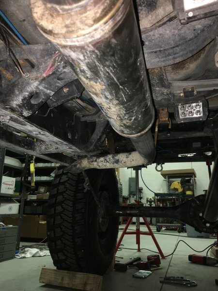

  8. Dec 12, 2016 at 7:29 PM

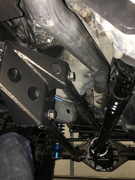

  15. Dec 19, 2016 at 9:28 PM
    #175
    Gavin Goodfellow
    May 3, 2015
    #154481
    84
    Gavin
    utah

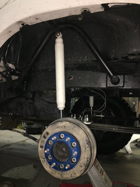

    Alright I've been doing a bunch of work but not having time to show everyone. Anyways I got one shock hoop in tonight. The money train ran clean out so I bought the cheapest I could find. I will get some kings in a couple weeks. I wanna run this thing so bad! Speedo doesn't work, I screwed somethin up haha anyways I set pinion angles aligned the front then i went for a couple rides in er to break in the gears.

  16. Dec 19, 2016 at 9:37 PM
    #176
    Gavin Goodfellow
    May 3, 2015
    #154481
    84
    Gavin
    utah
    Another update for you guys planning on doing this. I took er on the freeway even without rear shocks. :bikewhoops: Haha and I could actually let go of the wheel at around 80 mph and it tracked perfect! With rear shocks it should handle better than the pro comp. I have almost zero bump steer because the drag link, panhard bar, and tie rod are all parrellel. 4.88 gears will do fine on the freeway (about 2300 rpm somewhere around 70) and have plenty of torque down low. The adjustability in the coilovers is a must for me from now on. It makes or breaks how it handles when you take it on and off the road. Driving Has a little more body roll than my 6 inch without a sway bar but not a huge difference. The lockers will blow your friggin mind if you've never had them. That is all. :thumbsup:

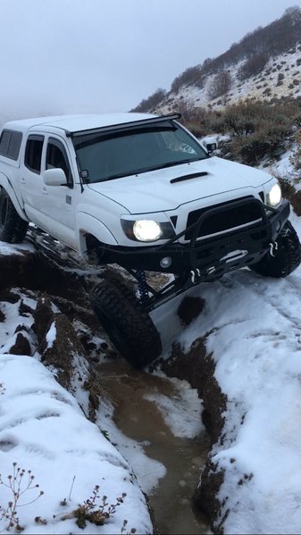

  20. Jan 2, 2017 at 1:14 PM
    #180
    Gavin Goodfellow
    May 3, 2015
    #154481
    84
    Gavin
    utah

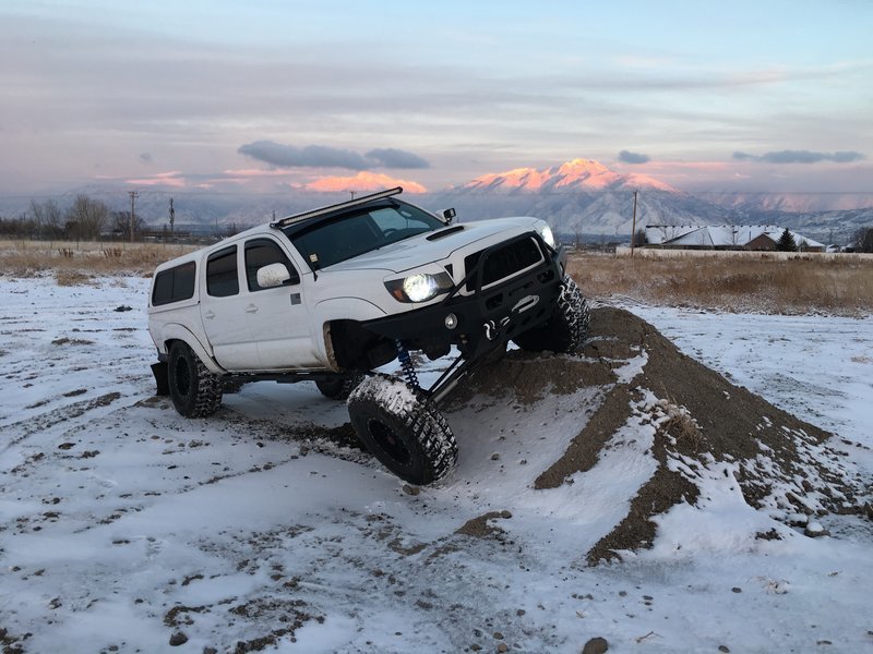

    I Have put over 500 miles on er now. Traveled to 2 different states and done snow wheeling all around. Haven't hit any rocks yet. My speedometer situation is about to be solved, hasn't worked since I got the truck running. It's connected to the ABS and I ripped everything out lol the thread to fix that is here http://www.rocksolidtoys.com/forum/showthread.php?t=164. I installed some pro comp dampeners in the rear for now. Wait till spring when I can afford the kings. The rear fender flares have ripped off and I'm not sure how to fix that yet o_O I beat the heck out of this thing but it still tracks straight :bananadance: The Chevy 63 springs (3 leafs) are too soft and I'm going to add a leaf or two when I get time for it. I hope to see a couple of you out in Moab at rock therapy this year!
