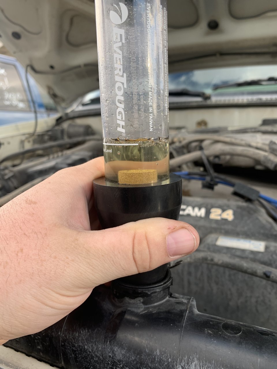

    Definitely do a combustion leak test (turkey baster looking tube with fluid) on your radiator. You can rent the tester at a local O’Reillys or autozone but you have to buy the fluid for $10 or so. There’s videos on YouTube how to do it, it’s a good starting point and could save you time and a few bucks vs getting diagnostics done. I just recently did mine and here’s my sad result, the liquid changes from blue to yellow = hydrocarbons in your cooling system (exhaust fumes which means a bad head gasket)
    Currygoat and tirediron like this.

    I recommend doing this because popped head gasket doesn’t always immediately mean milkshake or anything. Thankfully I caught my bad head gasket early on before it milkshaked or started smoking but I was losing water fairly fast without it leaking from the radiator. I believe the water was going into the cylinders because it would have rough idle at start and eventually cleared itself out and smogged with the cleanest numbers yet, lower than the average range (probably because it was basically water injection lol) :rain:
