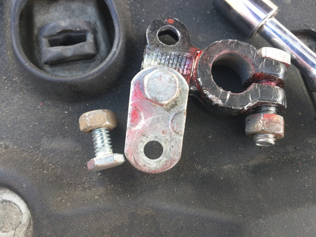

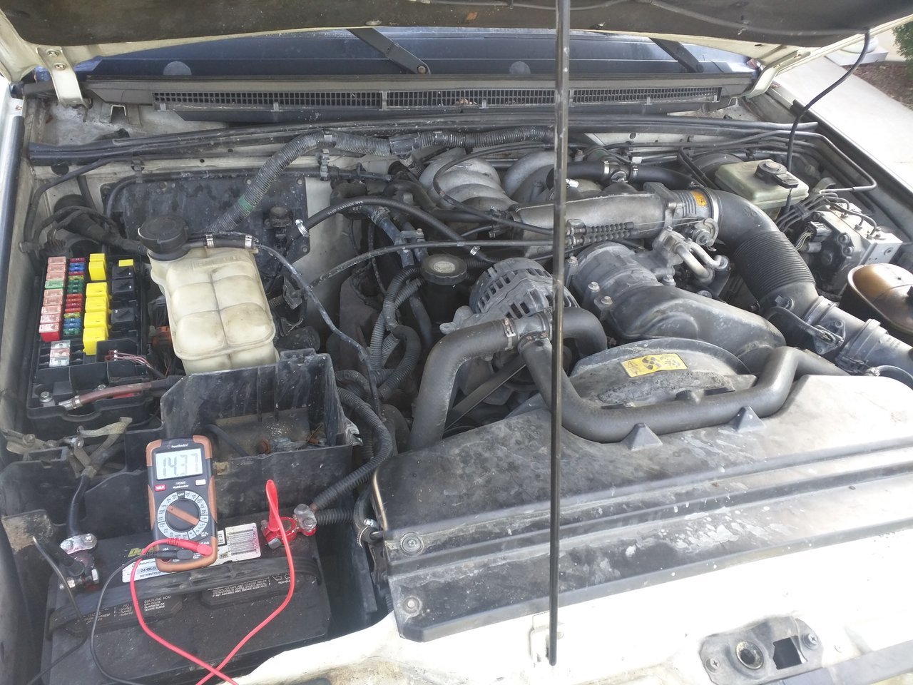

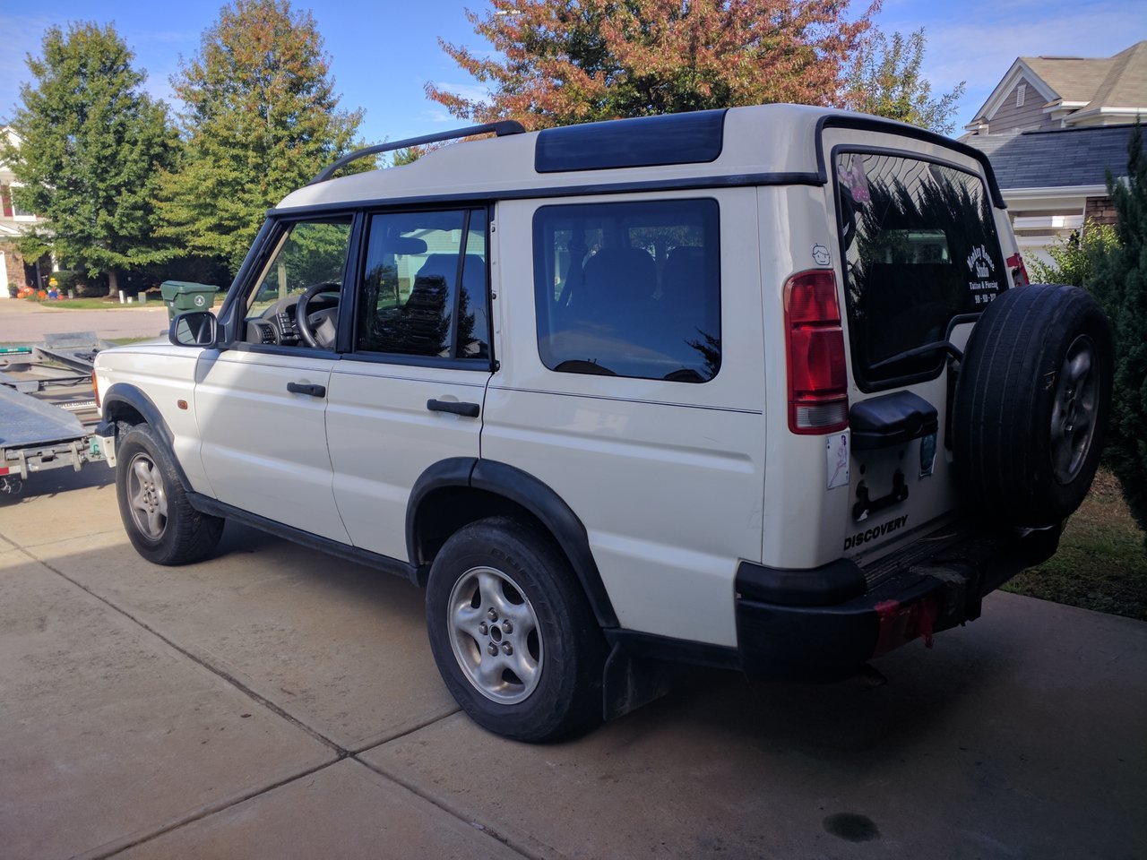

    I just picked up a project 99 land rover Discovery II. It's got the Bosch 4.0l that runs fine, but the auto trans won't pickup any gears. The owner kept having to Jumpstart it and fiddled with the battery cable terminals, I tightned the cable in the clamp and haven't had another issue.

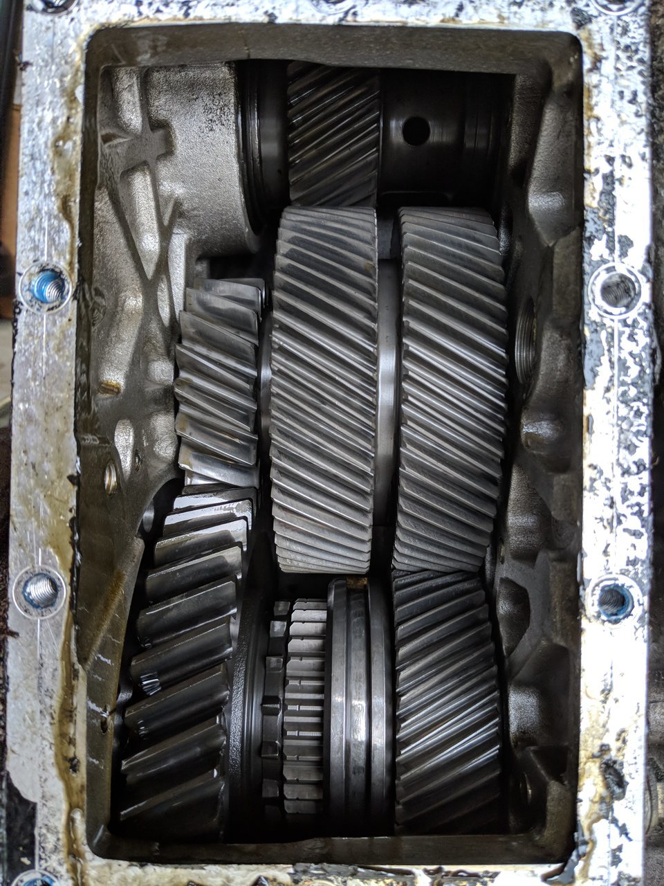

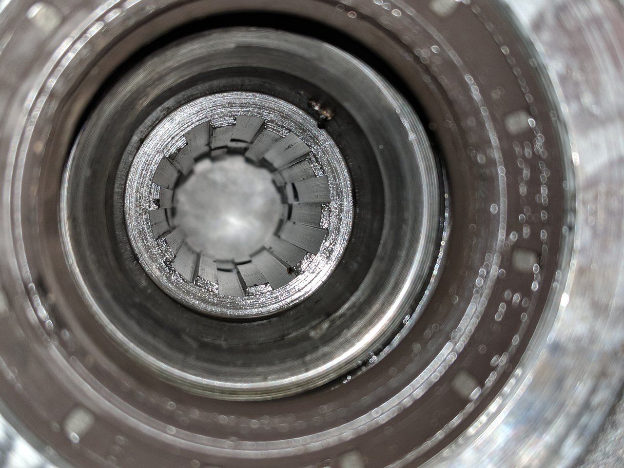

    Both the CDL and input shaft splines seem to be fine. Now either gear teeth are missing or it's stuck in neutral, gonna have to drop the exhaust to check any further.

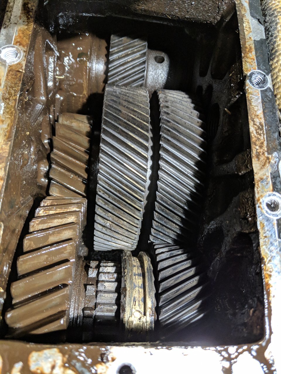

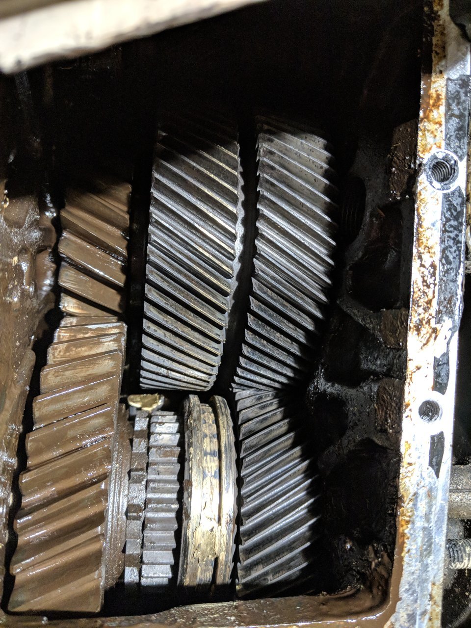

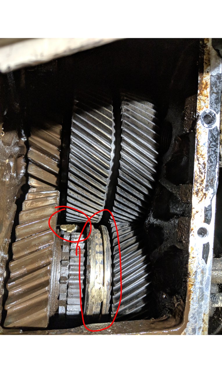

    And here's your problem. It looks like the transfer case oil "leaked" out (doesn't look like it was leaking), the bearings and shift fork wore out, and then the shift fork(brass) detonated leaving the transfer case in neutral.
    On a positive note, the input shaft has the oil hole that they added later on to keep the splines from wearing out.

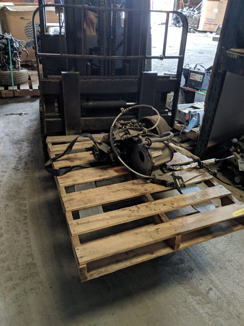

    $144 junkyard T-case w/85000 miles, 90 day warranty

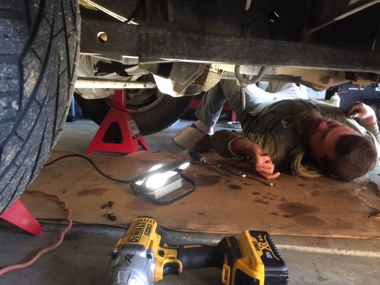

    Got the y-pipe out with relative ease, impact gun made quick work of the stud nuts :eek: none broke! Also pulled off the driveshafts.
