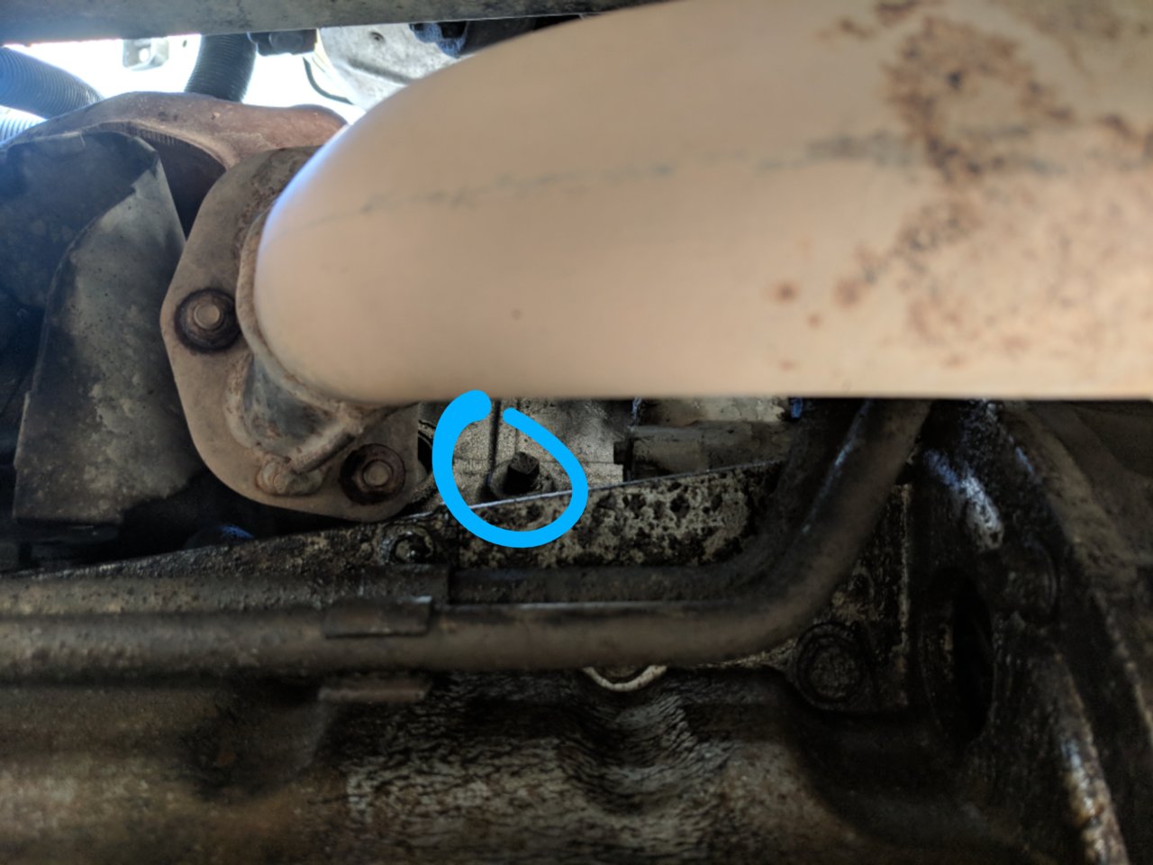

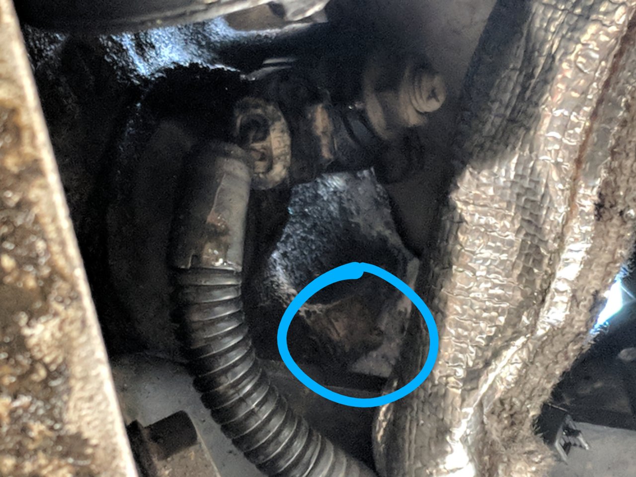

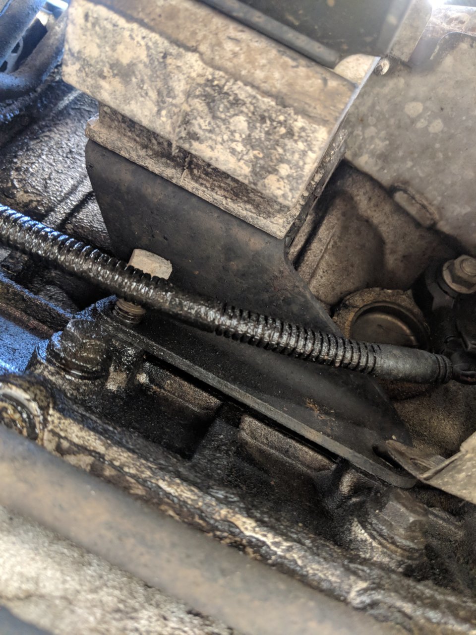

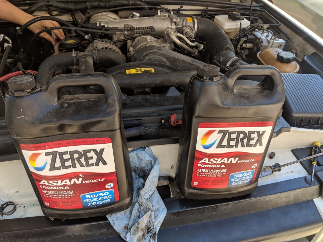

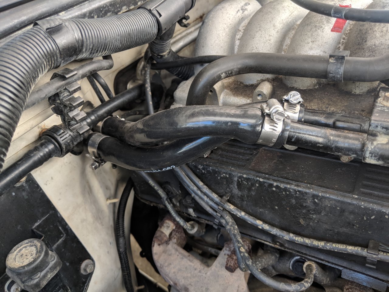

    Went searching for the block drains and found a motor mount bolt about to fall out and another one gone completely.. Tightened the one back up, drained/flushed the coolant, fitted the heater hoses, and refilled it with Toyota Xerex Asian coolant thanks to @JimboAnz. @Red Baron makes a good gofer lol thanks for the help.

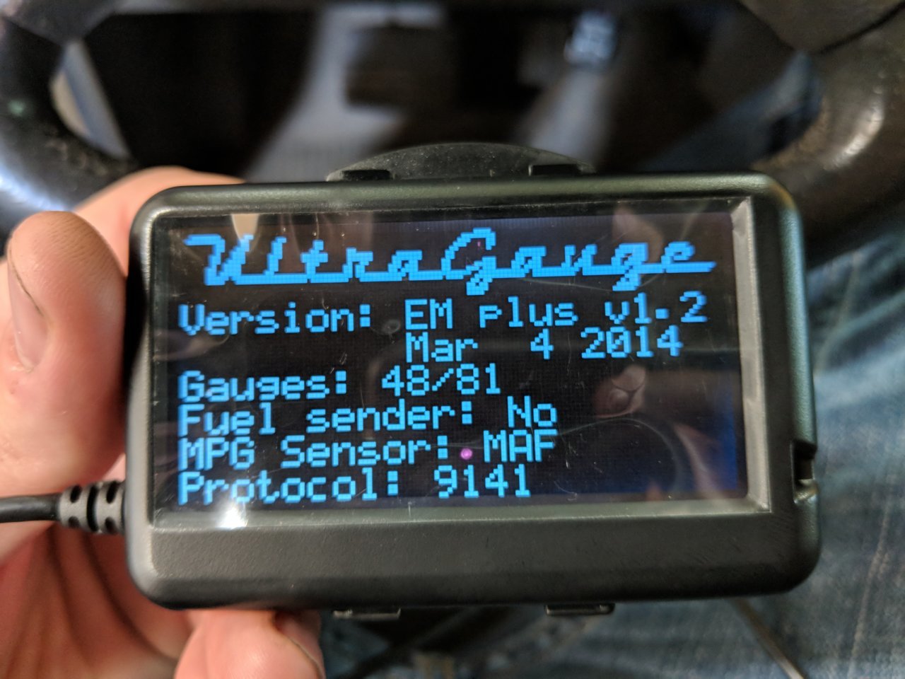

    Ordered some bolts last night, it'll be nice to know the engine won't try to jump out.. Also got my Ultra-gauge from the group buy here.

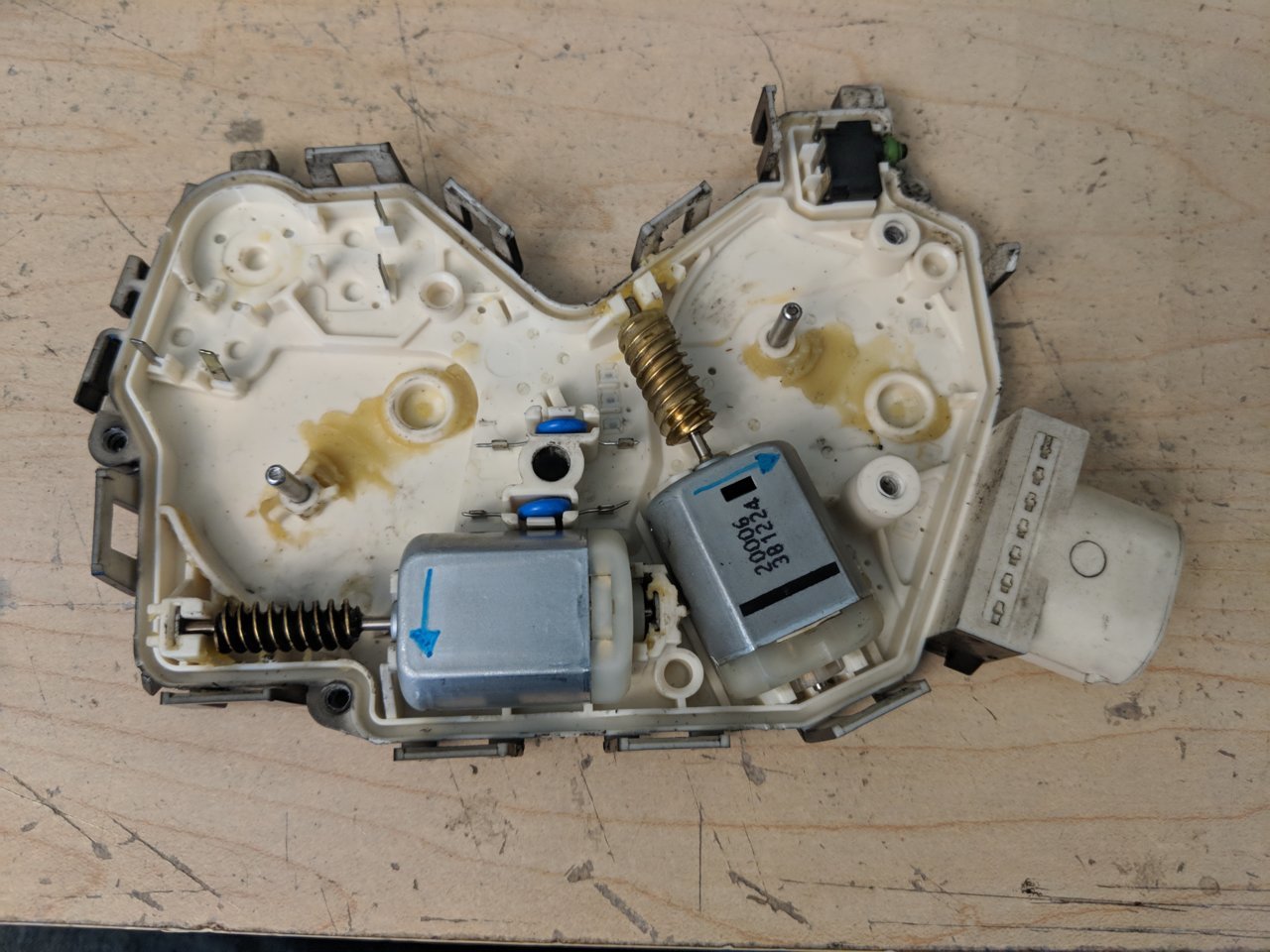

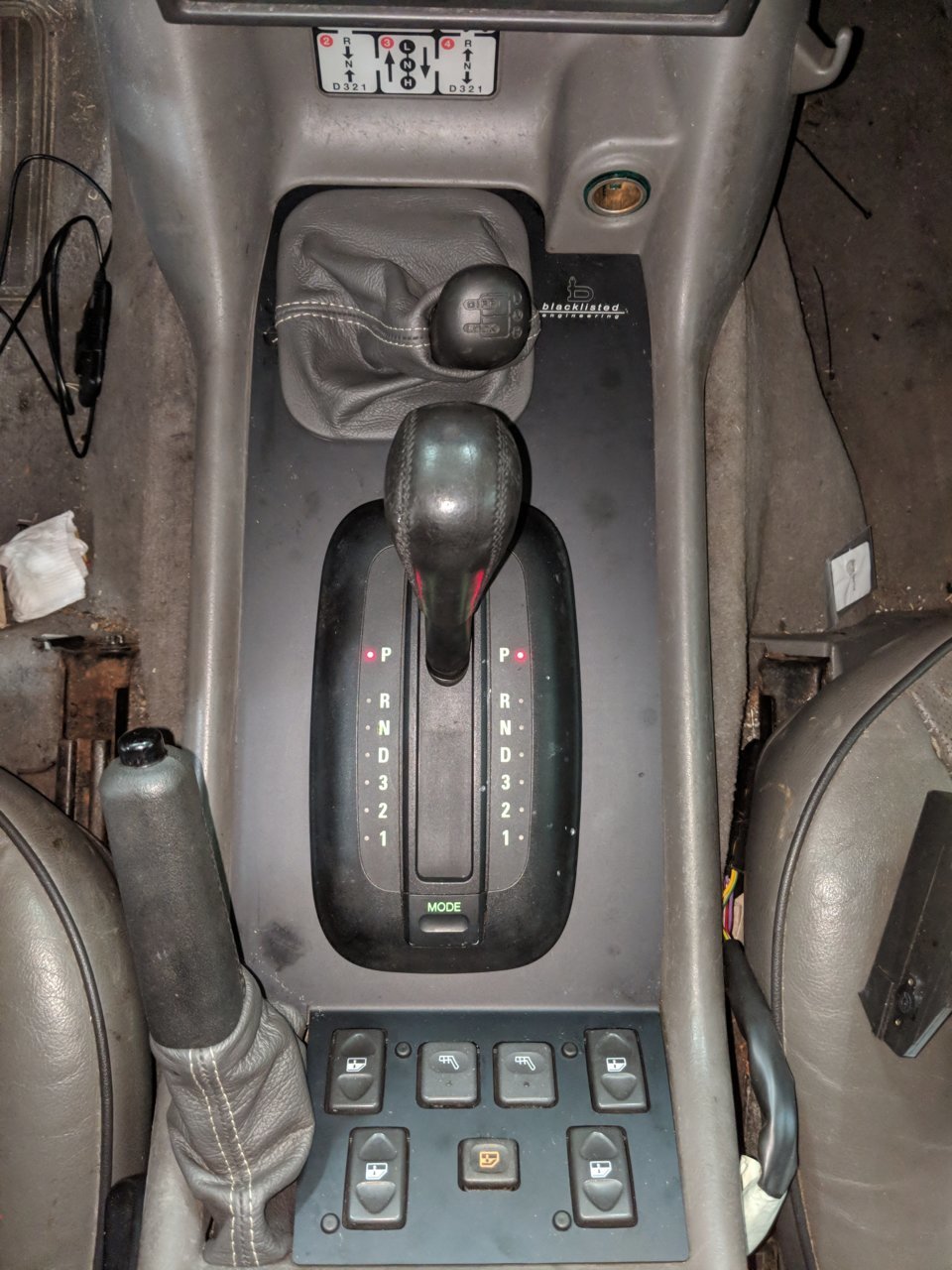

    The good news: 1 of the 5 door locks works
    The bad news: It's in reverse, lock=unlock.....

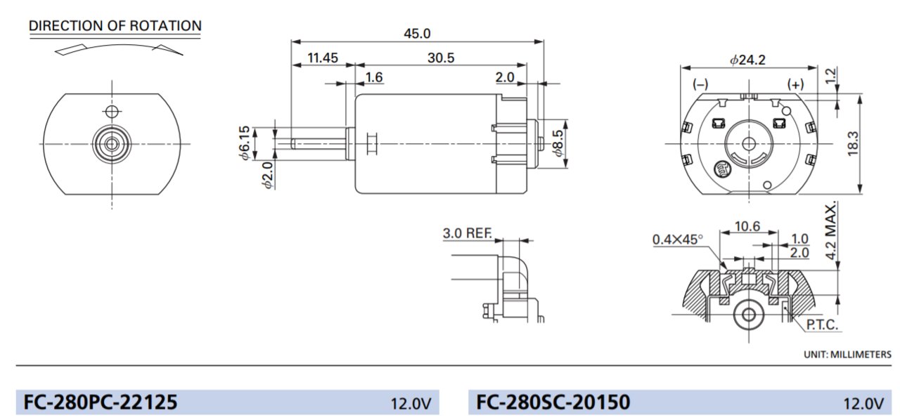

    The ugly: Someone help me check my sanity...which way do these motors spin according to their datasheet?? I bought, 4 FC-280PC-22125 (also shows FC-280PT-20150 in the ebay ad) which showed up unmarked, and a KIA motor that looked like it had a gear/length that might work marked FC-280SC-20150

    Blkvoodoo
    Blkvoodoo a Hooka smoking caterpillar has given me the call
    Jul 23, 2015
    #160098
    4,187
    Kevin
    Near Clayton NC
    08 PreRunner SR5 DCSB
    clockwise from the drive end

    Sandman614
    Sandman614 [OP] Ex-Snarky TWSS elf, Travis #hotsavannahdotcom
    Oct 26, 2010
    #45273
    36,043
    Tim
    Garner, NC/Boone, NC
    '06 SR5 Off Road
    That's how I read it.. But apparently it's not right or we're crazy

    diverdale
    diverdale #sosconceptscrew
    Sep 22, 2015
    #164936
    1,730
    Dale
    Raleigh, NC
    2015 TRD OR DCSB
    Fox 2.5 Coilovers, Fox 2.0 Rear Resi, Icon 3 Leaf AAL
    DC motors...swap + / - and they'll spin "backwards"

    Not really an option

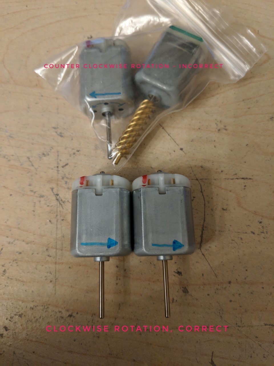

    Eh no big deal, I found the answer on the motors and ordered what I needed plus have extras to make some money back on.

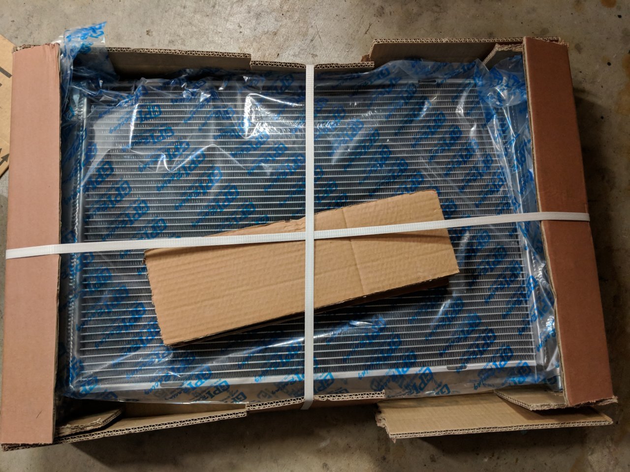

    The correct lock motors came in and so did the aluminum radiator. Hate the mail lady had to deliver it in the rain lol.

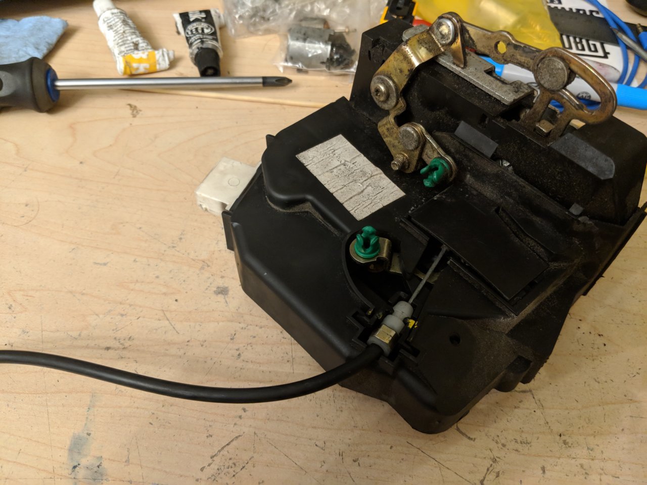

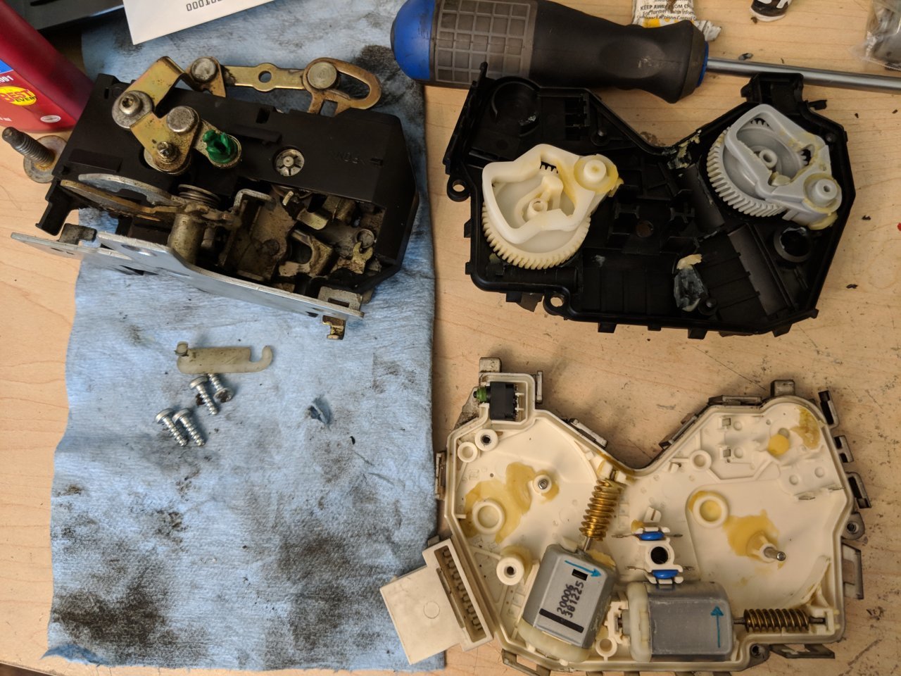

    One Rover door lock done!

    Door lock #2 out and disassembled

    Got some more work to do... I mean lock motors.

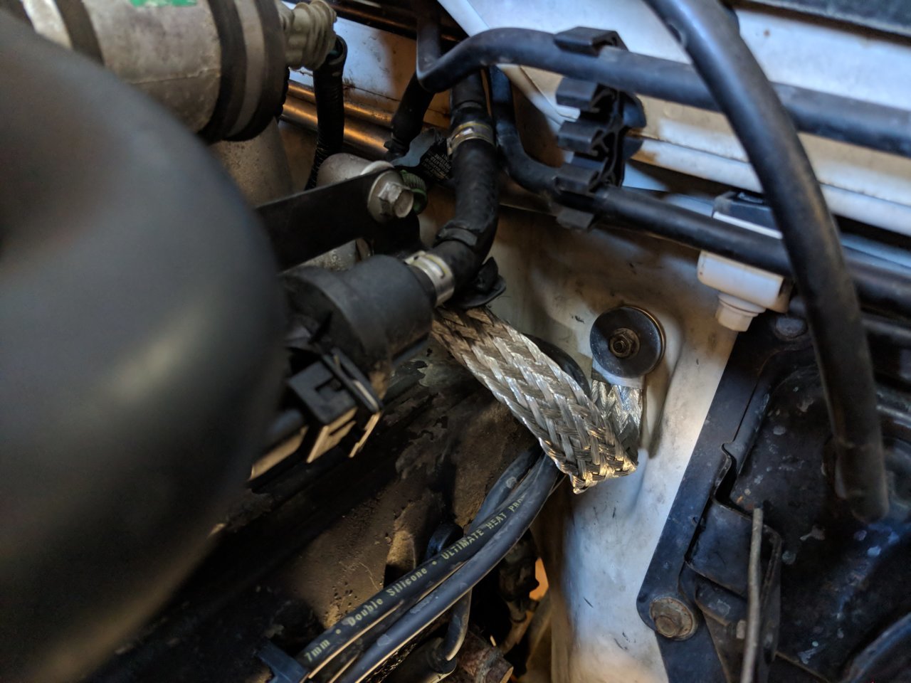

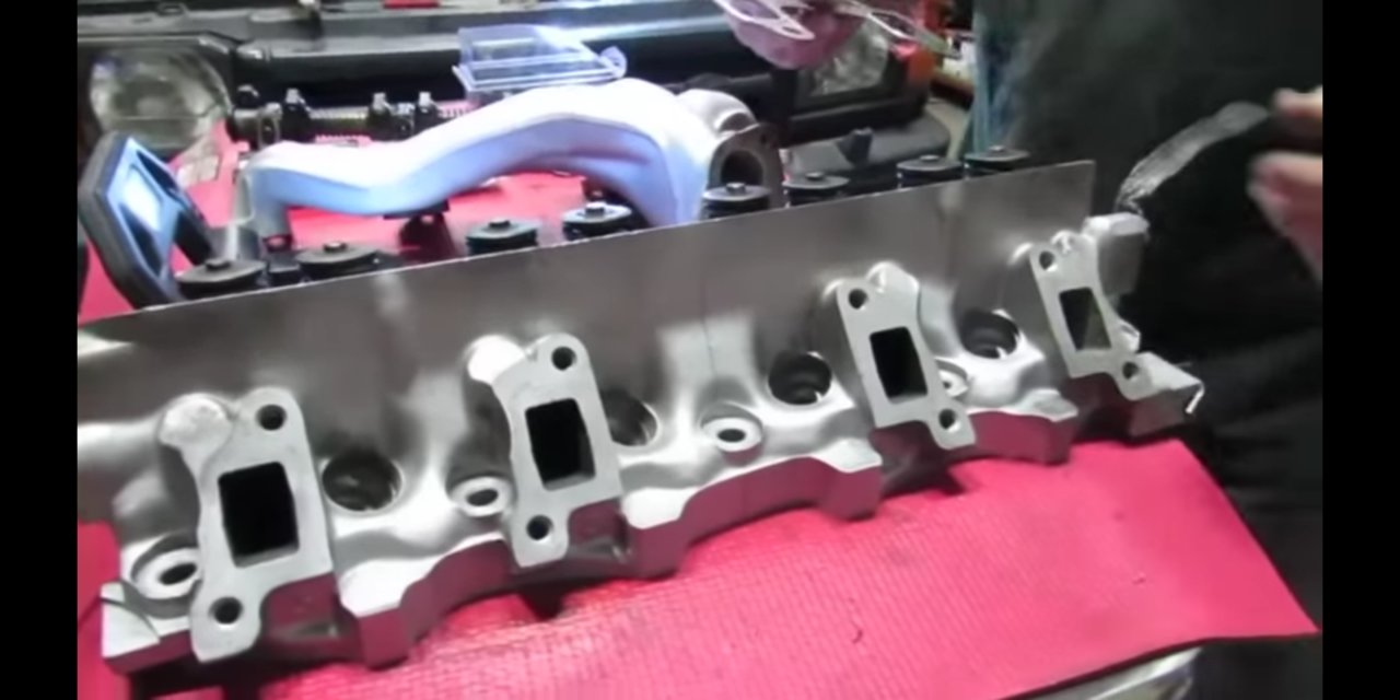

    Finally put this body/block ground strap back on. It looks like previously it was on an exhaust manifold bolt, and this video from Atlantic British shows it bolted to the back of the head. Since I don't want to mess with the exhaust bolt or finagle behind the head I think this easy to access bolt on the intake should do just fine.
