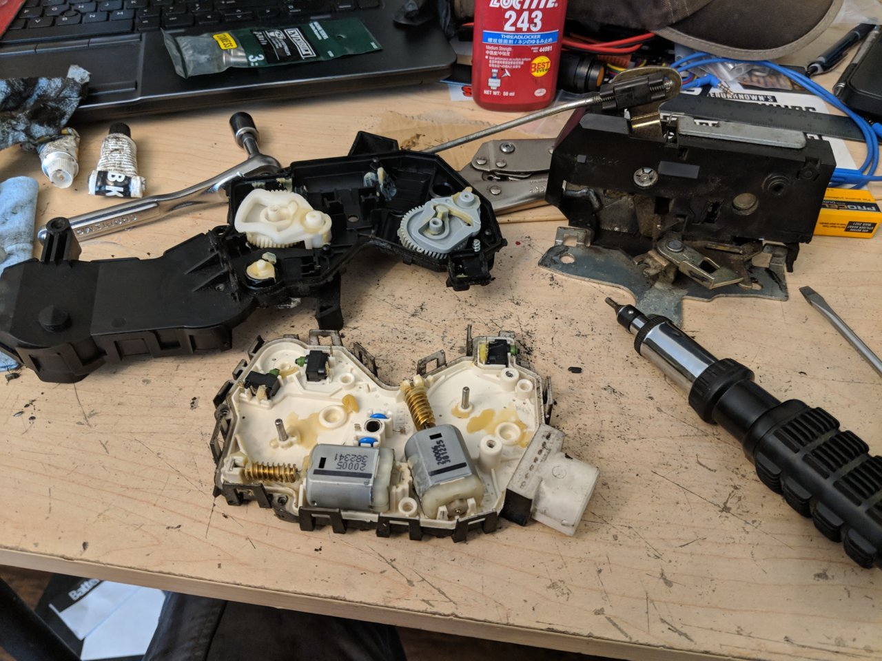

    Does this look like all the tools I would need to remove a gear from a motor? Door lock #3 and #4

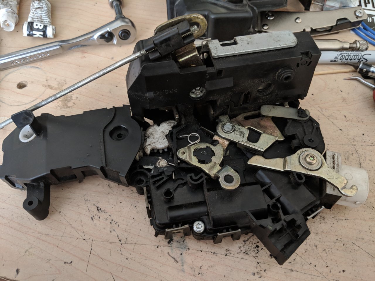

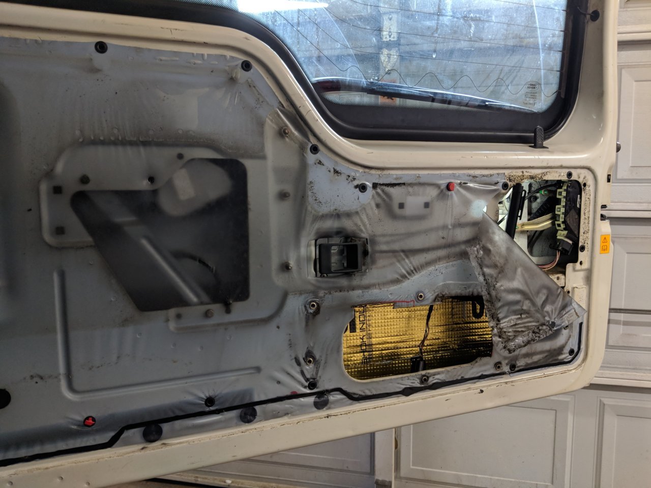

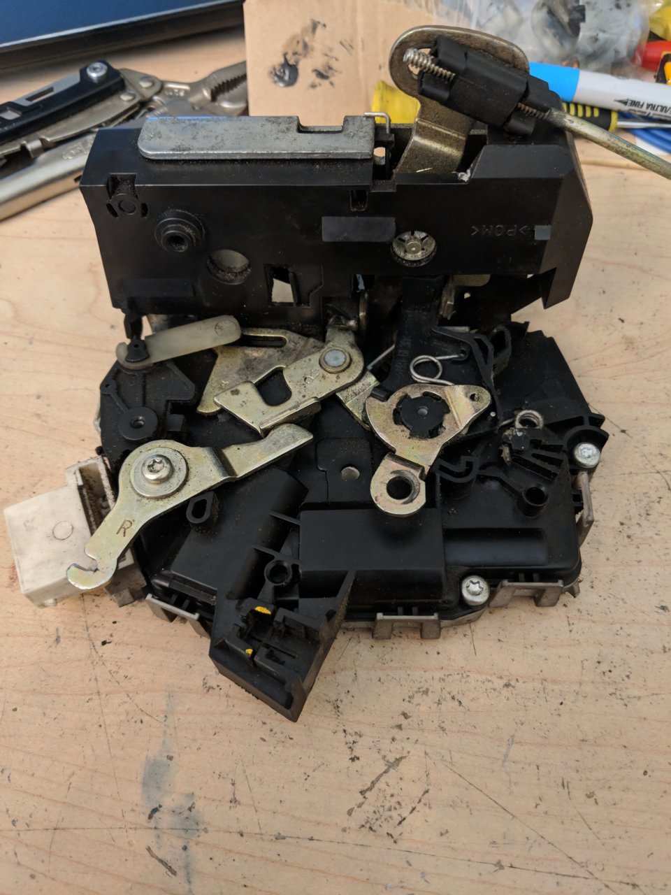

    Last door lock and of course it gives me trouble.. Had to climb in and manually unlock it, something is sticking...:mad:

    I had an issue on a Miata once where the bar between the lock mechanism and the actuator was in a bind. Not sure if that Disco2 has that setup but disconnect whatever it is and see if it functions.

    There's a rod from the finger that pops up to the lock but it's the actual gears inside the mechanism that's sticking, I can't figure out what makes it do it though

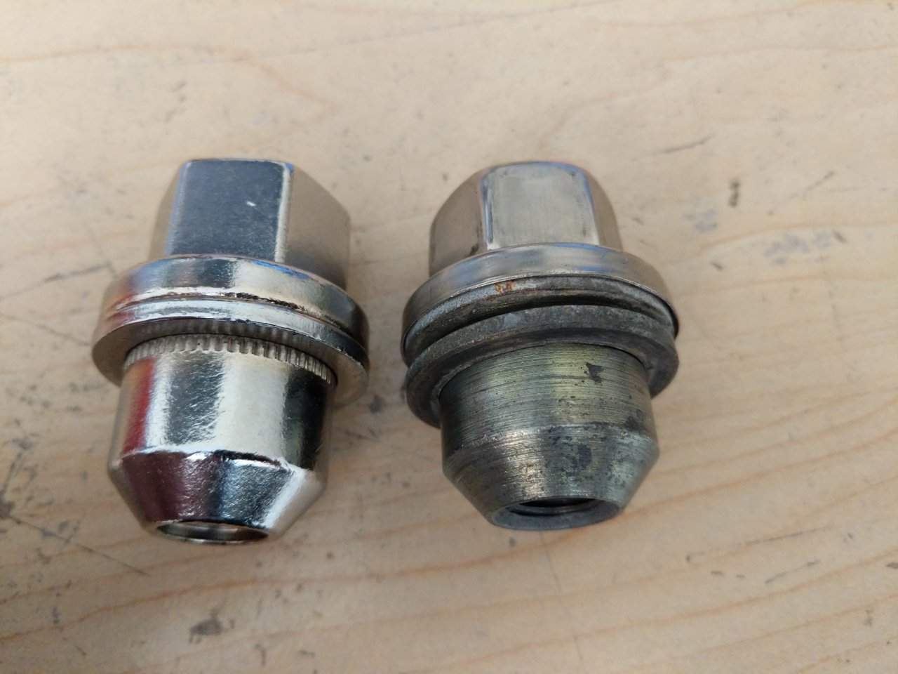

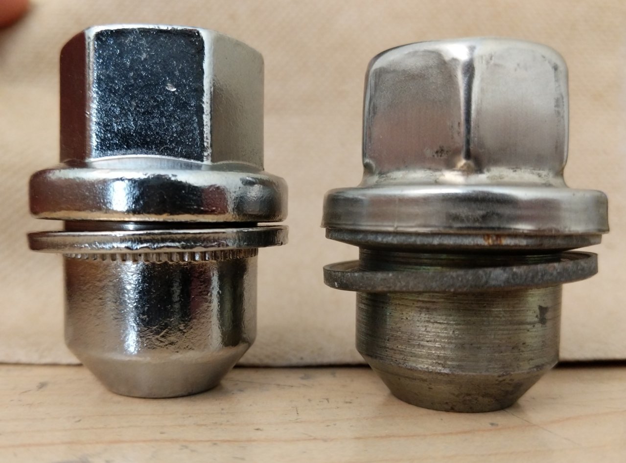

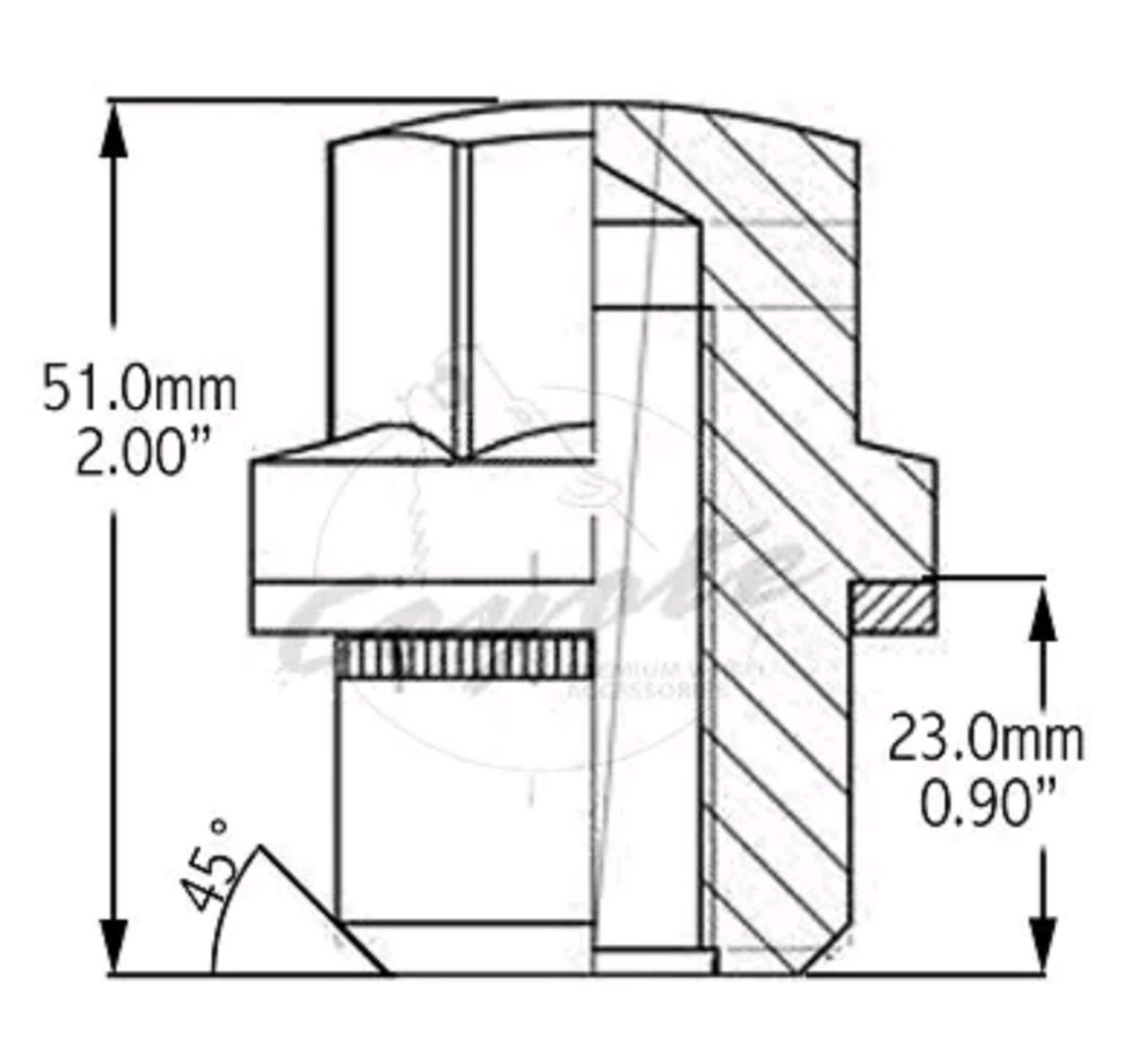

    Lug Nut and wheel information, hoping to find some that don't have a silly cap that swells when you remove and install the lug nuts.
    Overall Length- 49mm (1.93in)
    Overall width- 39.3mm (1.54in)
    Shank Length - 23mm (0.905in)
    Shank Width - 28.84mm (1.13in)
    Shank angle - 45*
    Thread Size- M14x1.5
    Lug Drive/Hex Size- 27
    Bolt pattern - 5x120
    Wheel Center bore - 72.56mm
    LAND rover OE Style 14x1.5 lug nuts 27mm hex range rover
    https://www.ebay.com/ulk/itm/183335684059
  7. Oct 24, 2018 at 11:10 AM
    #247
    Sandman614
    Sandman614 [OP] Ex-Snarky TWSS elf, Travis #hotsavannahdotcom
    Oct 26, 2010
    #45273
    36,024
    Tim
    Garner, NC/Boone, NC
    '06 SR5 Off Road

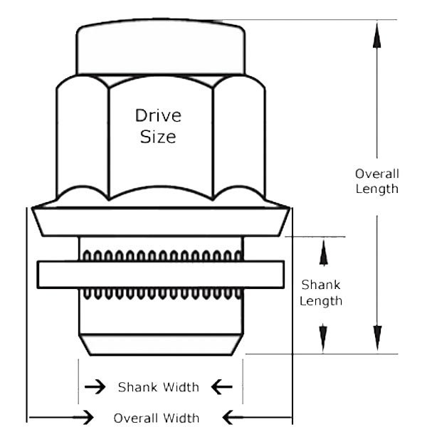

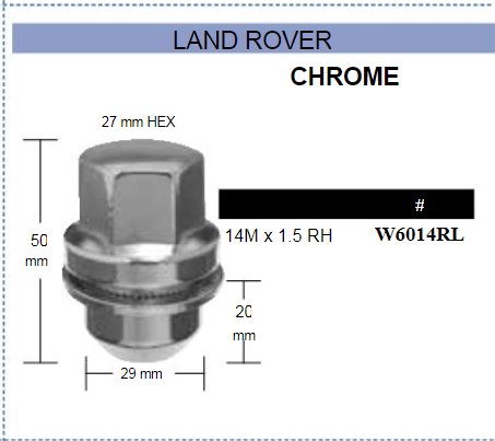

    Well that ebay seller was nice enough to call me and tell me that they don't have them in stock and the manufacturer has them labeled as discontinued.. These ones look close and I think the shank length measurement is taken incorrectly for their picture.. W6014RL
    Better measurements
    http://www.rthibert.com/content/files/cat/winterwheels/files/assets/basic-html/index.html#345
    https://www.carid.com/west-coast/chrome-mag-seat-oe-style-closed-end-lug-nuts-mpn-w6014rl.html
    Ordered from this company
    https://www.sfxperformance.com/parts/WCAW6014RL-X20.htm

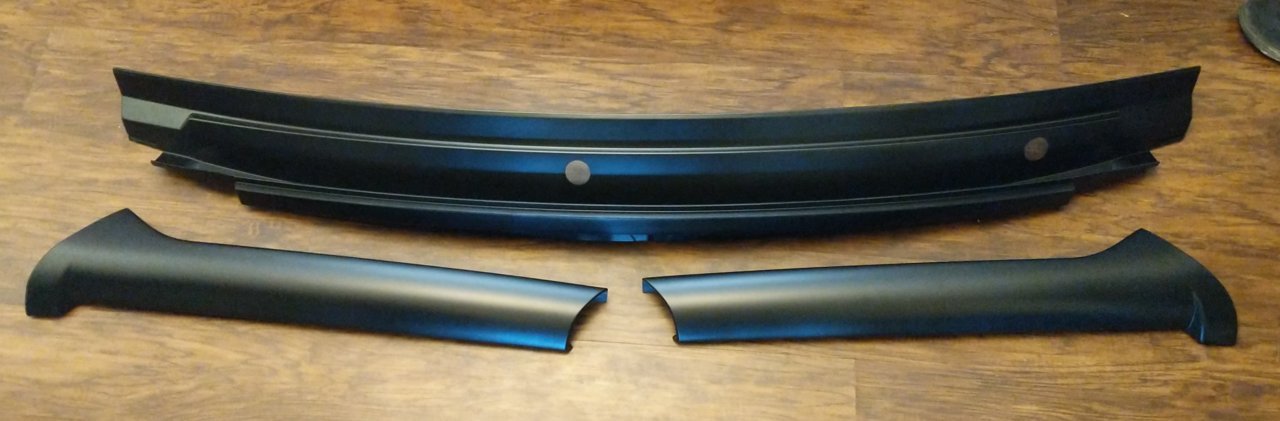

    Got the new fiberglass parts that will be replacing the crappy old plastic windshield trim finisher pieces from rexypowparts.com

    Got the new solid lug nuts in. No more loose nut caps form using impact tools.. West Coast Wheel Accessories W6014RL

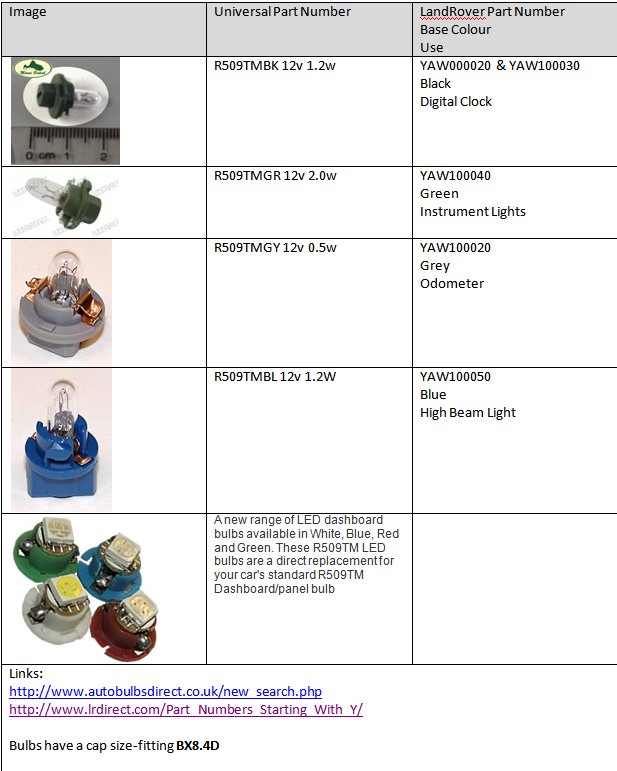

    New led dome lights and clock lights finally came in. Also ordered up some Philips led lights for the brake and reverse lights. Gonna test fit them in the 3rd brake light @SC2SC said was far too dim, the bulb that was in it is a tiny little type 67 incandescent.

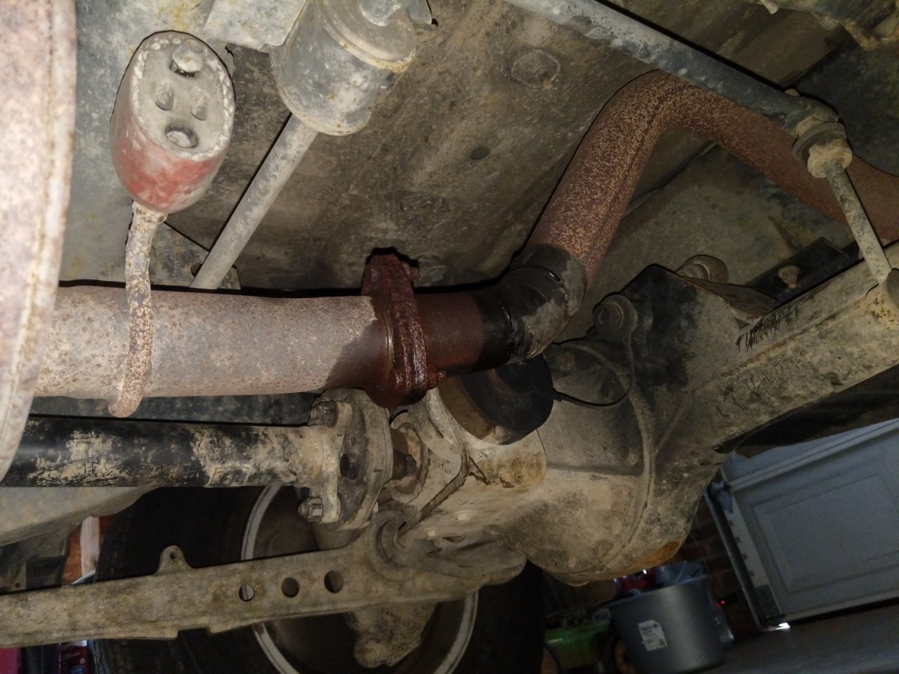

    Try to DIY a muffler back exhaust for the Rover or take it to a shop and get something done..? Need to get it off of the whatever that is attached to the diff and stop it from rattling on the bumper, maybe even swap in a new muffler.

    Is that like a weight mounted in rubber on side of diff housing ?
    Could be a harmonic dampener trying to control some errant vibrations

    Doesn't seem like rubber on it, but yea pretty sure that's what it is.

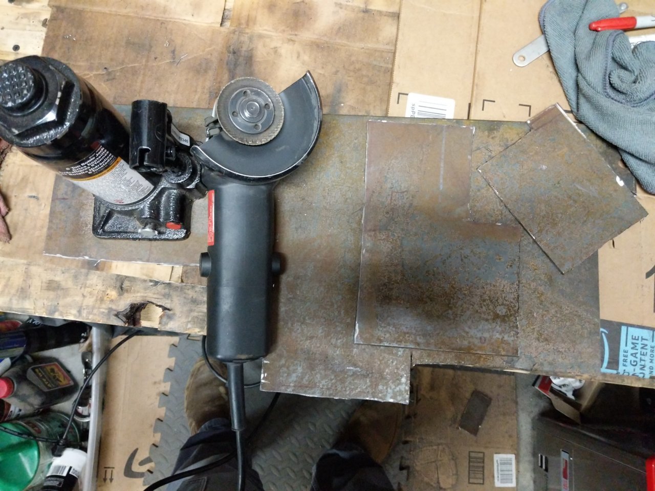

    CAD is an awesome way to mock-up something like this jack mount, but if you don't have skillz....

    Getting close to time for a new cut off wheel..
