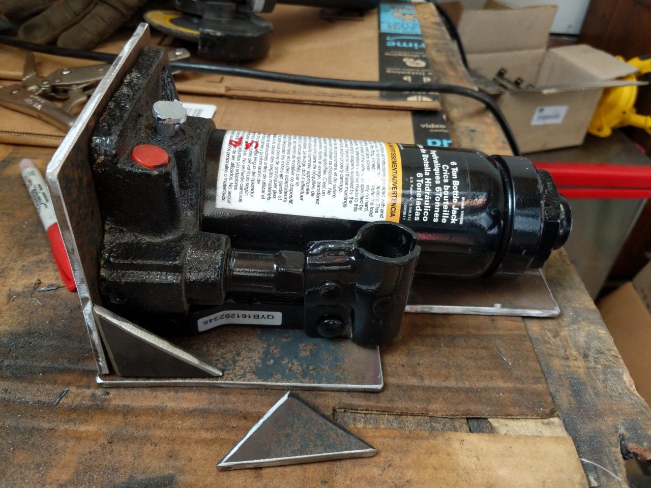

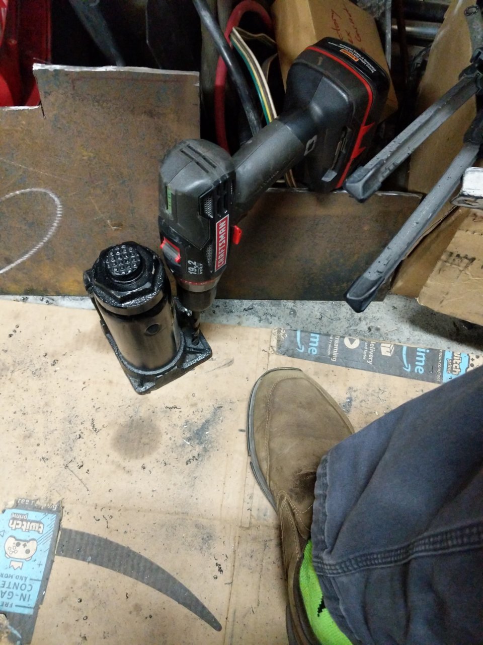

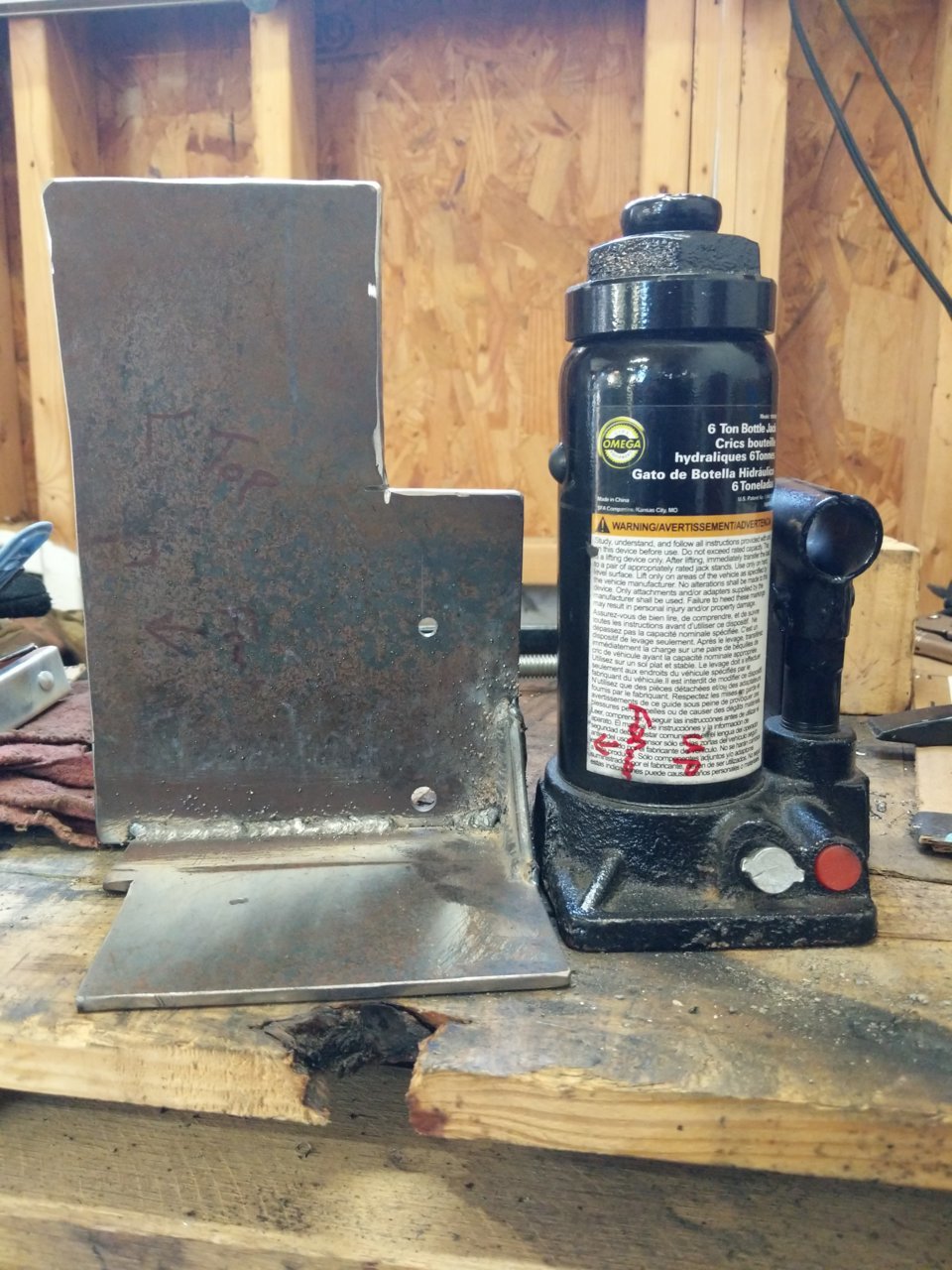

    :eek: That could have been worse.. Lol it wasn't an issue until it hit the concrete, the bit grabbed, spun the jack around against my finger and then landed on the floor... It started on the bench. I'm surprised the bit didn't bend or break and it missed my toes

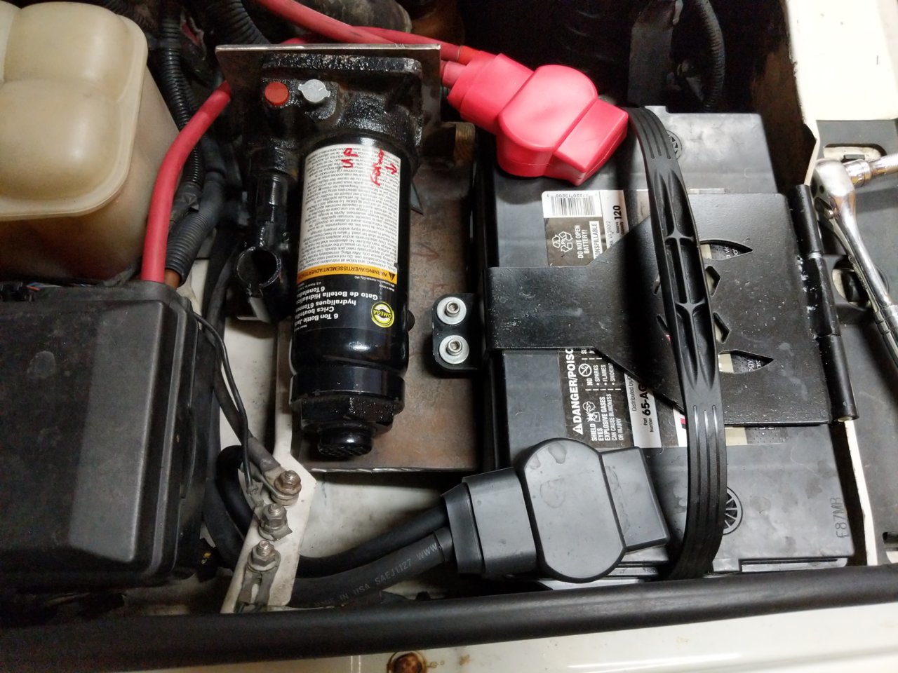

    I got it now. Creative. I hadnt thought of keeping a jack under the hood. If you add a tab above the lift pad you could just give the jack a couple pumps and let hydraulic pressure hold it in place and keep it from rattling

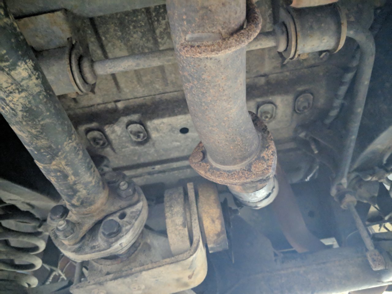

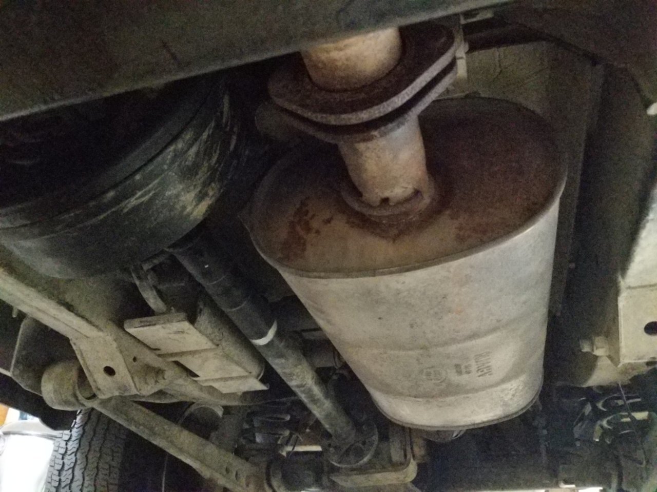

    I need to go get this thing inspected for next year and then soon it'll be time for some new exhaust that doesn't rattle on everything. Im gonna have the resonator removed and have them rework the exhaust over the axle so it doesn't rattle against the vibration dampener thingy

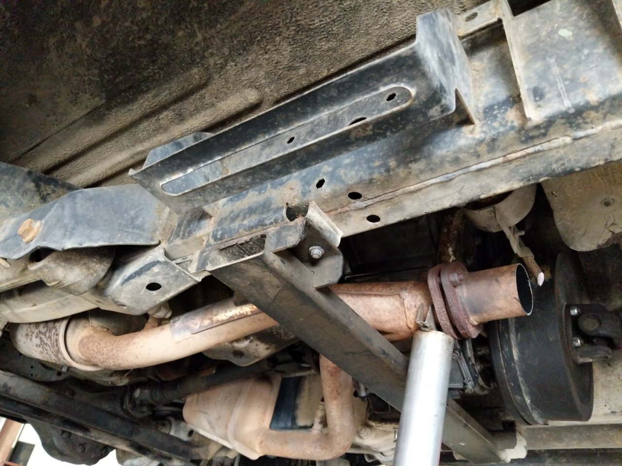

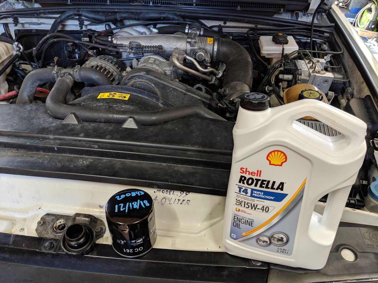

    Well tried to get it inspected and the hole the dempener rubbed in the exhaust failed it. Went straight over to the exhaust shop and have an appt for tomorrow. In the mean time I figured I'd change the oil. Decided to go with Rotella T4(conventional). 200843 miles and have no clue when the last time it was done.

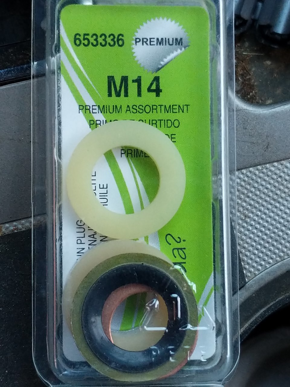

    Well that would be why there was a drop from the oil drain plug. The previous owner, or oil monkey, didn't put a crush washer on it. It's a 14mm plug.
    While under the hood I smelled coolant, checked all the new connections and they were dry, then I checked the radiator hoses which were further down the list to replace.. So now that that has moved up the list I'm ordering some silicone hoses and a new 180F thermostat.

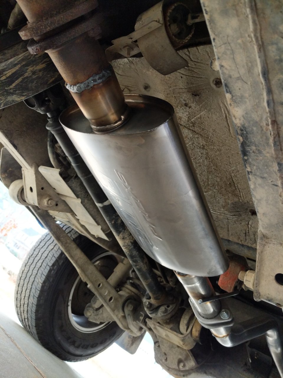

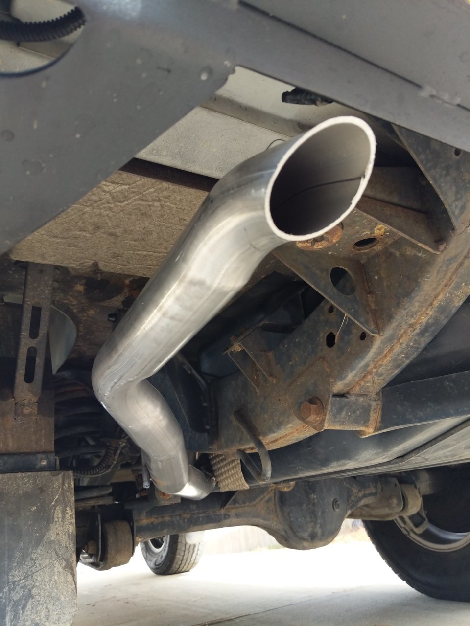

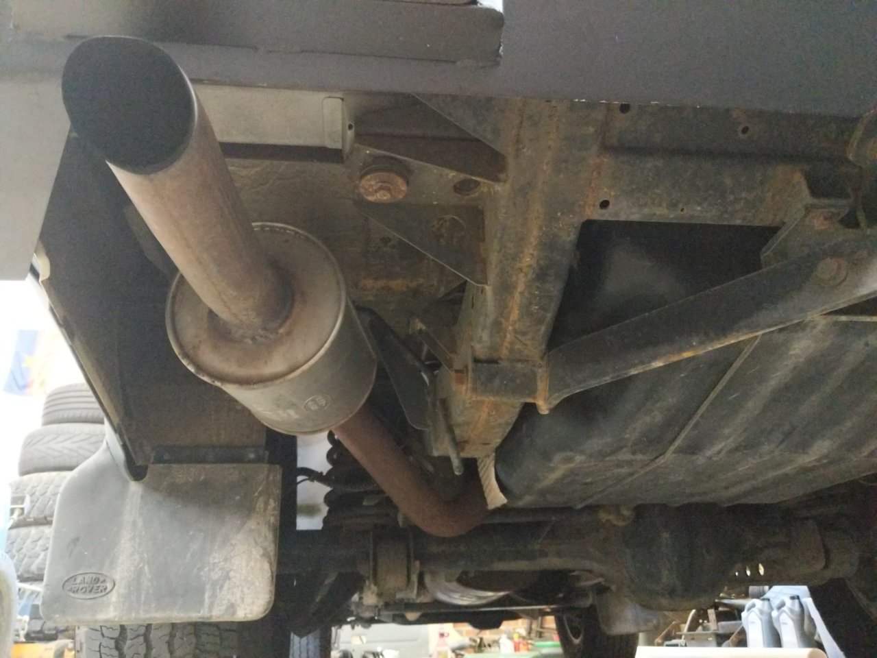

    Back from the muffler shop and while the fitment if pieces could be far better, the new Borla muffler sounds good and the pipe doesn't leak. This isn't a high dollar job, granted I didn't pay for that either. Hacked out the old with a Sawzall, and migged in the new cobbled.
