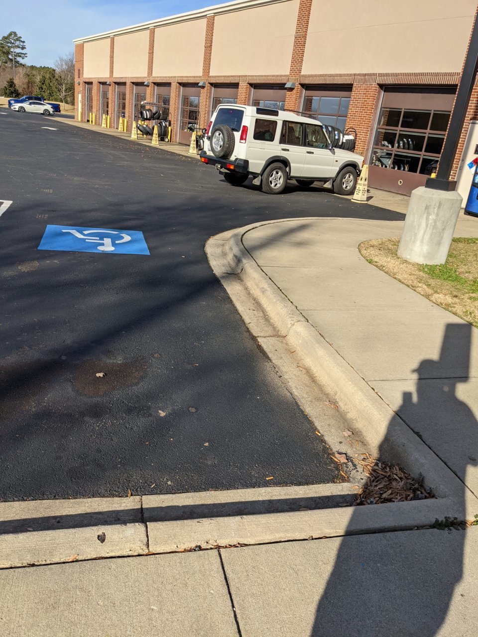

    Time for the annual safety inspection $13

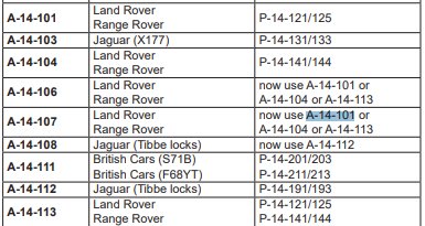

    Just ordered a couple Rover key pinning kits. Let's see if they actually send them and if they are actually what I need...
    Edit:they shipped :fingers crossed:
    And received them!

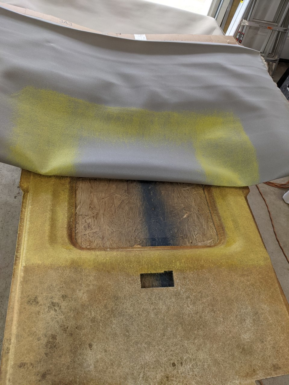

    It was a nice day so I decided to finally get to the headliner. It's FAR from perfect but FAR better than it was and I'm happy with it for what I paid for the vehicle.

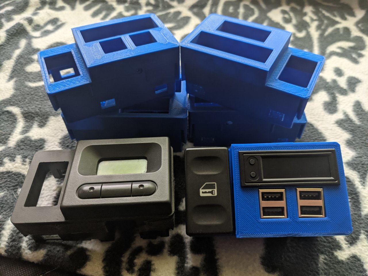

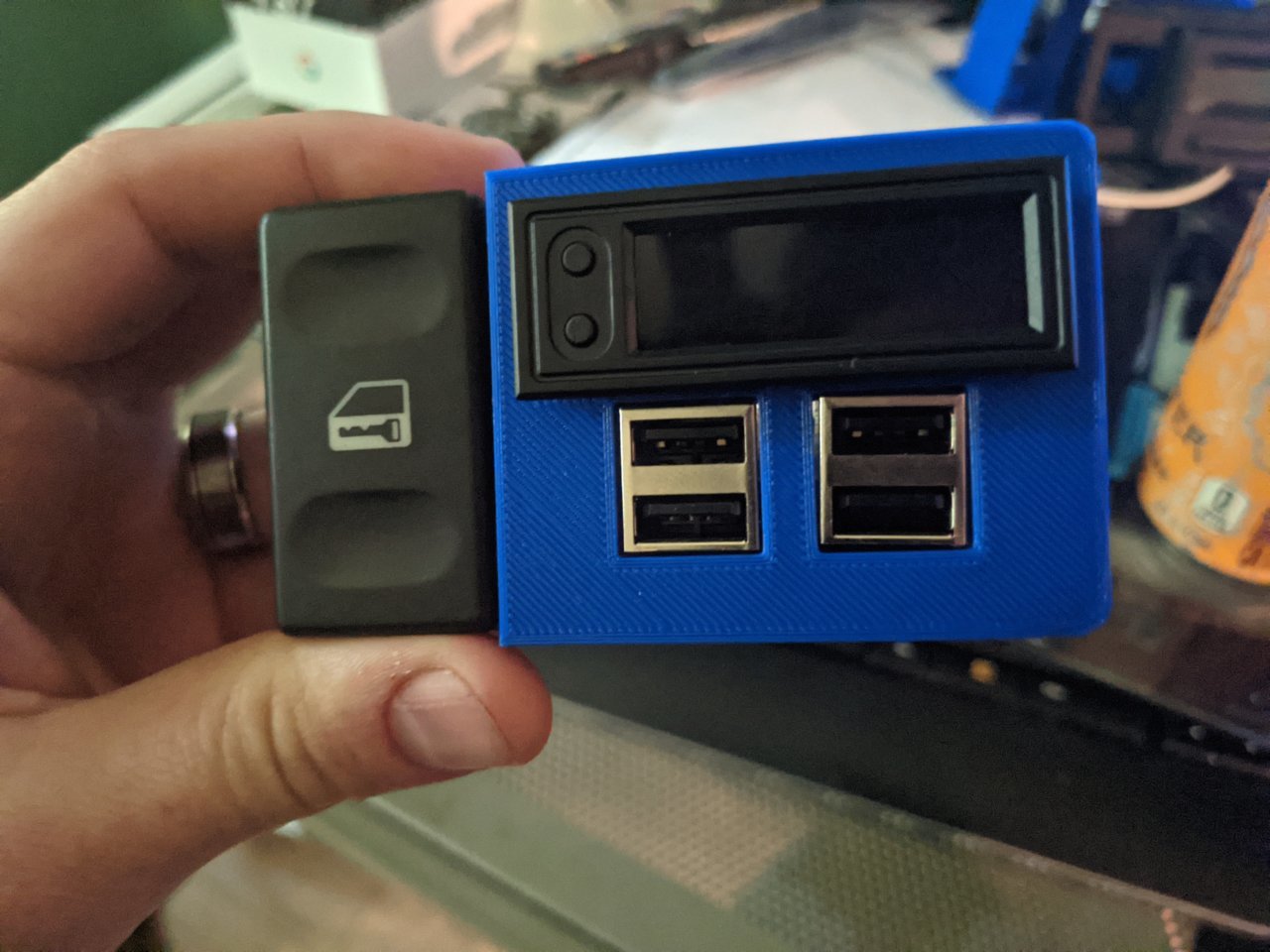

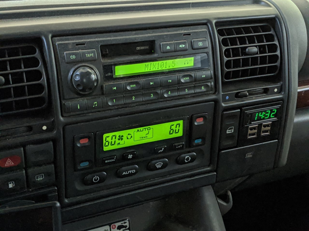

    Segments of the clock were going out, seen this 3d printed clock insert on a UK sight for like $50 "fuck that I'll just print it!" myself. Took a few iterations to get it right and just when I thought I had it... I had the keyed sides backwards... I designed the whole thing upside down and backwards... Lucky it's easy enough to rotate around axis in Fusion360.

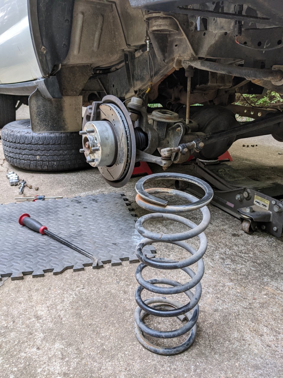

    Garner, NC/Boone, NC
    '06 SR5 Off Road

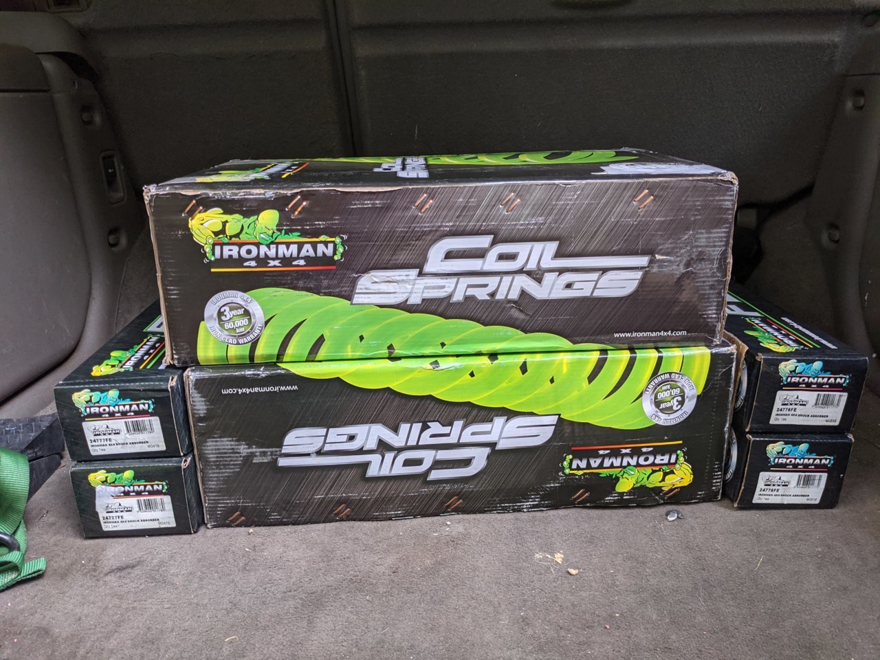

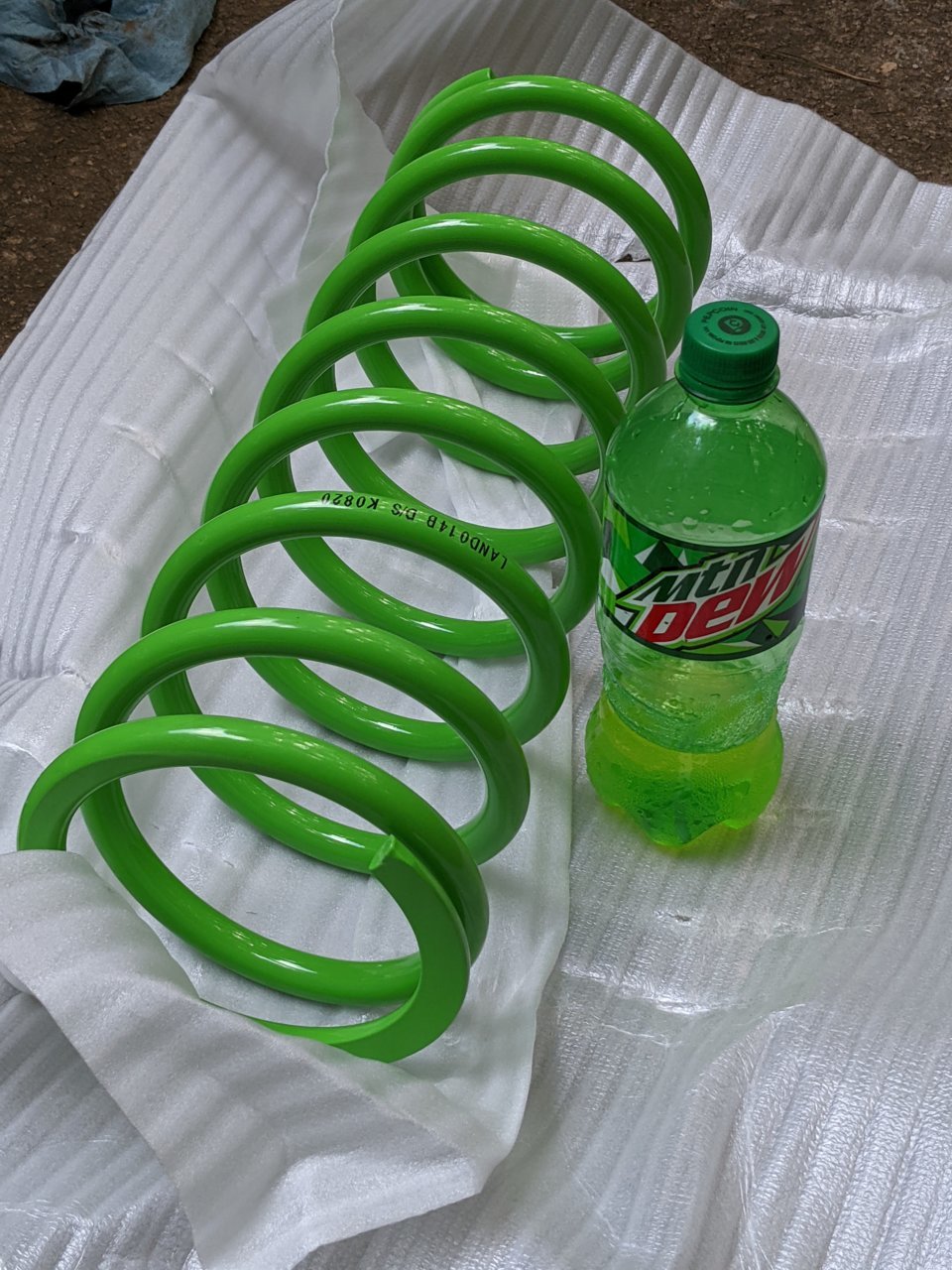

    :cool: new suspension incoming, ironman4x4 foamcell shocks. Should be a nice improvement over stock. :angrygirl: If they ever get here.. Dang Kangaroo post

    Done @HIghlande2 and I knocked it out this afternoon

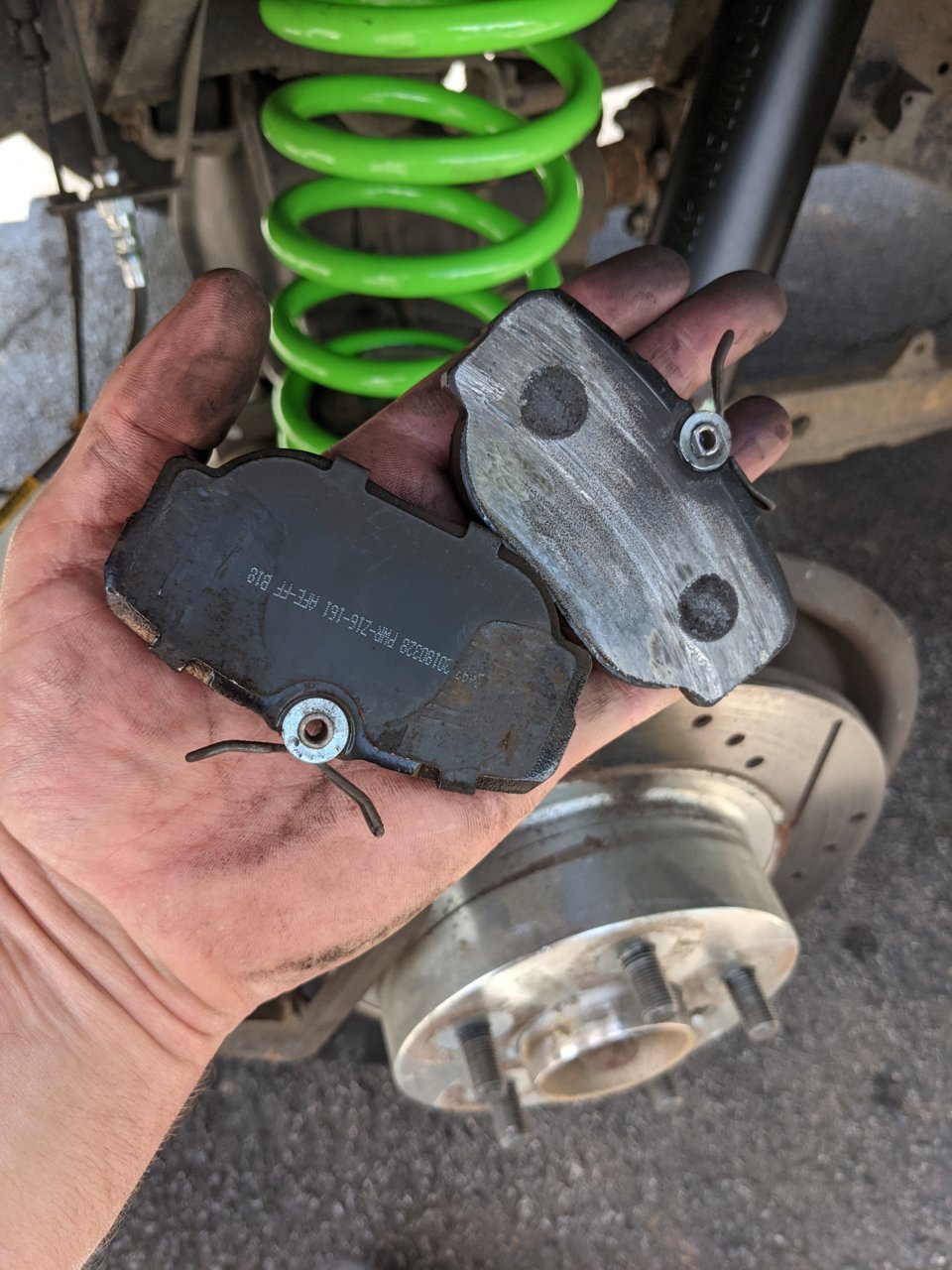

    What's that mysterious grinding noise... Oh I see the silencer pad has worn out. Whoopsies :anonymous:

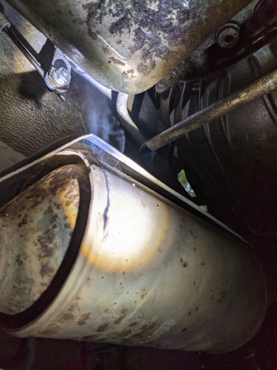

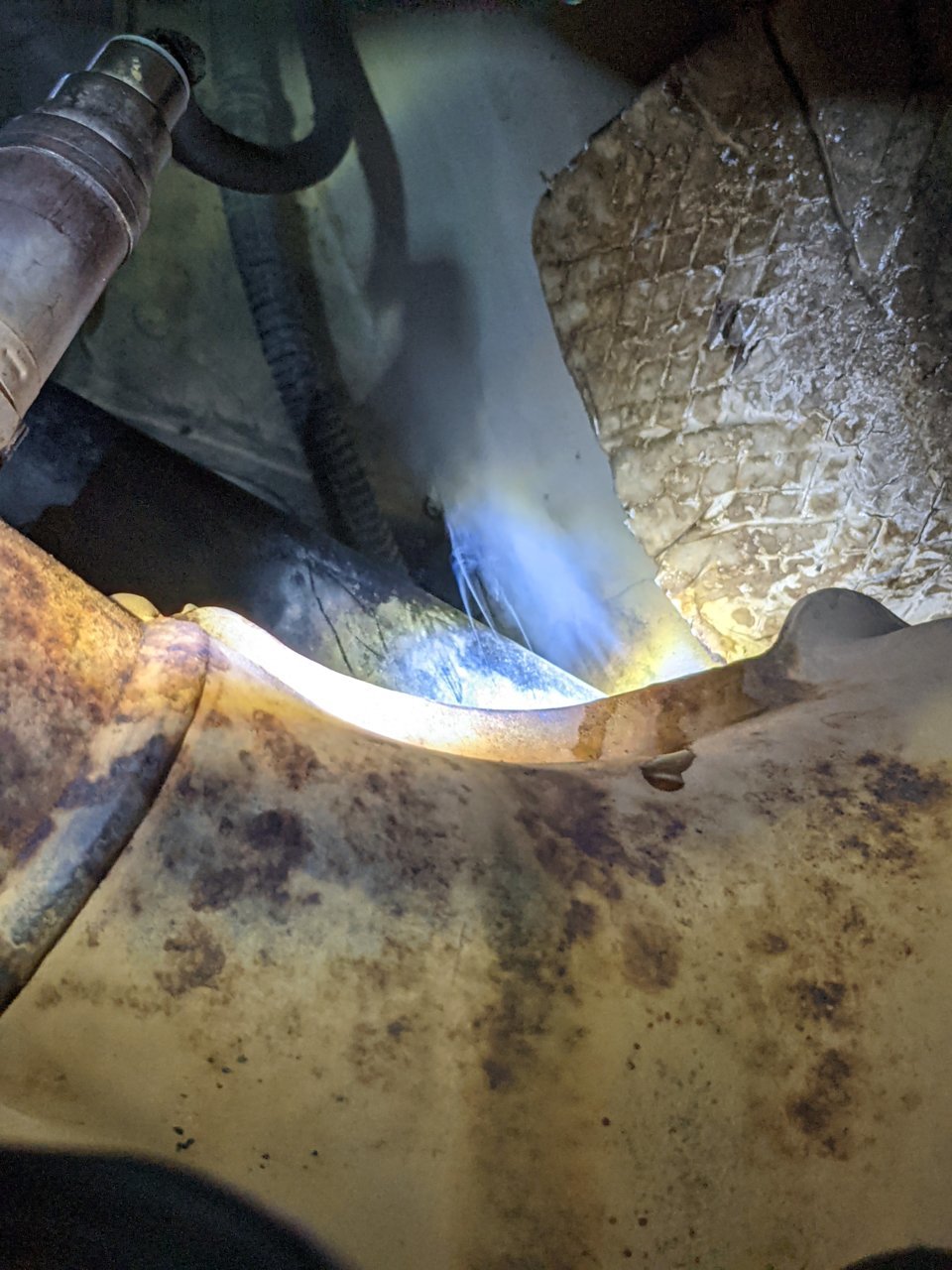

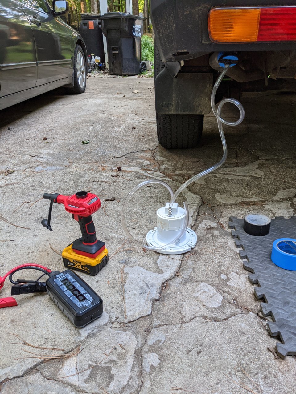

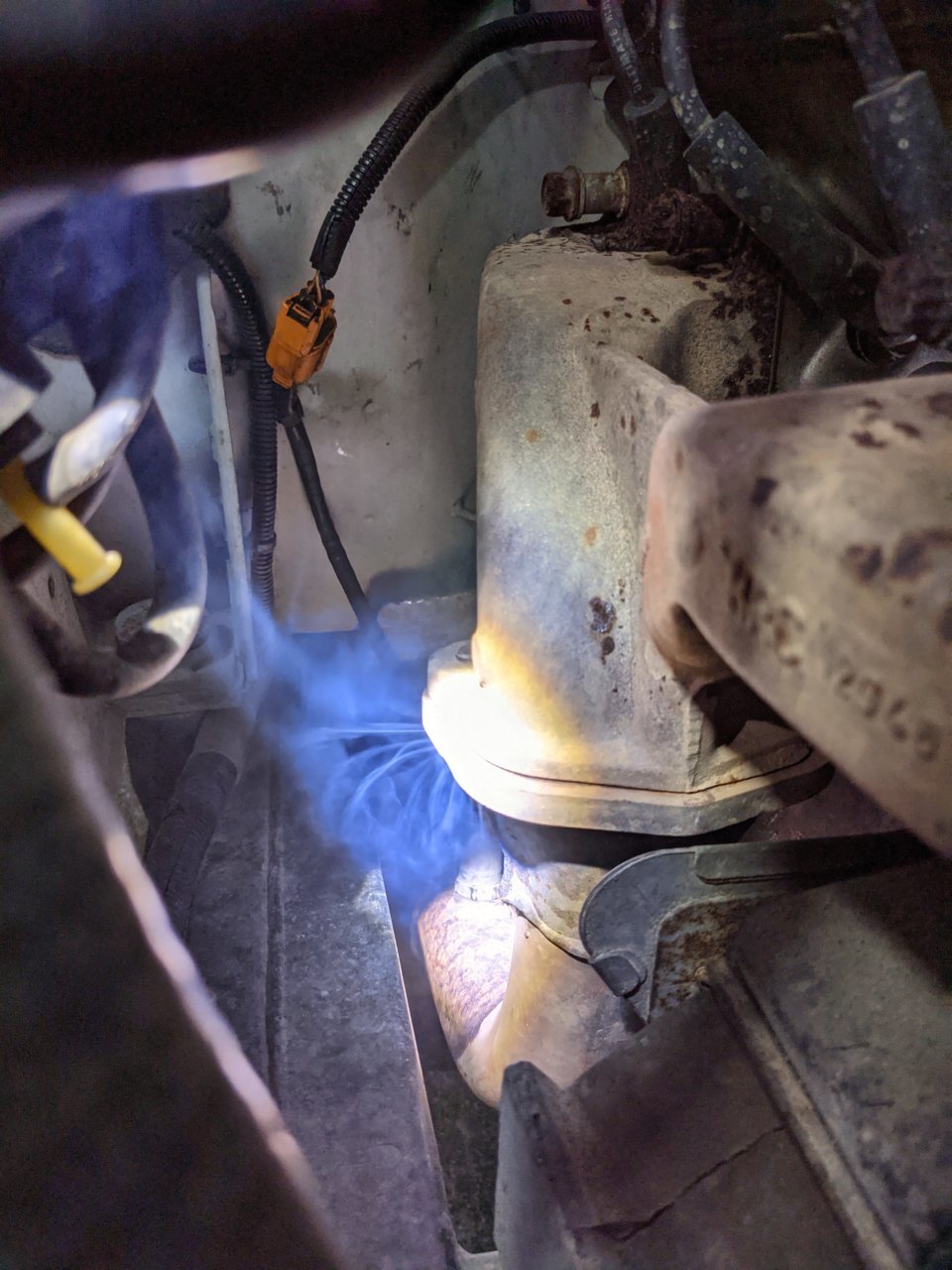

    Might have resolved my pending P0155 and P0154. Built a Mr fusion smoke generator and found an exhaust leak at the manifold to y-pipe connection.
    Pulled apart the exhaust, put new gaskets in, replaced 2 manifold studs, and no more leak. Now there I've found a leak in each cat.... Gonna leave that for now and see if the pending codes stop popping up.

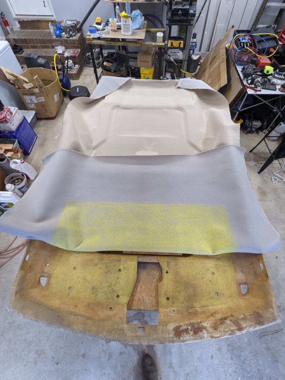

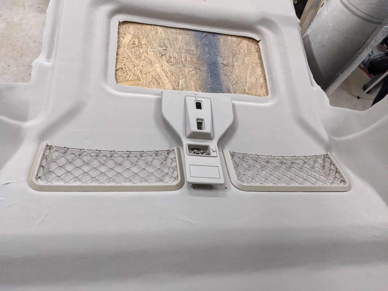

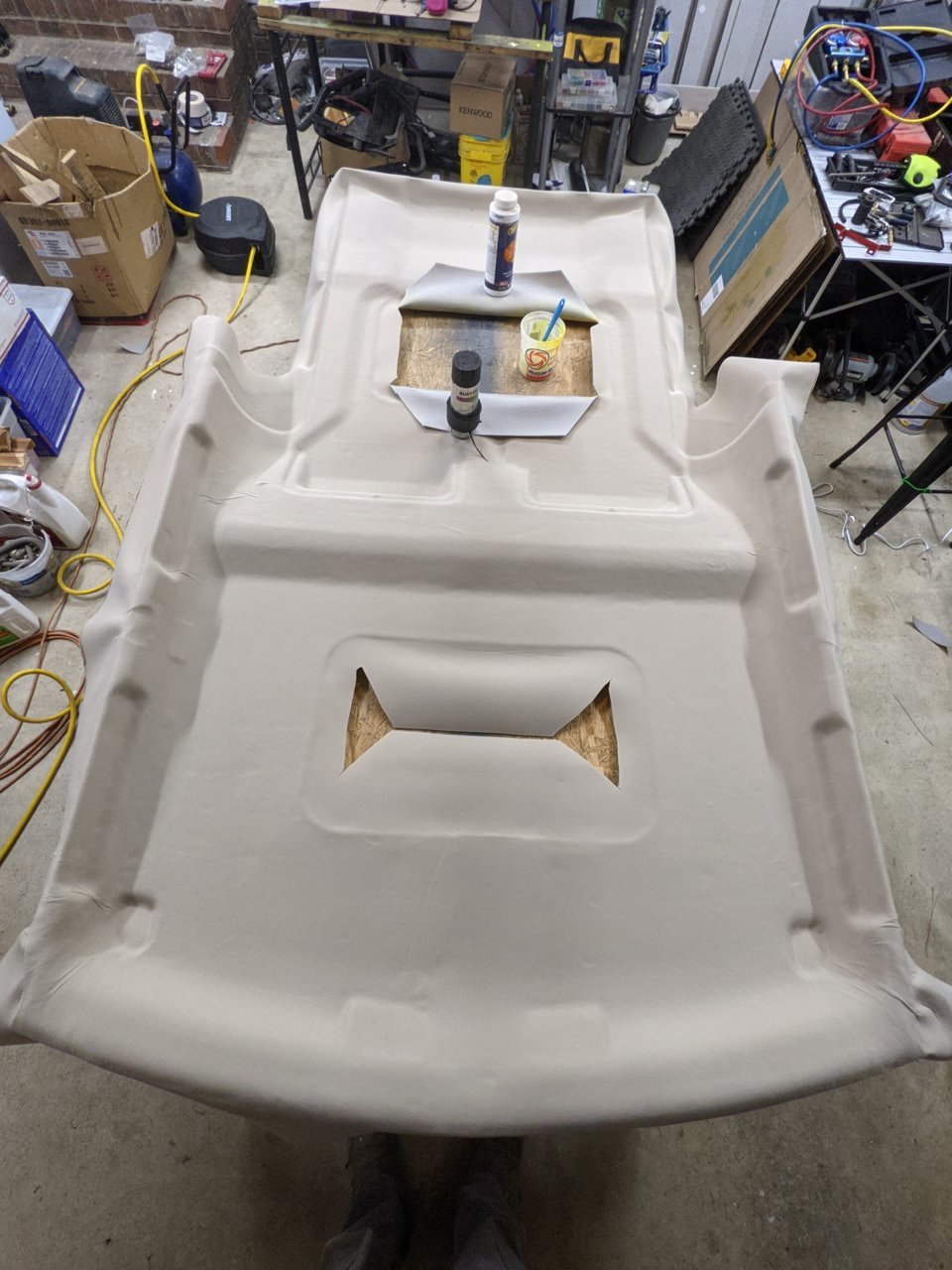

    Finally jumping back over to this headliner.. Put new bungee on the map pockets and now need to cleanup all the trim. Should be able to install this weekend and free up A TON of space in the garage. Just to clutter it up with the Y-pipe to try my hand at Lift Tig to seal up the cats.
