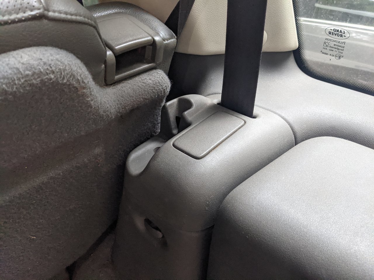

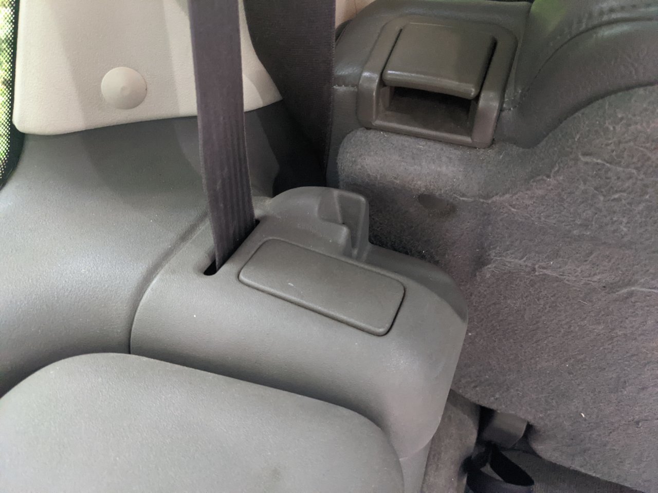

    Just when I get the interior back together it's time to take it out again... The radio thinks there are headphones plugged into the rear seat audio controls, that I don't have.
    It's kind of a cool system. When you plug headphones in the rear the bass(rear hatch door) is lowered and the rest of the vehicle audio is lowered. The main problem is I don't have the jacks/controls to do that.
    Now I'm chasing wiring, starting with the connector that merges the signal wires behind the rear cargo area trim panel I just reinstalled..
    Disconnected
    Connector c0296 rear cargo area, no change
    Connector c0486 driver kick panel, no change
    I need to pull the radio and clean up the buttons and knobs anyways..

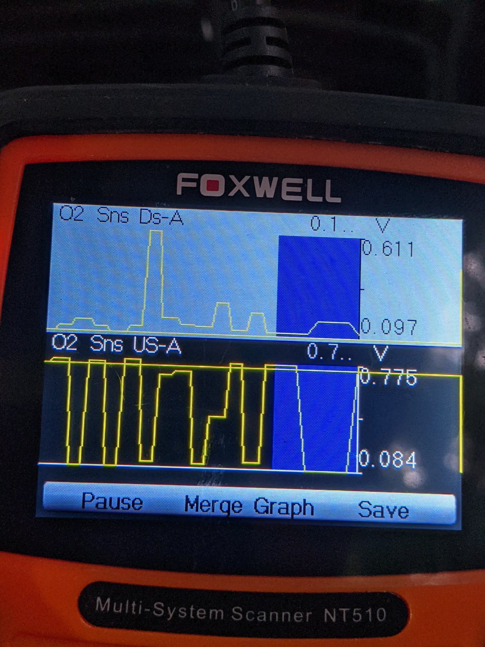

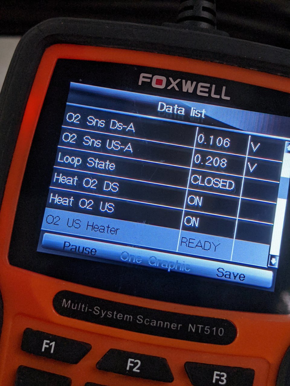

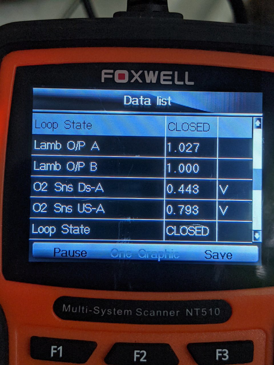

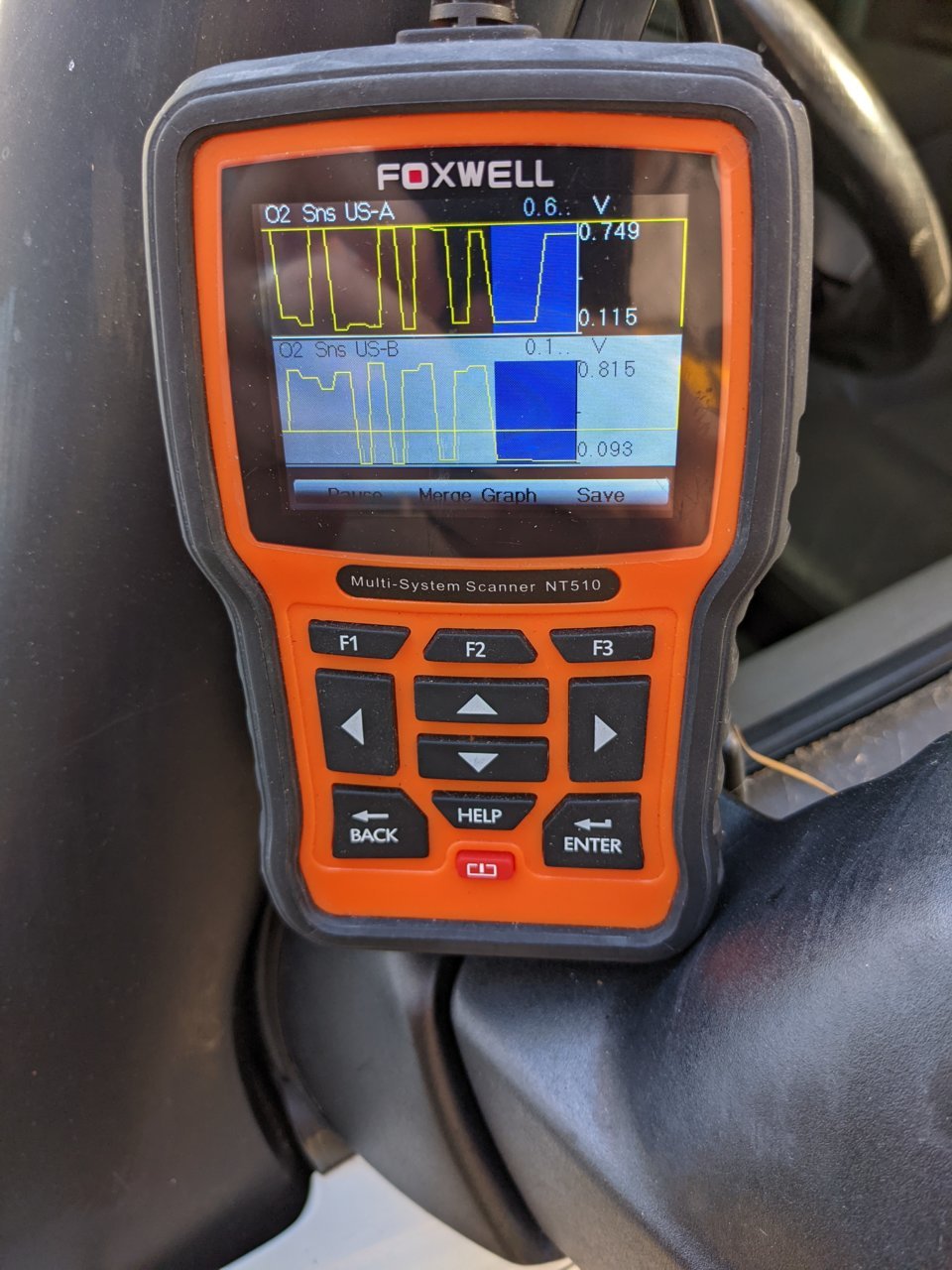

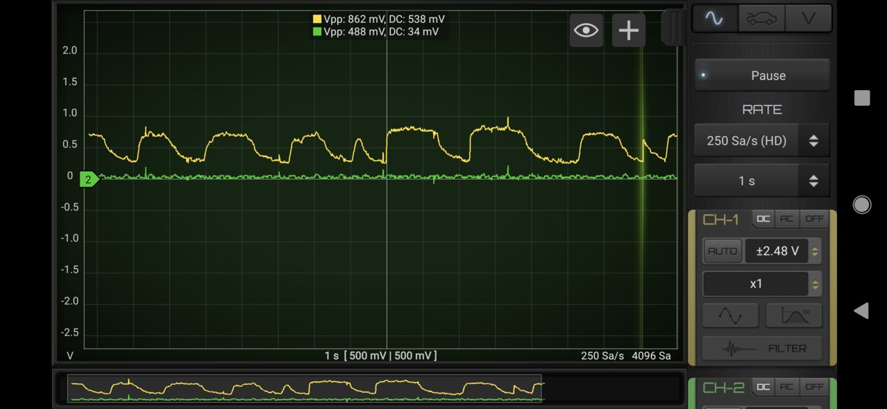

    From one annoying issue to another...

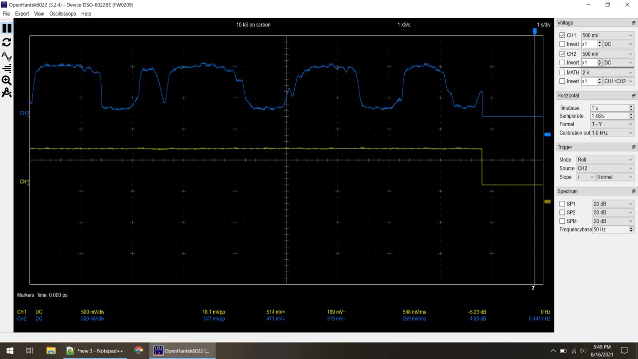

    P0154 - O2 sensor circuit no activity detected (bank 2, sensor 1); Front sensor RH bank open circuit
    The forums are all back and forth if Bosch O2 sensors(factory) are good or bad. So I ordered some Walker brand ones. I also ordered a Hantek6022 usb oscilloscope to help diagnose what the sensors are doing directly too.
    The new O2 sensor is acting exactly like the old one. Based on previous tests the wires are intact between the ECM and Oxygen sensors.

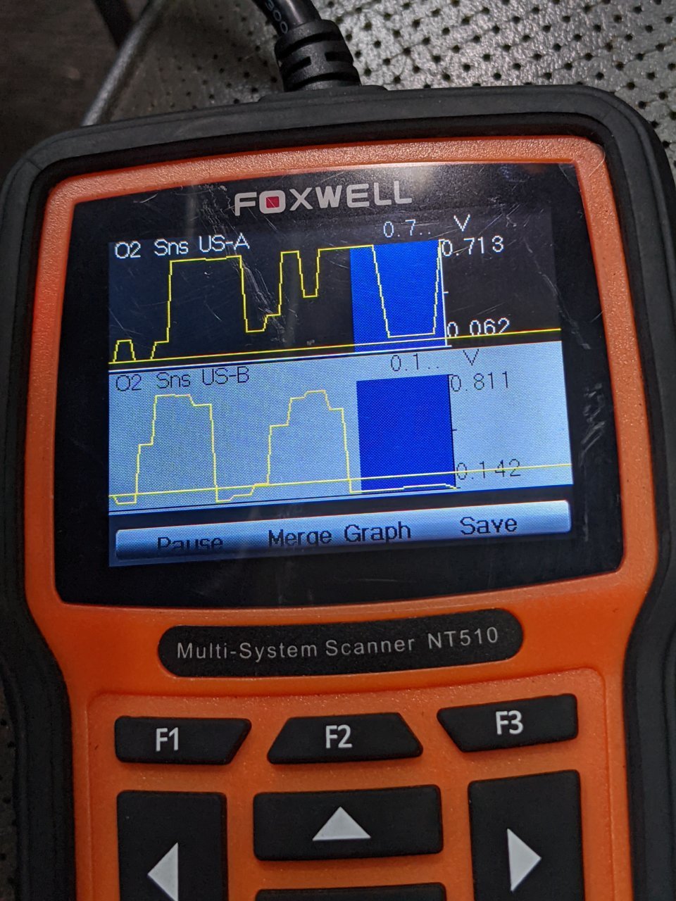

    The driverside is fluctuating normally while the passenger side is stuck at about 400-500mv. The odd thing is the OBD reader shows more fluctuations above and below those values sometimes, but the scope stays steady. (OBD reader O2 Sns DS-A is the passenger side and O2 Sns US-A is driverside)

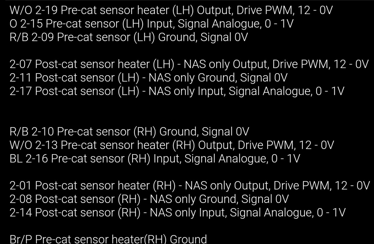

    Some googling found these excerpts.
    Time to check grounds inside the ECM..
    O2 sensor wiring colors
    Edit: nope, DS is downstream and US is Upstream

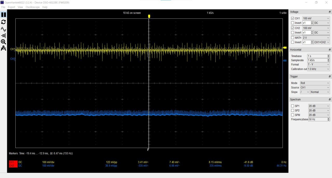

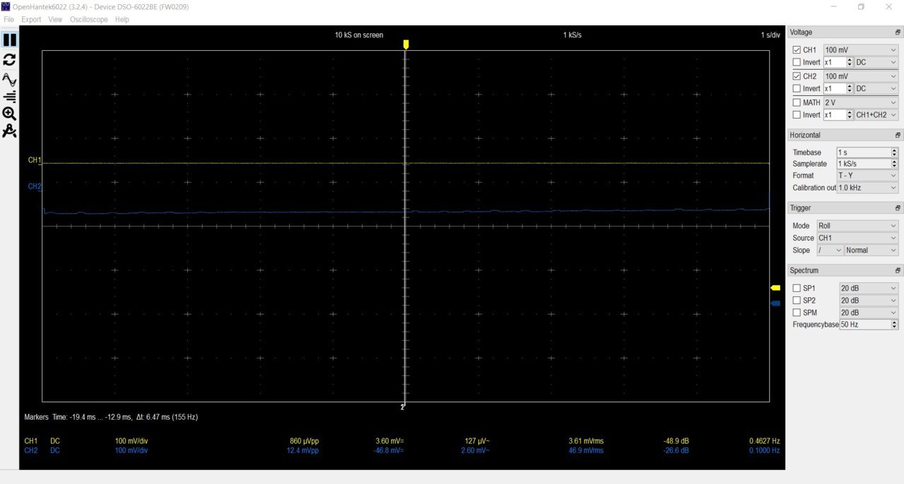

    More oscilloscope readings on the ground side of the signal circuit resulted in nothing helpful..
    Yellow = driver side = working
    Blue = passenger side negative ground? Maybe the ECM trying to compensate for the steady signal?
    Key off engine off, still a negative ground...?

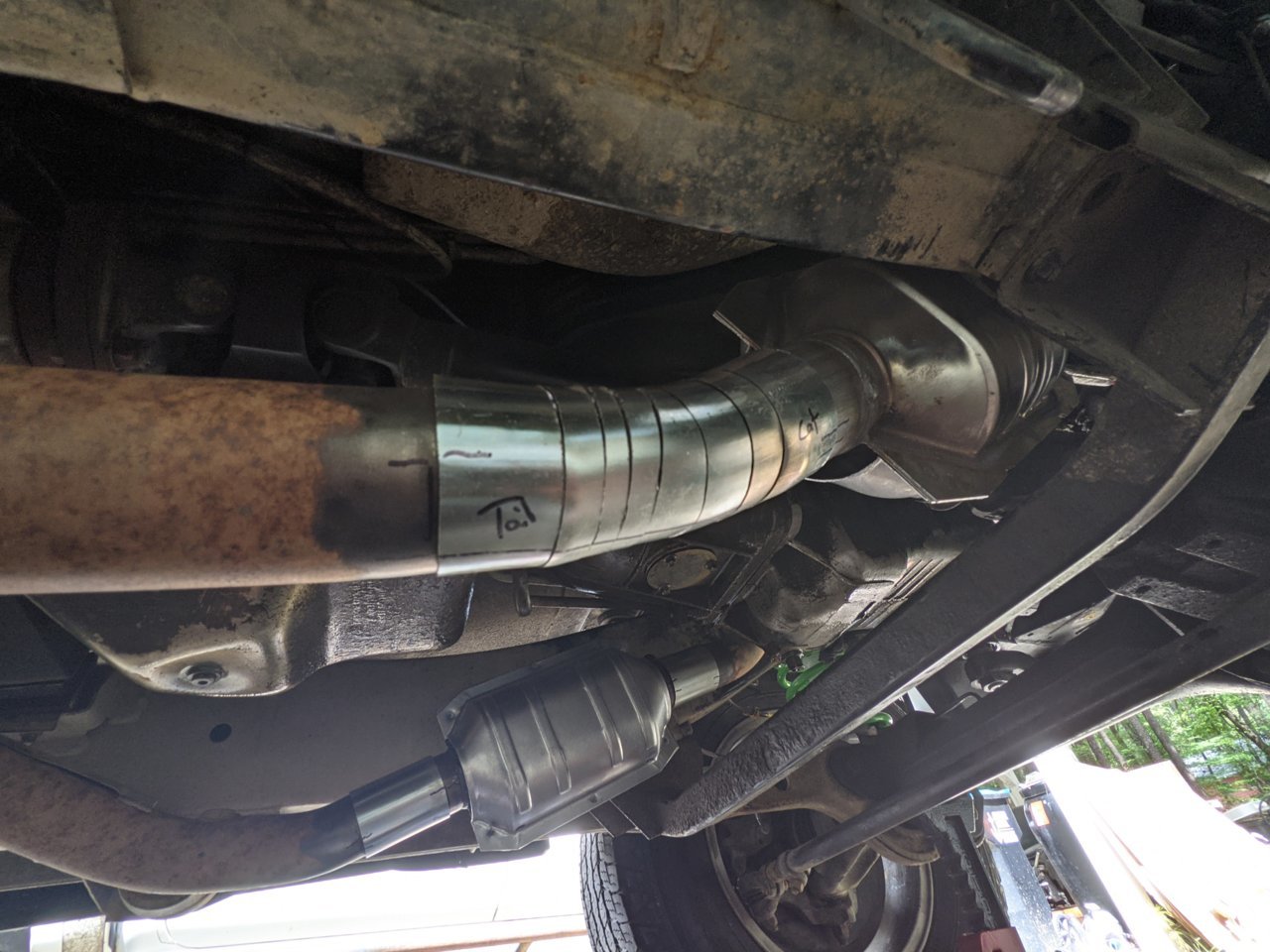

    Pulled the Y-pipe to weld up the cracks and as I was moving it around to wire wheel the areas clean I heard rattling.. Got the borescope out and found some chunks turned sideways. So I look dup new cats and magnaflow has em for $188 each with a partner recycling program up to $75 back so I ordered them. Got to looking around online and found a recycling company that quoted $953 but wanted me to pay to ship to Malaysia.. Rrcats.com quoted $775, facebook (licensed) buyer Crispin Metal Recycling said $800.
    Crispin came to my place to pick them up and said "no this no good, is broken".. We negotiated and he gave me $680 then he hucked them into his truck bed... I guess that shows how much being broken matters, the not broken one is now probably broken.

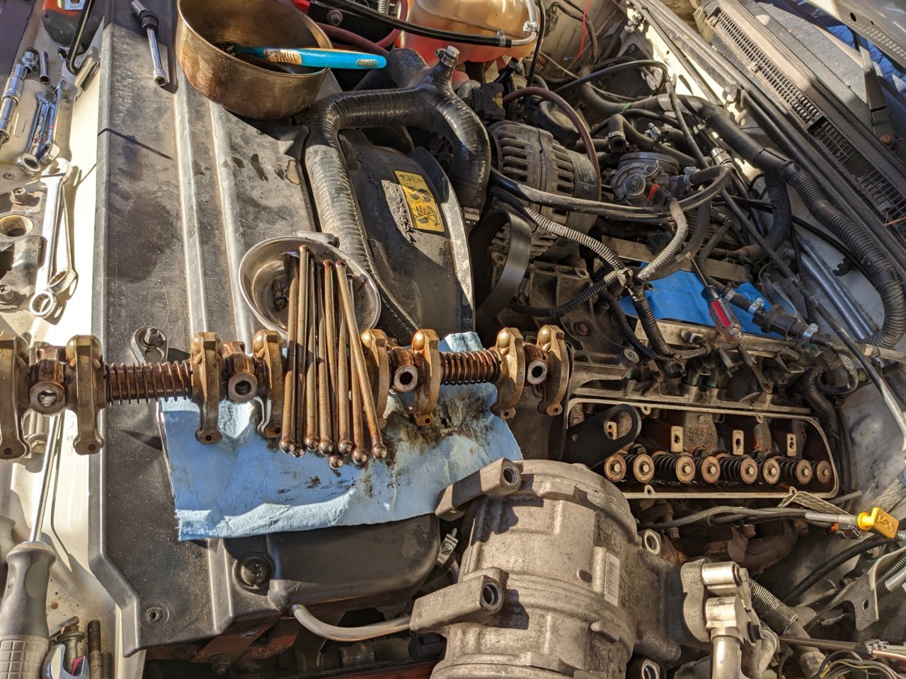

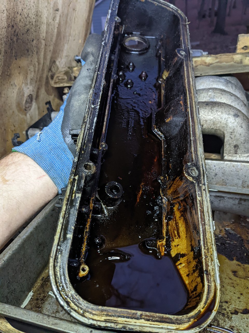

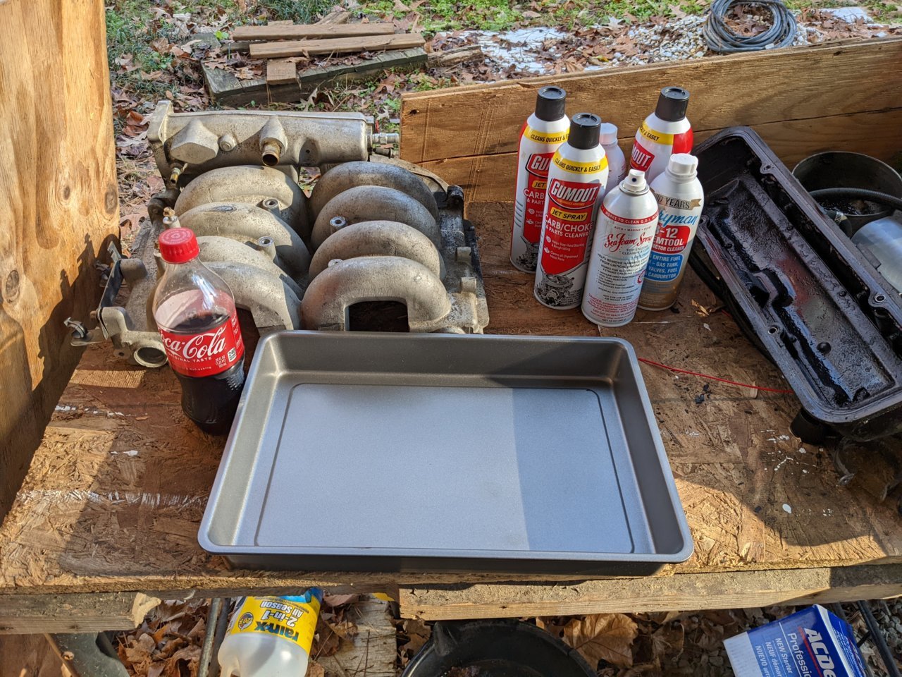

    Well, this is a bit worse than I was expecting.. Back to Walmart for more seafoam spray, Berrymans carb cleaner, and a tray to soak everything in.
