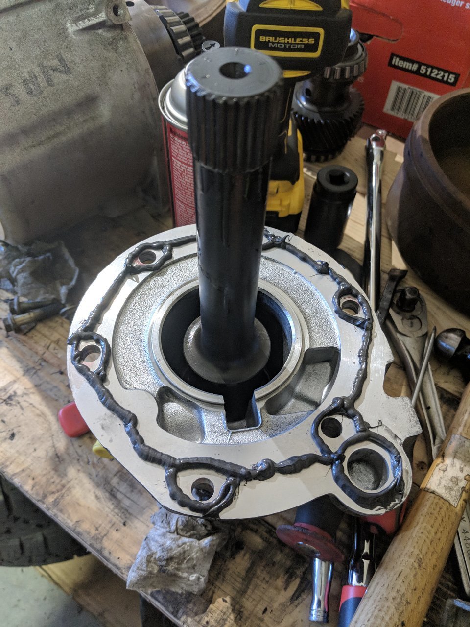

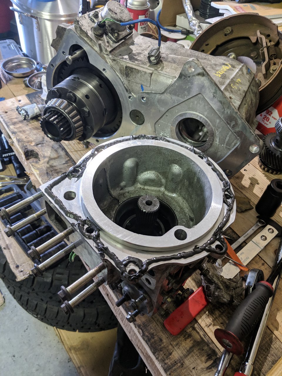

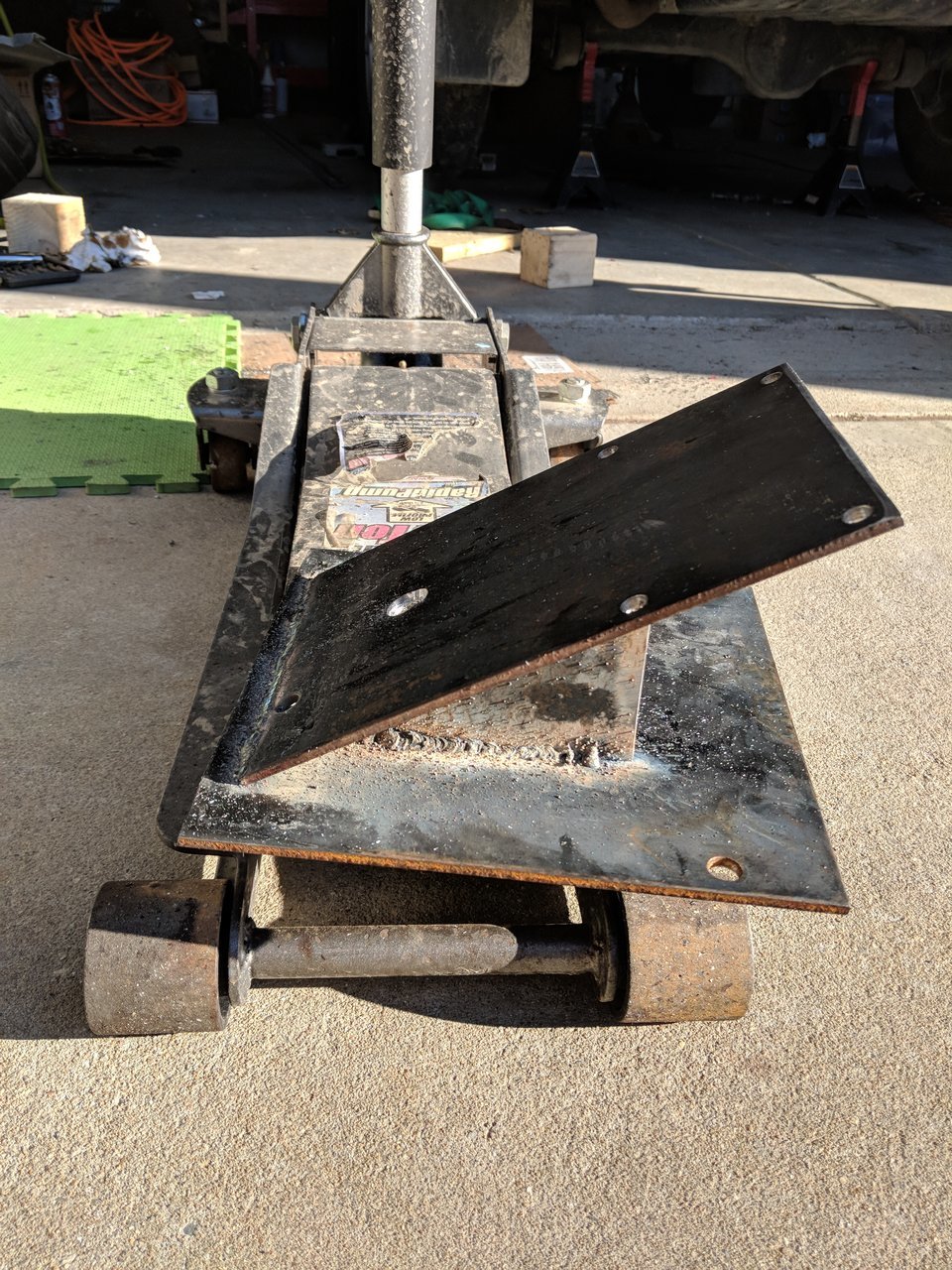

    Now we need to see if my welds hold up :eek:

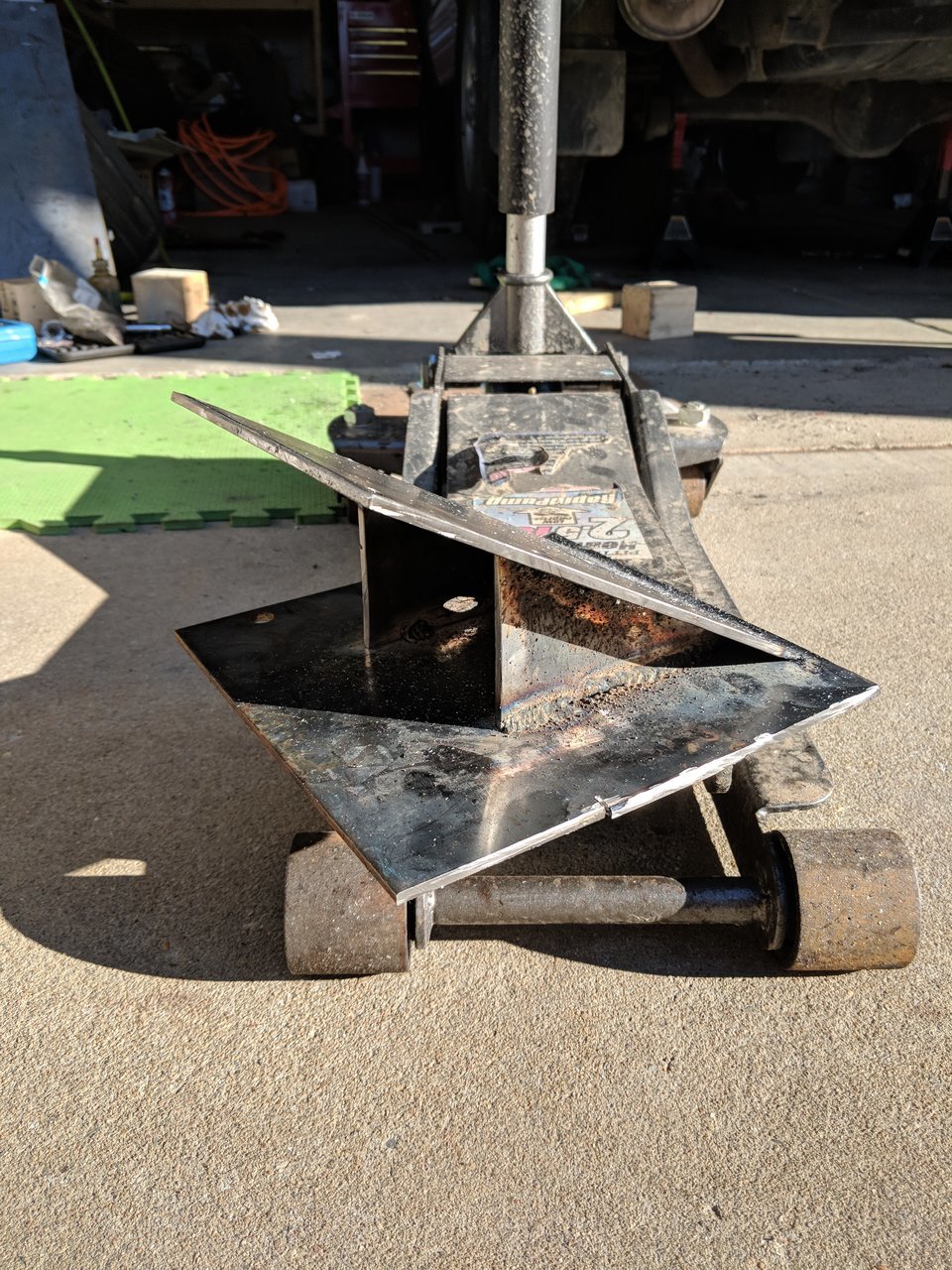

    Killed a hole saw bit(blade?) then used my pencil die grinder to finish out the jack bolt hole.

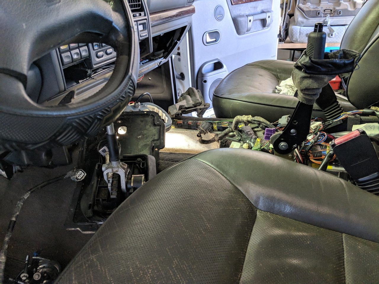

    These connectors don't seem like they're hard to get to but the shifter, steering wheel, and seat are in the way.. Can't get both arms maneuvered to get my hands in there. Then you got the parking brake handle trying to poke your eye out!

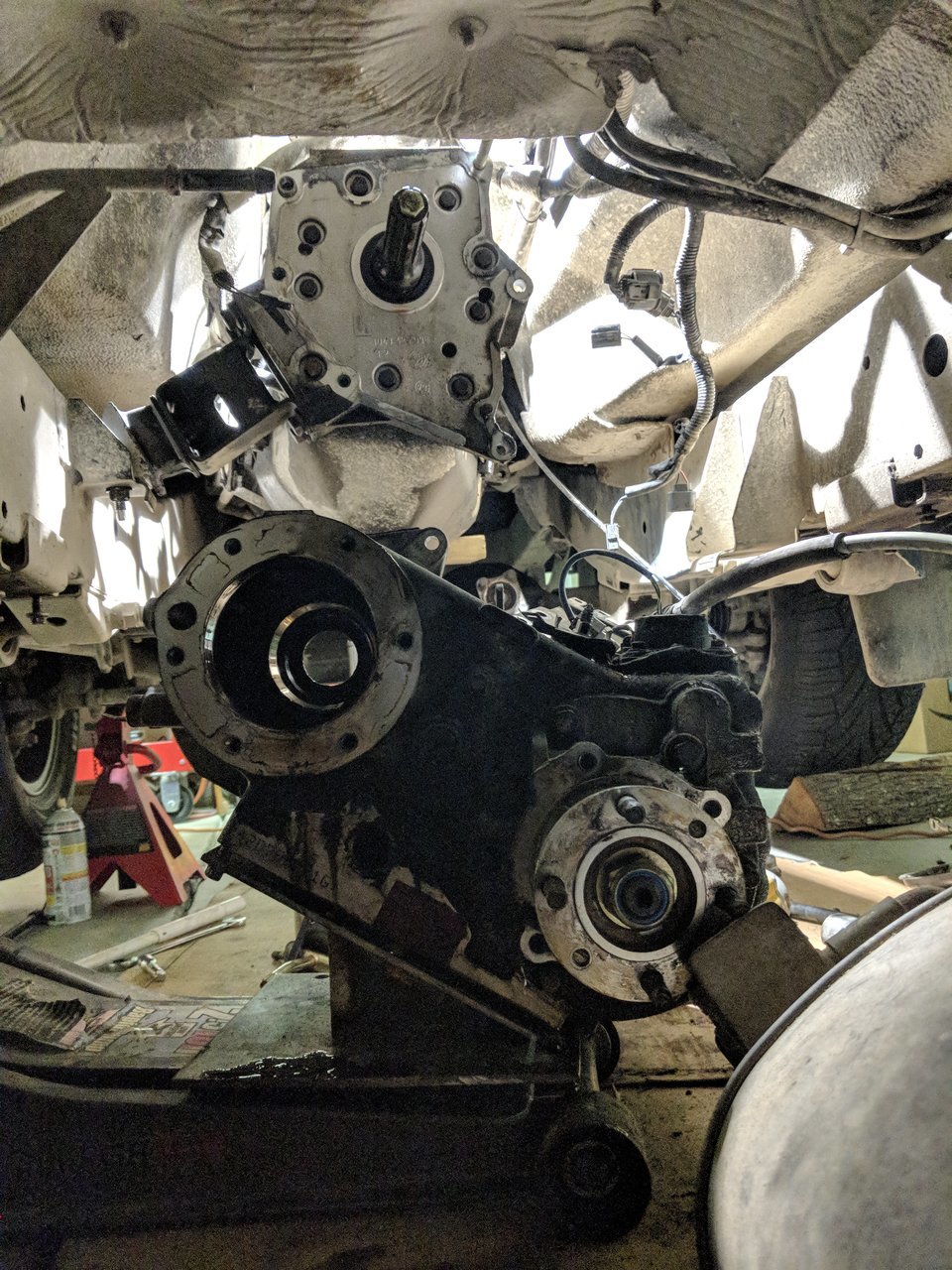

    And it's out, ugh

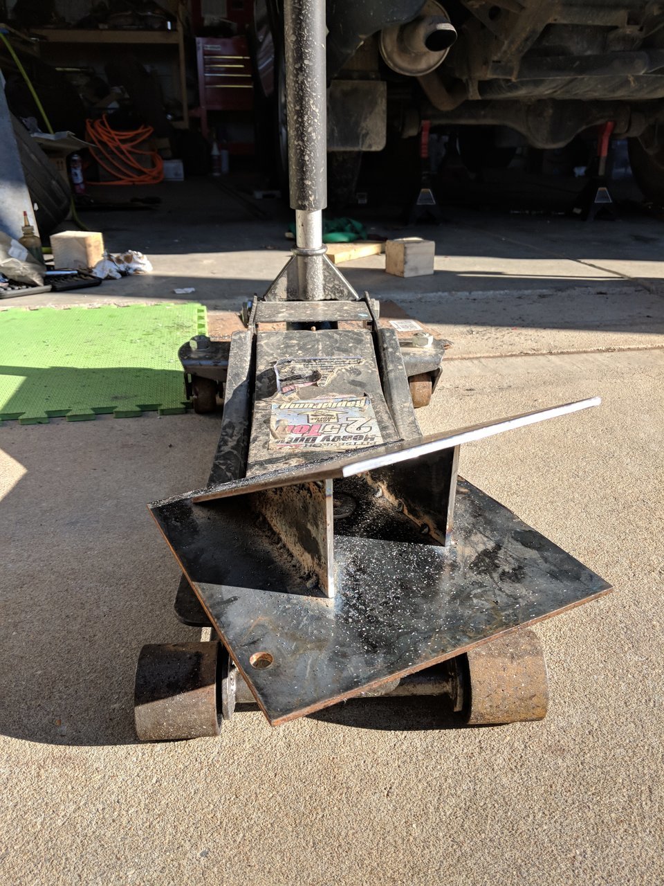

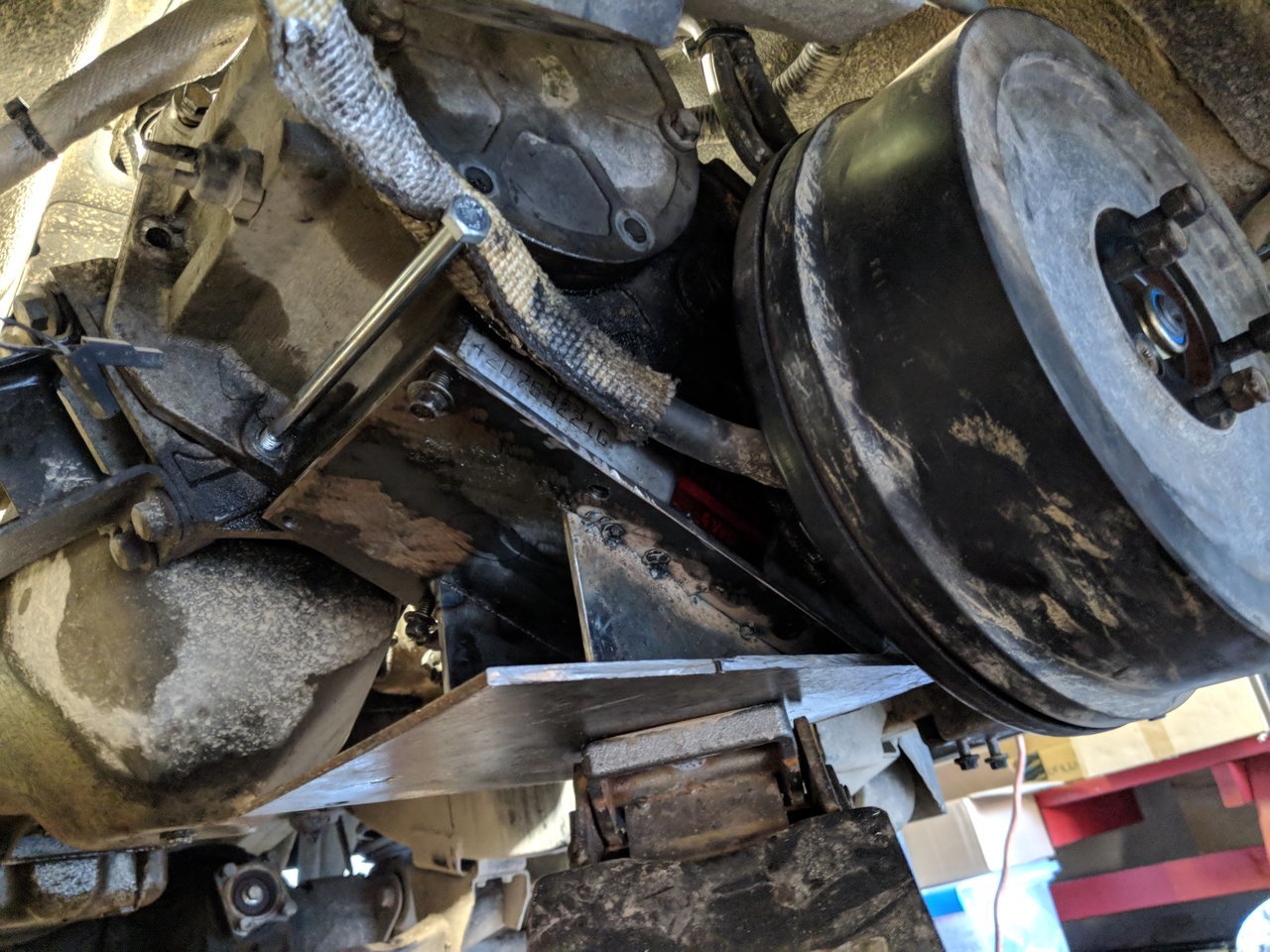

    So it looks like the homemade jack adapter worked as advertised :thumbsup:

    Yup, never expected otherwise. The plans are straight out of land rovers workshop manual.

    Yay my welds held up :thumbsup: looks like the holes weren’t exactly lined up but 2 bolts is prolly fine

    Yea. I'm gonna drill out the holes a size bigger, it might make it easier to reinstall pulled tight to the support.

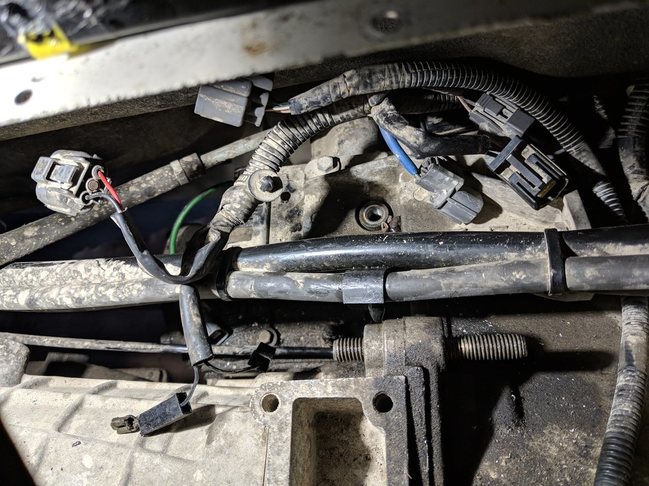

    Last but on the T-case before install. Removing the T-case mounted interlock solenoid(neutral safety switch) in favor of the shifter mounted interlock solenoid.
