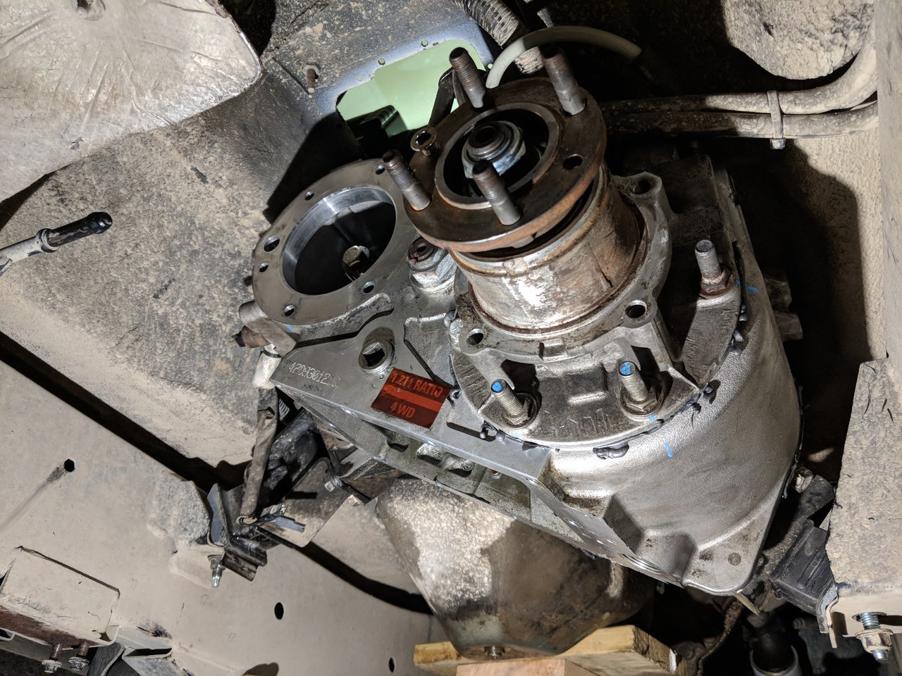

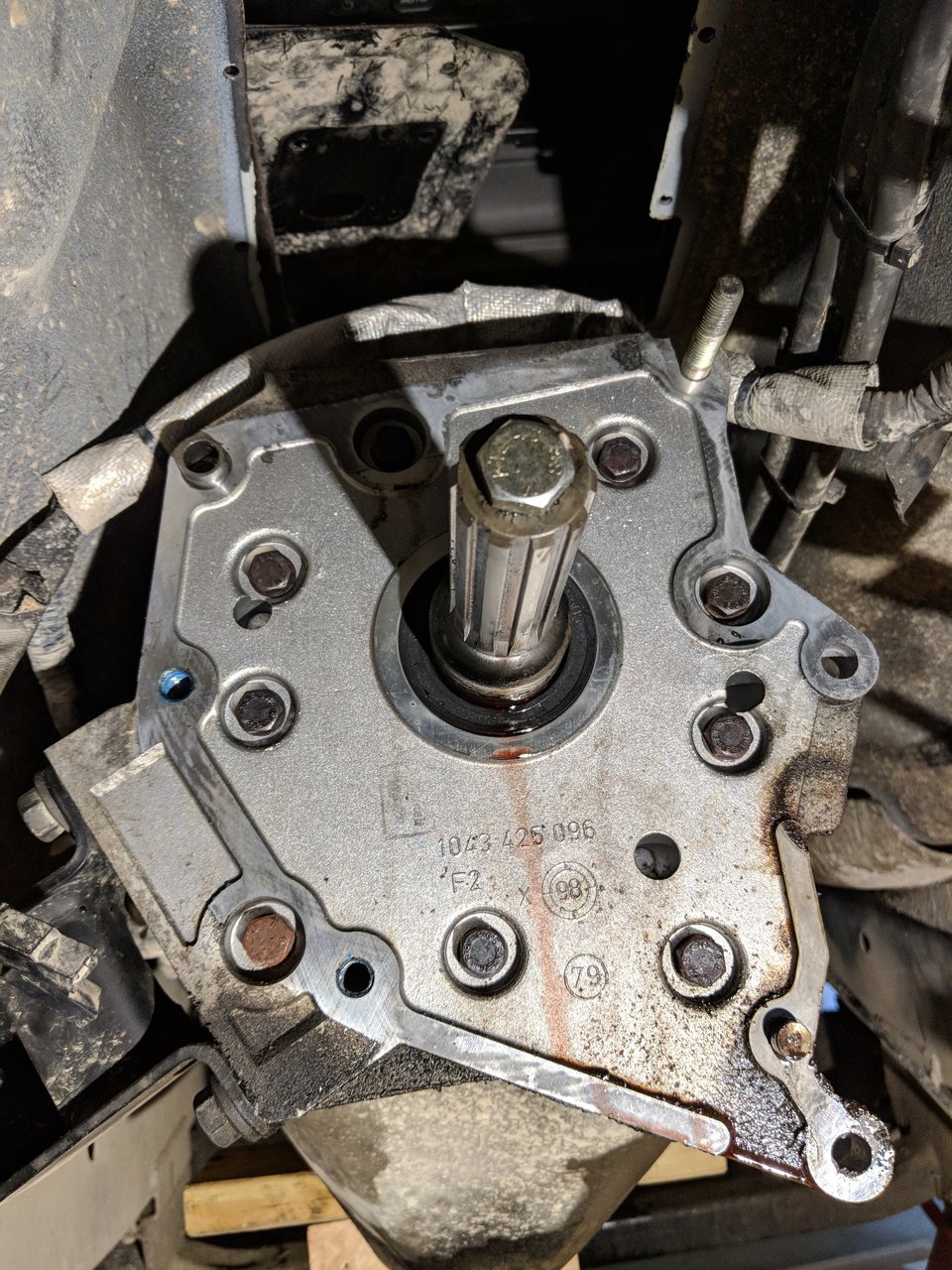

    Pulled the Transmission output seal, replaced it while I could, and installed the T-case with new rubber mounts. Thanks again @diverdale for welding up the jack support.

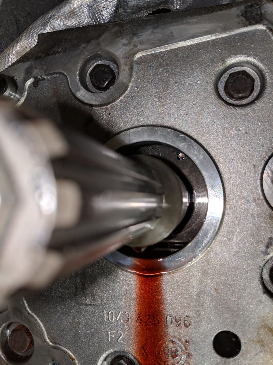

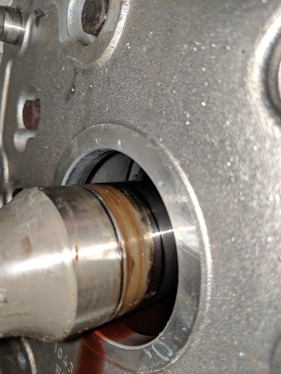

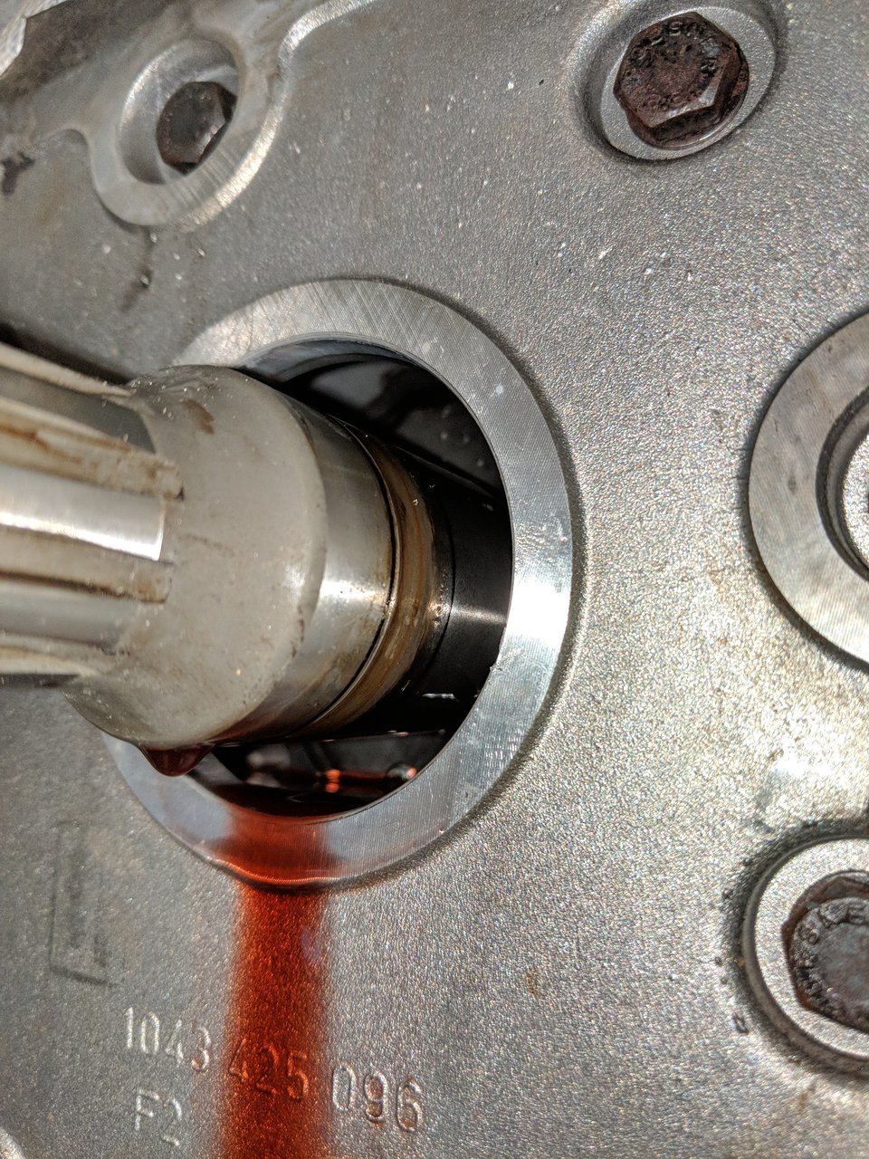

    you polish the crap off the shaft before you installed new seal ?
  5. Dec 18, 2017 at 8:01 PM
    #65
    Sandman614
    Sandman614 [OP] Ex-Snarky TWSS elf, Travis #hotsavannahdotcom
    Oct 26, 2010
    #45273
    36,034
    Tim
    Garner, NC/Boone, NC
    '06 SR5 Off Road
    yes. Trans fluid looks good, although a little low now.

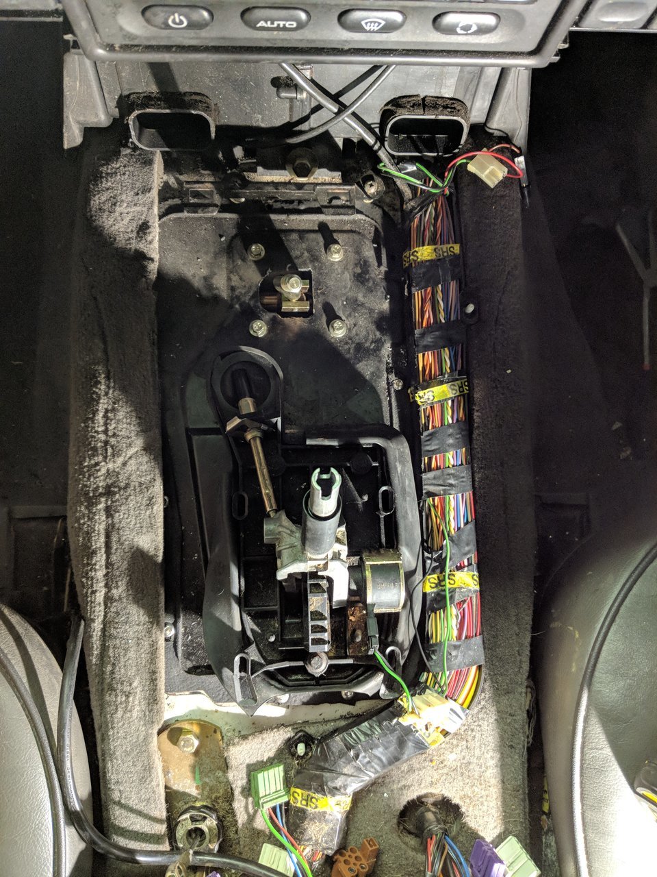

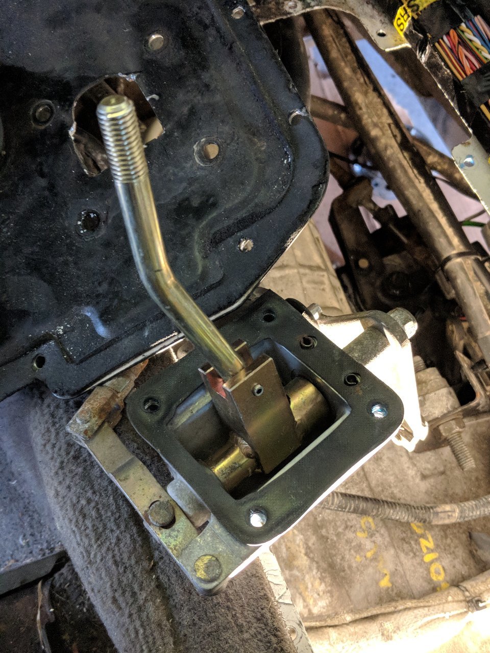

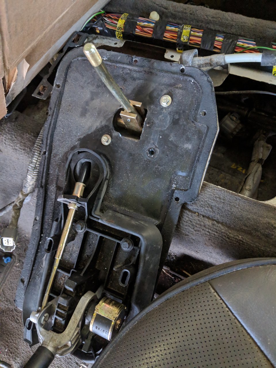

    Had to resize the hole for the new shifter, and missing a few pieces of skin from installing the wiring and shifter connections through the awkward trans tunnel hole.

    T-case should be completely resealed now, unless I forgot something... Shit I forgot about forgetting things..
    Tomorrow I'll start the bolt up of the parking brake, driveshafts, exhaust, and cross members, after I refill the T-case and make sure it holds oil.

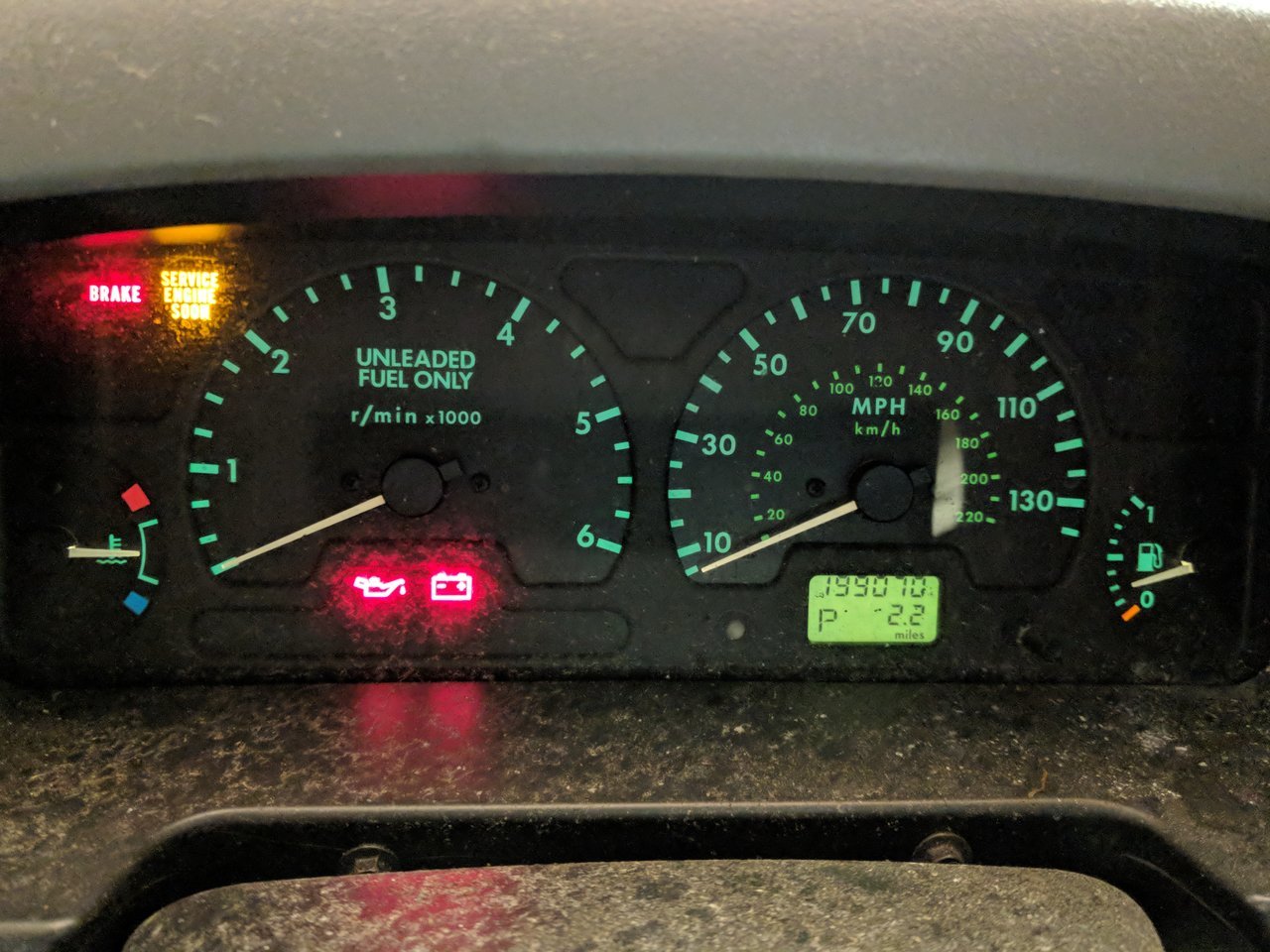

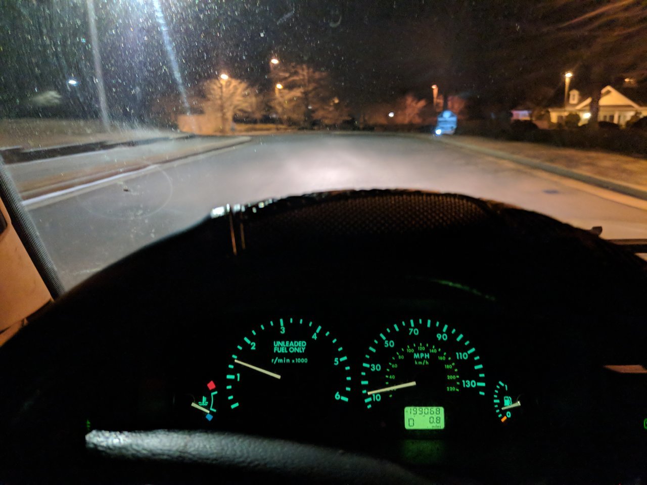

    Yup seems to be
    199,068 miles #firststeps #SecondLife

    Ah, the view every Rover owner is acccustomed too..... :eek:
