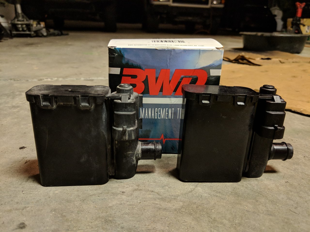

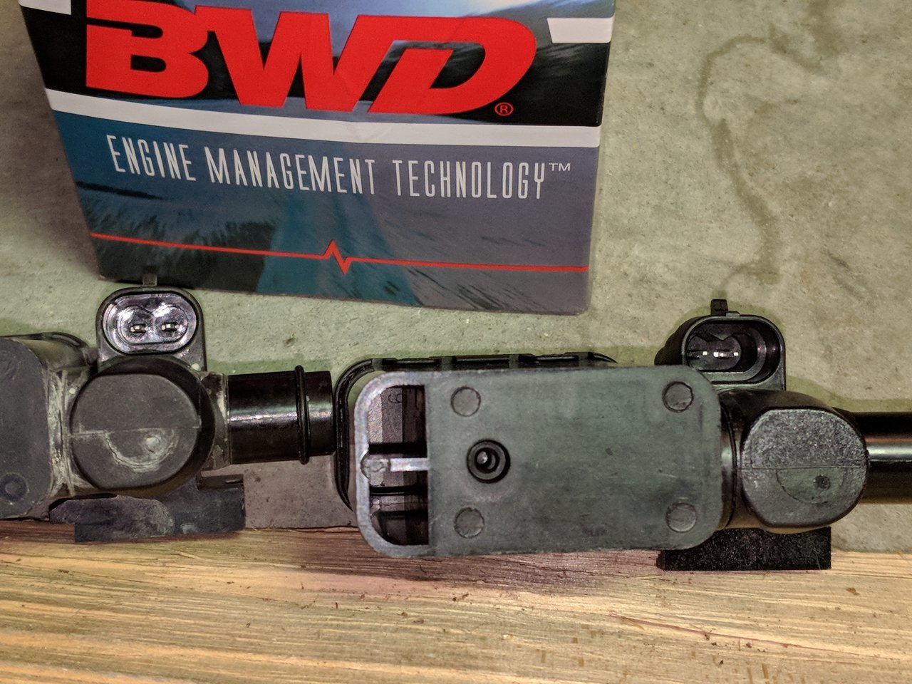

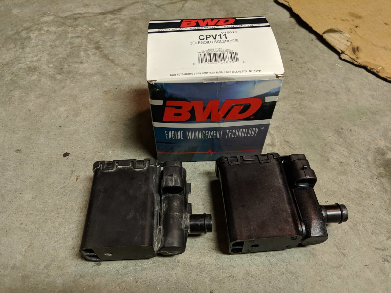

    Working out how to fix the CEL p0446/p0447, poking and prodding at wiring yay. One last check before I determine if the vent valve is bad.
  17. Jan 9, 2018 at 2:26 PM
    #97
    Blkvoodoo
    Blkvoodoo a Hooka smoking caterpillar has given me the call
    Jul 23, 2015
    #160098
    4,187
    Kevin
    Near Clayton NC
    08 PreRunner SR5 DCSB
    Vent for what ?
  18. Jan 9, 2018 at 8:00 PM
    #98
    Sandman614
    Sandman614 [OP] Ex-Snarky TWSS elf, Travis #hotsavannahdotcom
    Oct 26, 2010
    #45273
    36,035
    Tim
    Garner, NC/Boone, NC
    '06 SR5 Off Road
    (charcoal) Canister Vent Solenoid
    This is why land rovers are considered 'exotic' cars.. A vent solenoid this major rover parts supplier wants $500 for, normally they have aftermarket options at good prices when they are available. This was a fluke that I found the GM version and it's exactly the same! So hopefully if any other Discovery 2 owners have a p0446 or p0447 and decide to replace the CVS they might see this alternative.
    $500 - http://www.roverparts.com/Parts/WTY000020G
    $25 - https://shop.advanceautoparts.com/p/bwd-canister-vent-solenoid-cpv11/10101064-P

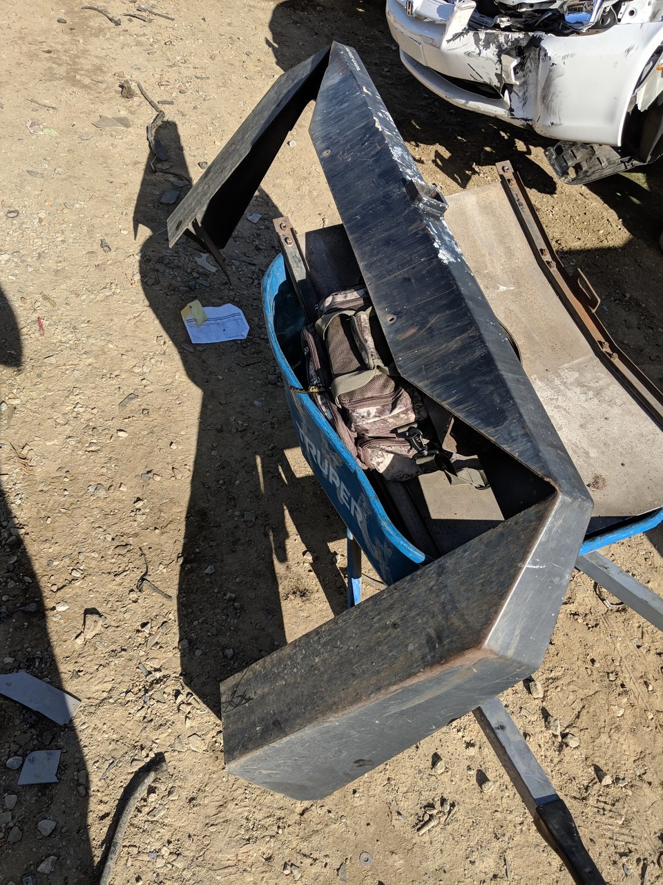

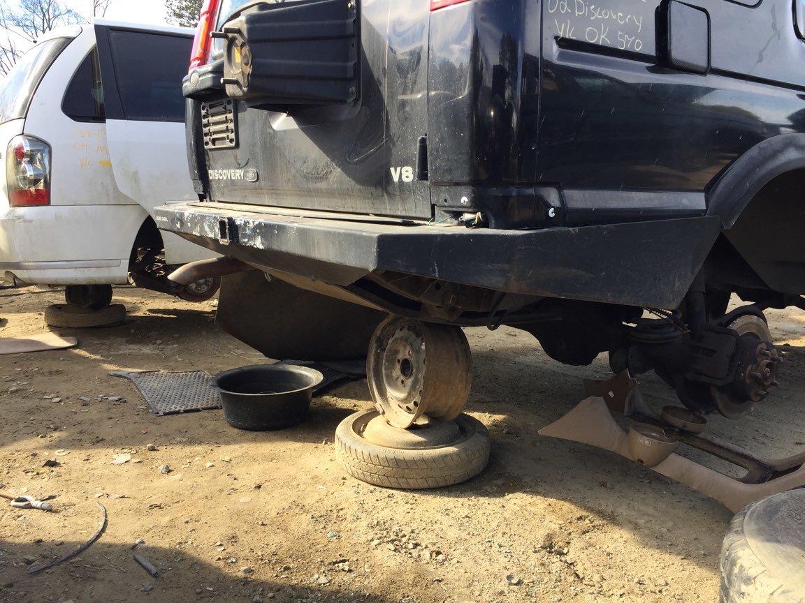

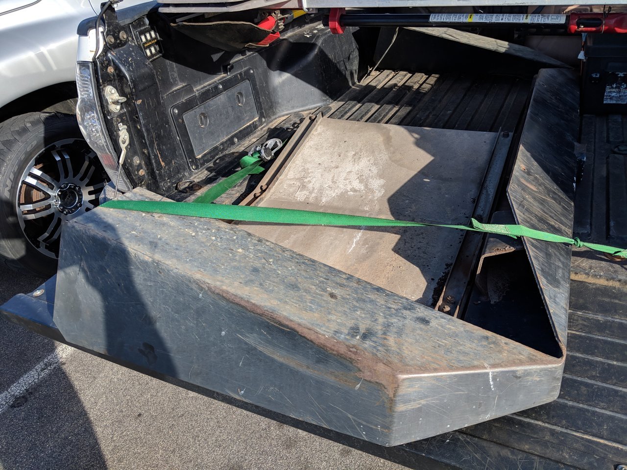

    @Taco_life hooked me up! Spotted this high clearance bumper and gas tank skid in the junkyard.
