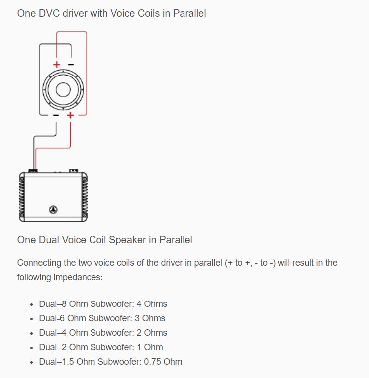

    Playing speakerboxx today. The new speakers I bought are dual 8ohm voice coils, so I will have to wire them each in parallel to they run at 4ohms to match the factory subs.
    Harmon Kardon amp has four channels in from the headunit, and 8 channels out.
    2 channels run the two subs (2x 4ohm)
    2 channels run the front woofers (2x 4ohm)
    2 channels run the rear doors (both woofer and tweeter)
    2 channels run the front (midrange and Tweeter)

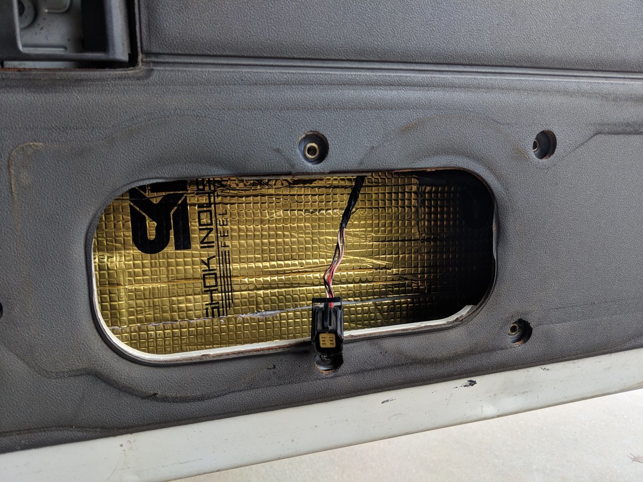

  12. Jan 28, 2018 at 6:35 PM

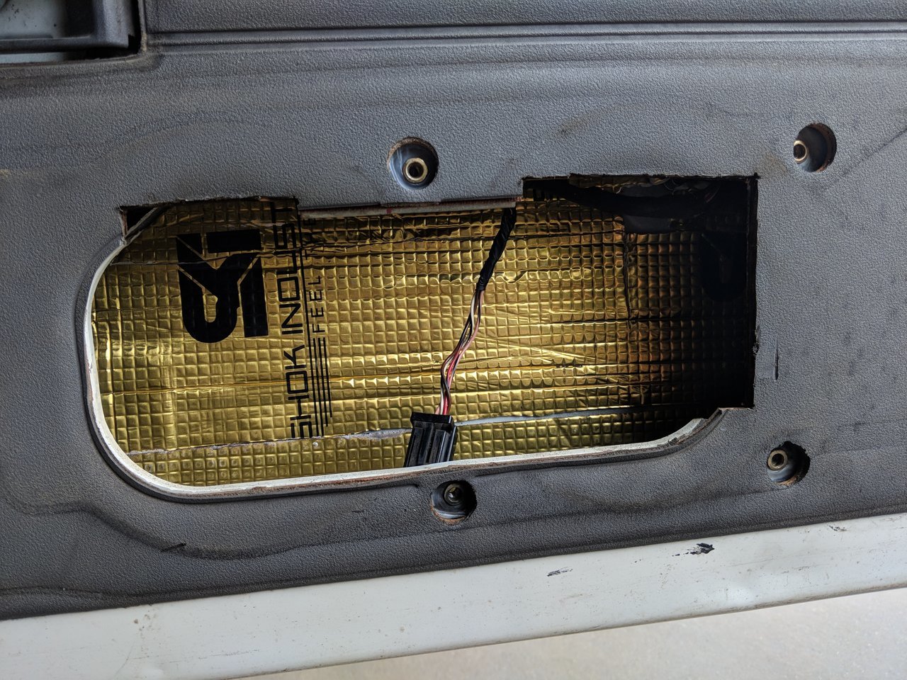

    No pics... But had to cut the door for the slightly larger speaker magnets to fit. Now i have to open up the hole on the door panel. Hell I even added some sound deadener while i was in there.
    Edit: pics of the door panel cut before/after

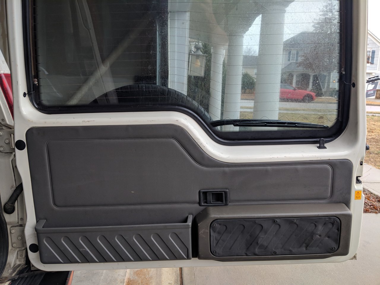

    Rear door, speaker replacement complete.

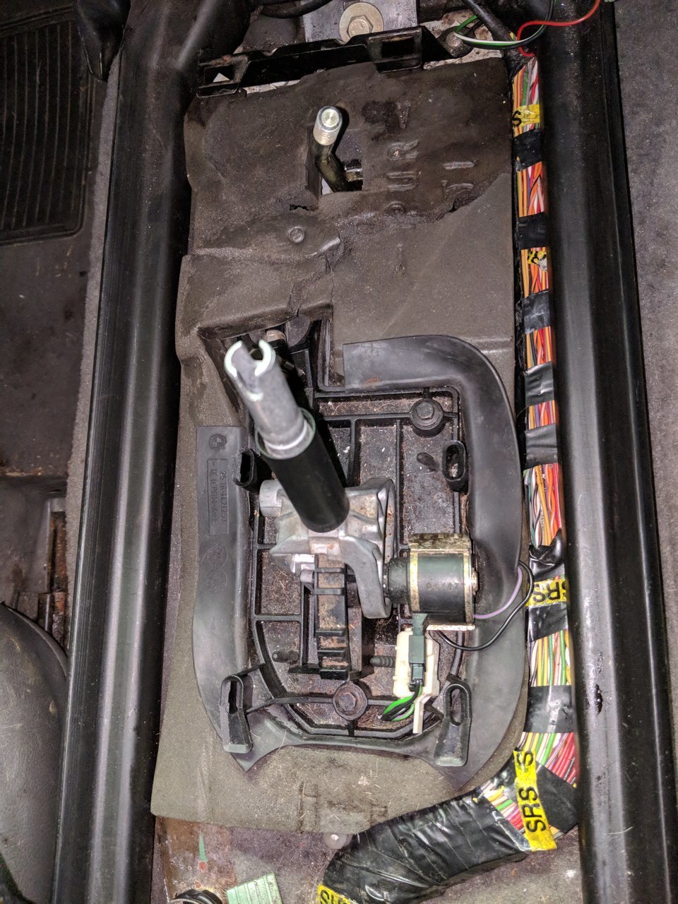

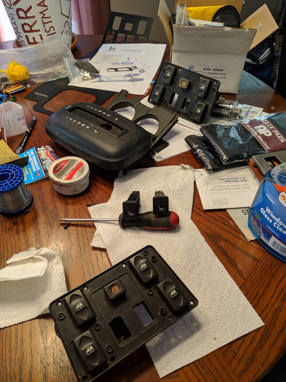

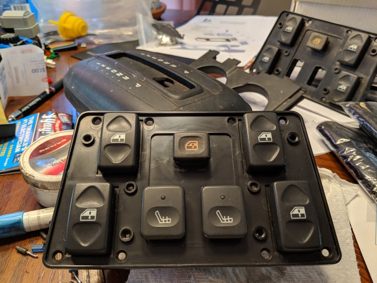

    Slowly working on getting the center console back together. Decided to reuse the old foam cut to fit the new shifter.
    Stupid owners selling the house were renting..
