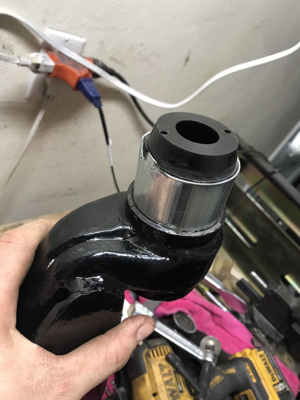

    I purchased whiteline's lca bushings that they advertise on their website for second gen tacomas, somewhere around $170 for the kit. They looked like very high quality poly bushings. Unfortunately, the tolerances were off. It took me several hours to even get one started going back in the arm because it kept slipping to one side or the other. About halfway through pressing it in, the bushing sleeve crumpled putting an end to my endeavor.
    Since I needed my truck the next day, I ended up biting the bullet and bought some moog lca's from a local napa. I just wanted to post this as a warning to those who may be considering the whitelines - do so at your own risk. Honestly if these moogs only last a year I'd gladly take the 45 minutes to throw new ones in again as opposed to the 8 hours I wasted on trying to reuse the factory arm which is the exact same thing anyways.
    I'm curious if anyone here has tried and successfully pressed the whitelines into their arms. I read a thread on here that made them sound like the best option, but after my problem I found several people who claimed they never fit.

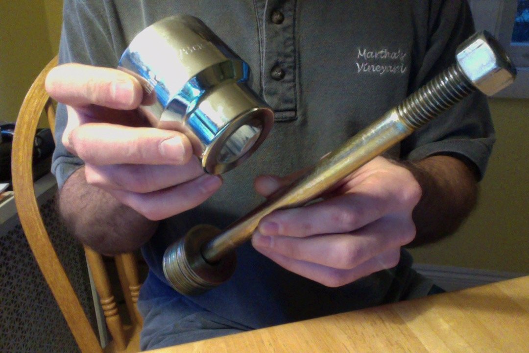

    I use a grade 8 bolt, a socket and a shit ton of washers to "pull" the bushing through.
    Plenty of lube to keep the bolt moving smoothly. :jerkoff:

    Pics of process?

    Sorry, I don't.
    I can post up pics of the tools though. :)
    .....cause who doesn't like pictures?

    1-7/8" socket.
    10 1/2" bolt.

    Thanks man! Saved to phone and will report back on attempt.
