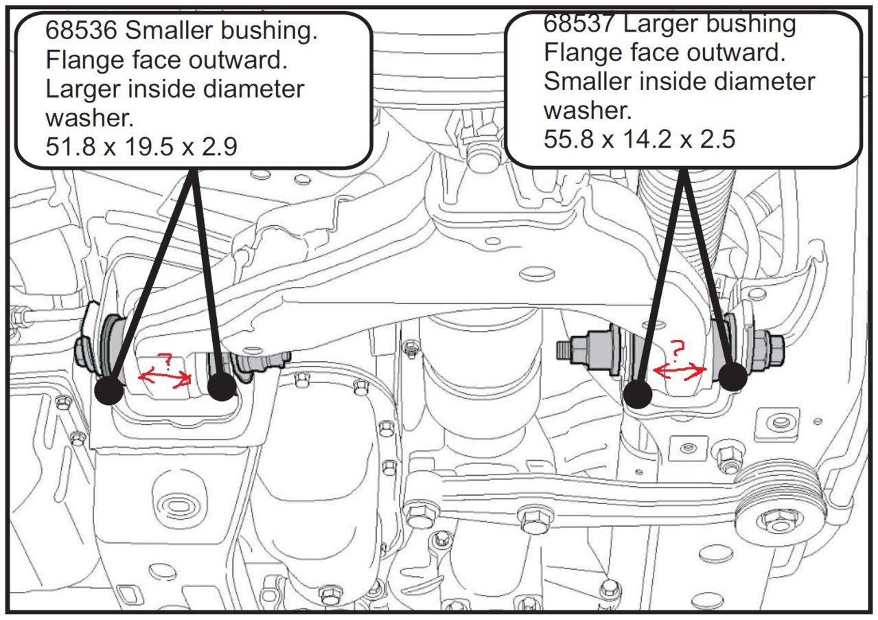

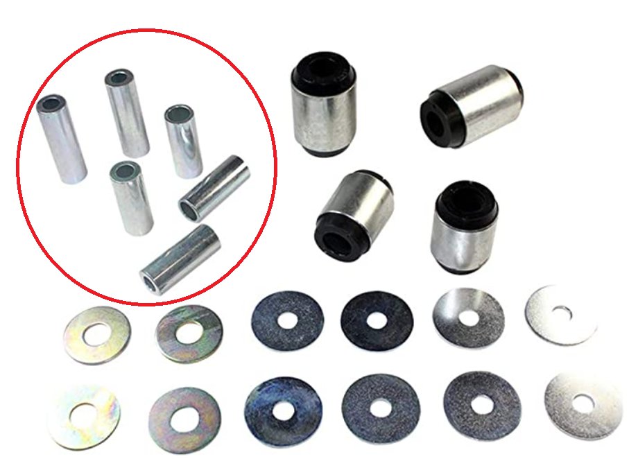

    With the whiteline bushings, what are the washers for? The pictures show like 14 different washers, and I assume I'm supposed to use at least some of them?
    And, what keeps the arm from sliding forward and backward on these bushings? Most other bushings have a flange at one or both ends (like a back-to-back "T" shape) which would bear axial loads. But the whitelines appear to be tubular on both ends, so do the arms slide forward and backward on them?
    Here's the diagram from the instructions. The crude red arrows indicate the motion I'm confused about. And ... it looks like I use one washer per bushing, slipping it in place after I hammer the arms back into position?
    I do not have the bushings to look at, trying to decide which ones to buy. I hate reusing sleeves so am drawn to the whitelines.
  9. Jun 24, 2021 at 12:37 PM
    #109
    EatSleepTacos
    Mar 24, 2015
    #151688
    59,846
    Randy
    West Valley, AZ
    2017 4Runner
    For the washers, they sandwich the bushing. There are extra ones, I'm not sure why. But 8 of them get used on our trucks.
    The bushings are a TIGHT press into the LCA. It's not like poly bushings where you can just push them in by hand. I had to pay a shop to press them in. The metal on metal friction keeps the LCA from sliding fore and aft.
    y=mx+b likes this.

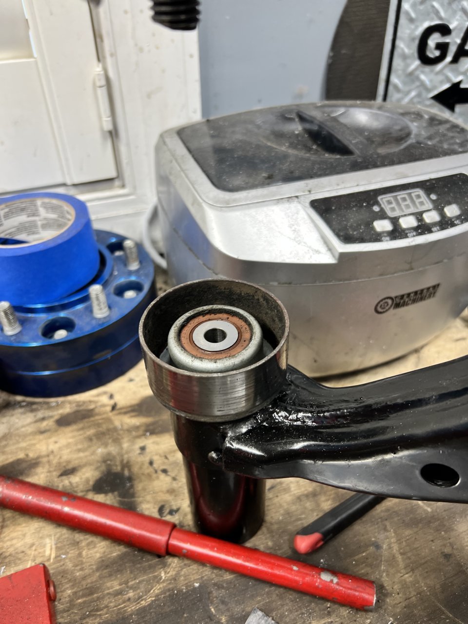

    Removed the oem bushings from the new oem LCA’s ready to have the white lines pressed in.
    ohcaltexscar, SR-71A and garciav like this.

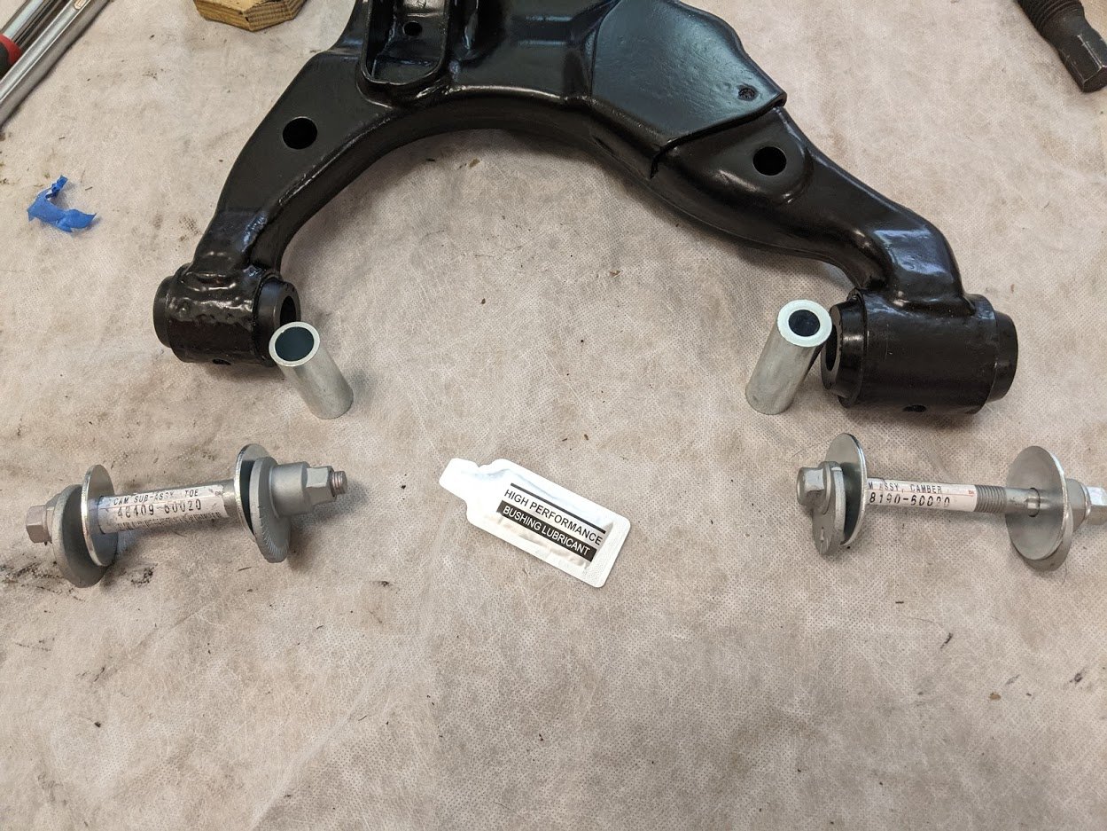

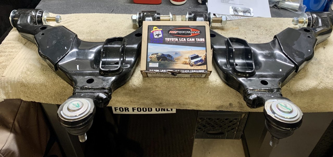

    97679AF1-CE3F-4EE4-8684-8DC9AE0C2A75.jpg Installed the Whiteline bushings into the new OEM LCA’s today. Freezer method and a thin coat of anti seize made the install go smooth.
    Will grease the outside of the internal bores and apply anti seize to the inside of the bores prior to assembly and install Monday.
    will be installing in conjunction with poly performance Toyota LCA Cam Tabs (taco tabs)

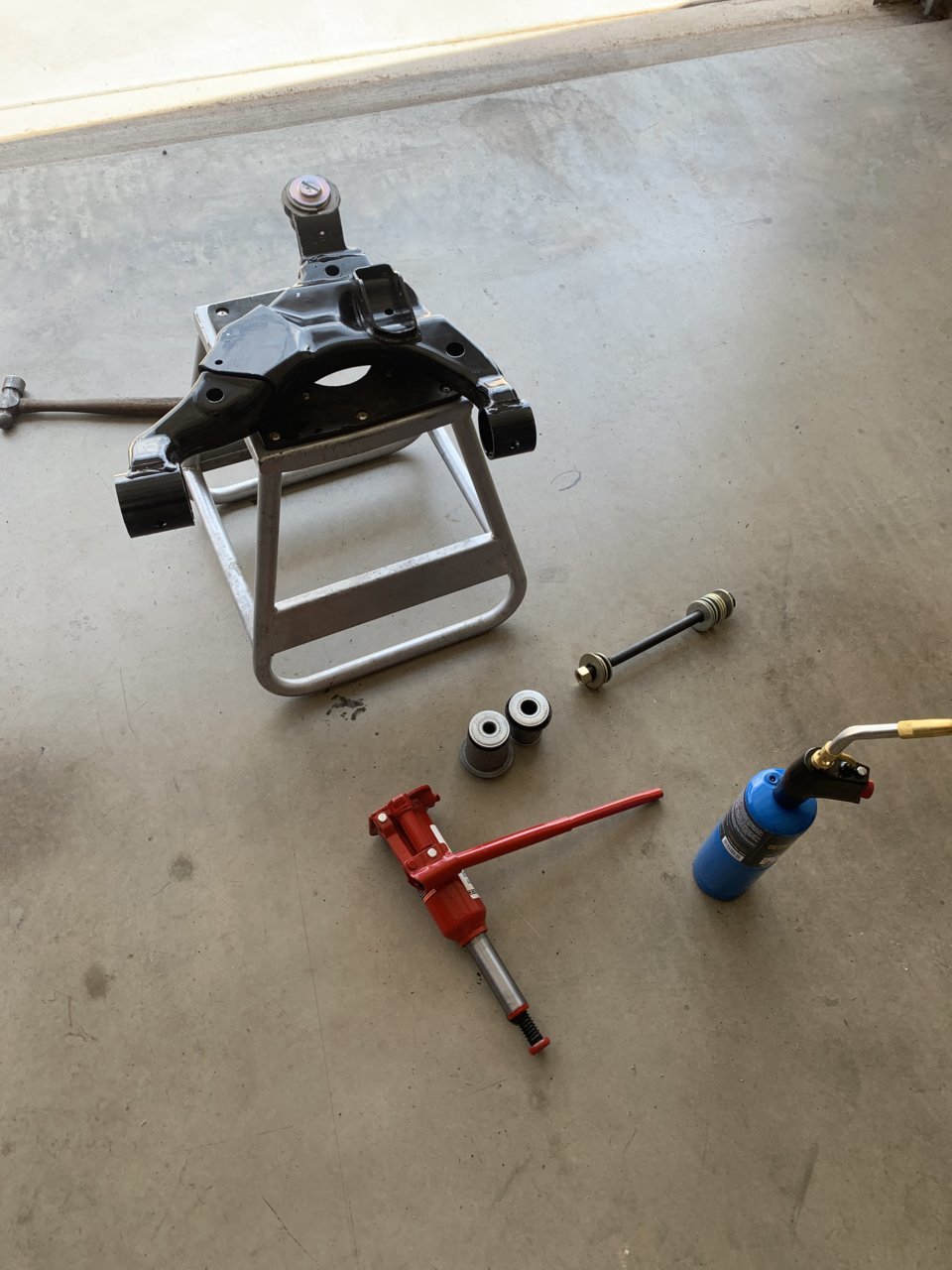

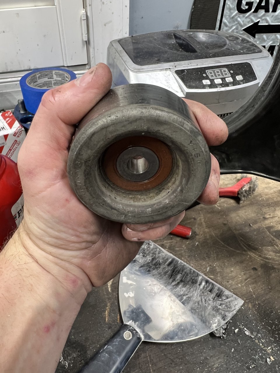

    I too just finished installing a set of whiteline bushings using a bottle jack and a ball joint service kit. Total PIA. I did however stumble upon a makeshift tool that hopefully makes the install easier for future TW folks…
    Installing the first bushing with a bottle jackjack is pretty straight forward. However, installing the second bushing with a bottle jack gets a little more complicated due to the fact that the base of the bottle jack needs to be positioned against the LCA. Most of the ball joint adapters (I have a master set) are to tall to fit between the LCA pivots along with the bottle jack.
    my solution- use an old fan belt pulley. The inside radius and offset are just enough to seat around the smaller whiteline bushing while making a solid, short base for the bottlejack to sit on. Worked like a champ.
    Taco47, Wulf, UtahTacoma02 and 5 others like this.

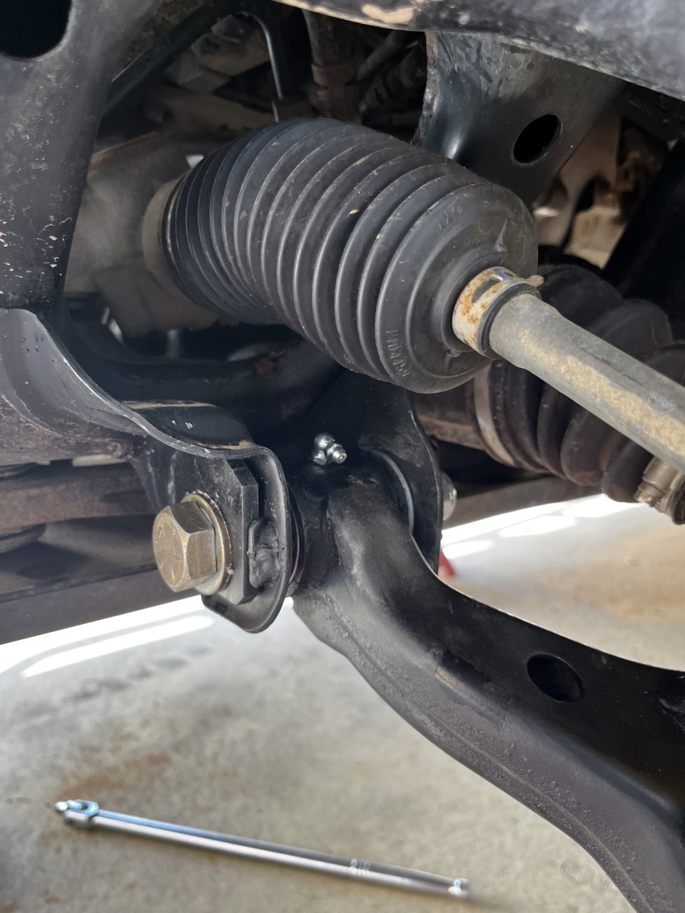

    Curious how this worked out for you, I'm considering doing the same since I am a major stickler on squeaks. Sounds like you did this after the bushings were pressed in? Do you have a pick of the access to the zerks when installed? Doing it on top makes the most sense for sure but I want to make sure there won't be anything in the way
  16. Sep 8, 2022 at 6:20 PM
    #116
    Squeaky Penguin
    Squeaky Penguin Nothing Ventured, Nothing Gained
    Apr 5, 2012
    #76340
    10,102
    Brett
    Steamboat Springs, Colorado
    '01 4WD, SR5, TRD & '13 TRDOR AC
    Lots of dust and custom dents, Check Build
    It's been flawless. All poly bushing should be greasable. I believe I drilled and tapped the arm before the bushings went in, and then drilled through the bushings after, but I don't recall for sure, and either way would work just fine. No problem with access or clearance on top.

    Decided to do a little extra while I had the LCAs off. Got the whitelines in and added the zerks, plus a 333 Cam eliminator kit and welded the tabs for a little extra insurance.
