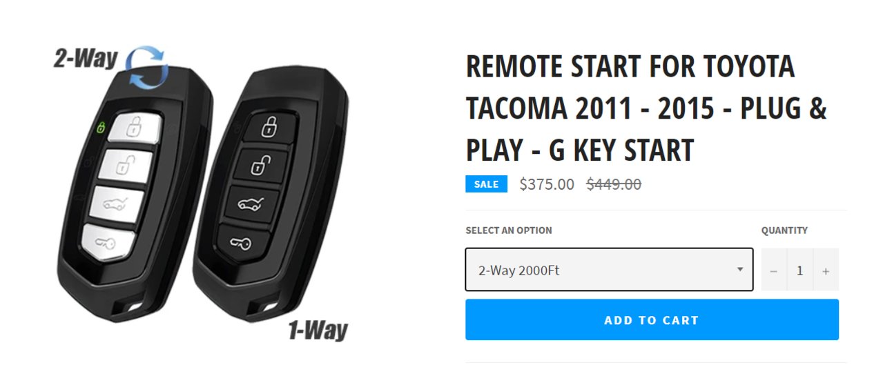

    So with this considered the 4th button is not functional unless your in a car with that feature? Not to be overly critical but for the money that they are asking, It seems to me that they would offer an exact need FOB.

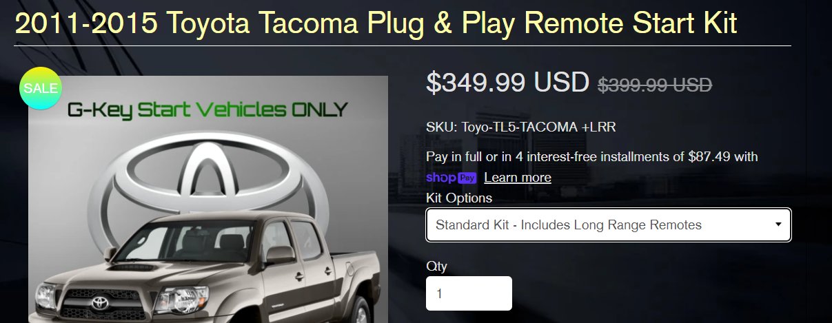

    I'm not sure where you're seeing that $540 but they're both essentially the same price. The only difference being that accessorides gives you the option of the less expensive 1-way remote whereas 12vsolutions comes standard with a 2-way remote. 2-way means you'll press start on the fob, and the fob will confirm when the truck has started. 1-way means you press start and just hope the truck started.

    One of the features I love most, confirms if you’ve locked, unlocked, started or shut off. :)

    Yes, i have the 2way remote so that it confirms the truck started and stopped running with a 1/4 mile range. Yes you can use the OEM fobs to start it but for more detail that you are wanting, i would call them and ask your questions or maybe they will chime in @Accessorides

    Well, I don't either at this point. I went back to their site where I was sure I saw $549 +/- and didn't see it. That's what I get for multi multi-tasking I guess. I have to run but I'm sure you have it right and I have crapped it up. I check back in this evening. So thanks for the info.

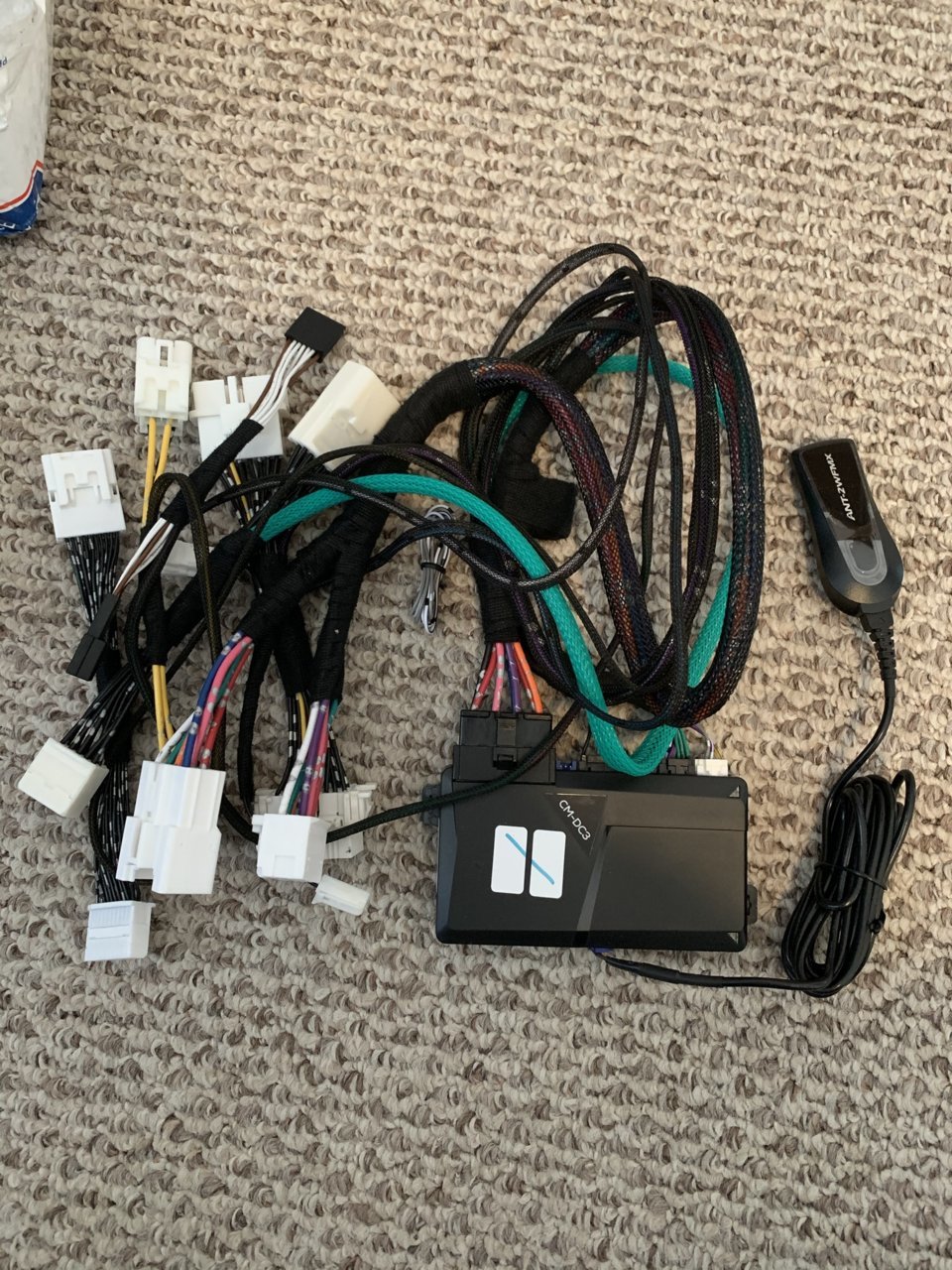

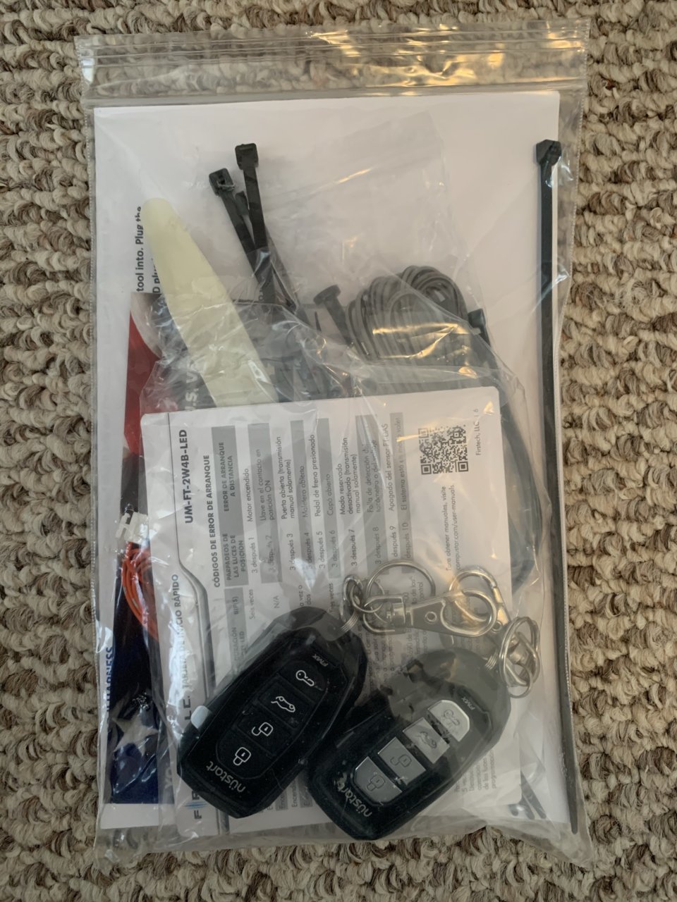

    Newer ones are using T- Harness so they are plug n play with no splicing. Makes a world of difference. Going to see if i have any pics of my kit and harness to post
    Accessorides kit below
