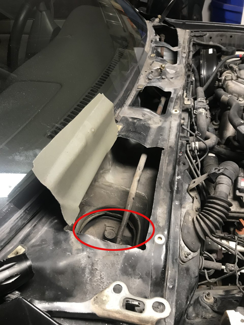

    curious if what i circled in red below is what the fresh air door thing looks like when it is closed and recirc air is on?
    i have had a horrible vibration at highway speeds (65 and up) this year when I have fresh air coming in, it seems to stop when I close the door for recirc air
    ... not sure what the vibration is going on in there?

    No that is just part of the cabin intake that price doesn’t move only funnels air into the bottom where the filter is
