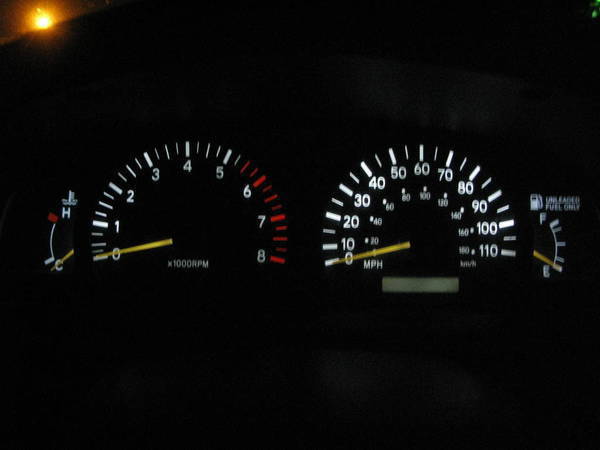

    I did white leds. It looks sweet.

    I'll go snap them right now.
    EDIT:[​IMG]

    I got them off a member on here, They are number 194, get the one's with the square top. The round ones don't really work well.
    I think that member got them from superbrightleds.com

    It's real simple, just plug them in to the base that holds them and screw it into the dash. only hard part is disconnecting the Locker and ect button, and the dimmer knob.

    I don't remember on how much, and the bulbs for the center are 74, I wouldn't do the red ones in the dash white, its not the bulbs that are red its a film over it, going white turns them pink.

    If you use the square style bulbs you won't get a hot spot using a rounded led will give you a hot spot.
    I think that the blue sleves would make it look white or clear.
