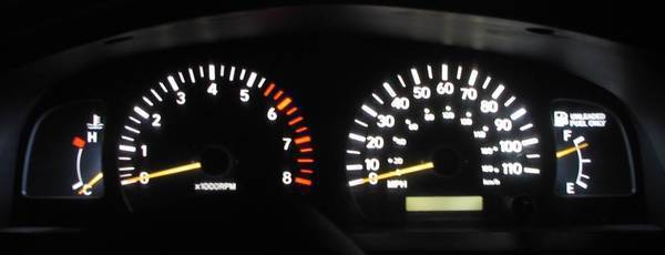

    This is from my build thread.
    And a picture.
    Depending on your year, some of the 1st gens have an orange filter in the instrument cluster.

    gona revive this, I realized a trend, the 98-00's have a white cluster with condoms on the lights, 01-04 has a condom, AND the back of the cluster has an orangeish film, so when I put a clear bulb I get a peach color which is totally lame!
    I want blue and red like vw/audi colors, not sure what to do though...

    I think you'd have to take them to a decal shop and have them make you new faces. Either clear, or with the color of filter you want.

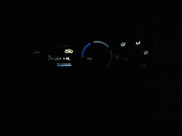

    LEDs made a huge difference in my dash and AC/heater panel:
    The LEDs do not dim but I'm fine with that.

    Interesting. Mine dim, they just shut off when they are still fairly bright.
