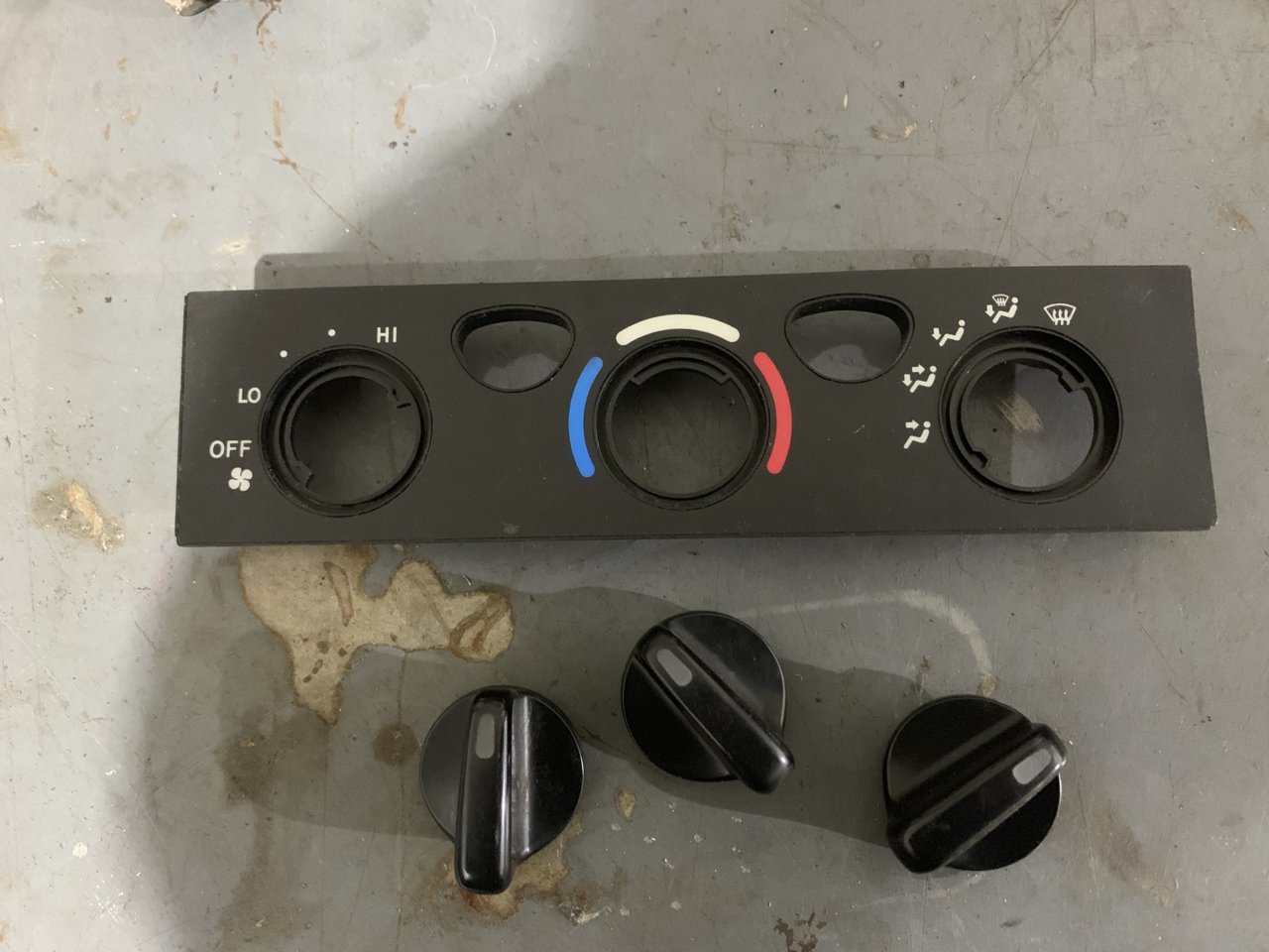

    Welp I'm an idiot and ordered NEO3 instead of NEO4 when I tore the dash apart again to fix my one flicker LED.
    But that didn't stop me. Grabbed the bulb holding wedge and was able to get the LED into it.
    [​IMG][​IMG]Untitled by Michael Halat, on Flickr
    Also installed a 4runner AC control panel so that my AC and Recirc glow green instead of orange now:
    That combined with new knobs really updates the look, and fixes my OCD because I had orange ac/recirc buttons but blue everything else. Now at least the LED's on my CB and these buttons match.
    I've got a spare 4runner cover and knobs for sale if anyone was looking for one now, PM me if interested.
    Also since I had a space AC control panel to play with that I was likely going to throw away (potentiometer is fucked and won't mix hot/cold and I tried the whole turn it back and forth a bunch of times trick) I decided to see what it would take to swap the led's behind the ac/buttons if someone REALLY wanted to.
    So here's a little guide on how to get in there:
    First pop off the front button covers, I used a dental pick to do this:
    Then undo the 4 screws on the back of the board (obvs open up the panel, you would need to do this for a normal led swap anyway).
    Now you can carefully pull the board out. The rest of the button body slides in and out of the white part of the panel. From there you are left with something like this:
    Now you gotta carefully undo the black clips and press the whole black thing out:
    The clips are easy but the post is delicate, I broke one of them:
    I put the black clip black on and it still holds well though.
    From there it's just a matter of soldering on a new LED:
    The biggest difficulty is the awkward shape of the LED. I found these that MIGHT work.
    https://www.amazon.com/200pcs-2x5x7mm-Rectangle-Rectangular-Diffused/dp/B013Y4D1FE
    The weird part is that even though the button bodies have an orange tint to them the actual buttons themselves are clear and not tinted.
    So replacing that LED should work for a color change. Of course this is only for someone who wants White, purple, or blue as it's much easier to get a 4runner hvac control for green, but I guess this route is much much cheaper potentially.

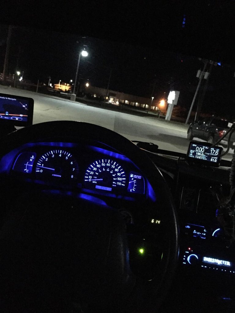

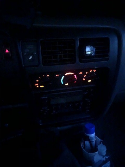

    How do I get lights that are CLEAN and BLUE like this?
  12. Oct 13, 2020 at 12:12 PM
    #732
    cynicalrider
    cynicalrider #NFG
    Jul 25, 2012
    #83399
    17,201
    Jersey
    01 SR5 TRD 4x4, '23 Bronco Wildtrak, 2017 HSQV FE350
    Drop bracket lift and booger welds
    Do like he did and order from super bright LED's.

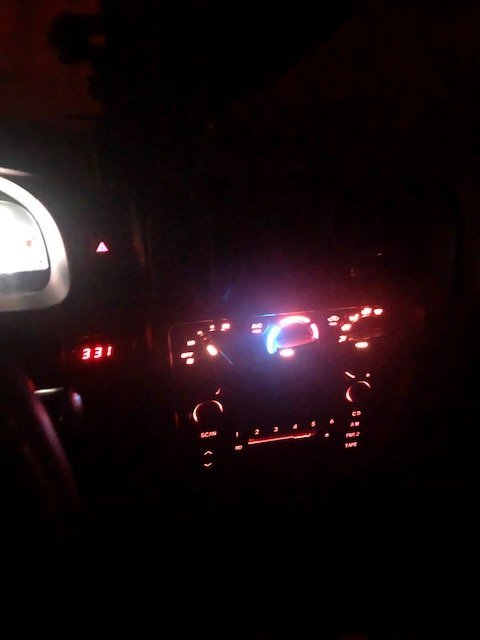

    I need to figure out what HVAC light to order, and how to paint my needles white
  14. Oct 13, 2020 at 12:45 PM
    #734
    cynicalrider
    cynicalrider #NFG
    Jul 25, 2012
    #83399
    17,201
    Jersey
    NEO4's for the HVAC, but that wont help you without the 4runner faceplate. You will have bad hot spots otherwise. I wouldn't recommend your needles being white with a white background. (His needles aren't white btw if that is what you are basing your wishes on)

    I'm stuck with the amber HVAC lights unless I swap to a 4runner faceplate? What's the part #

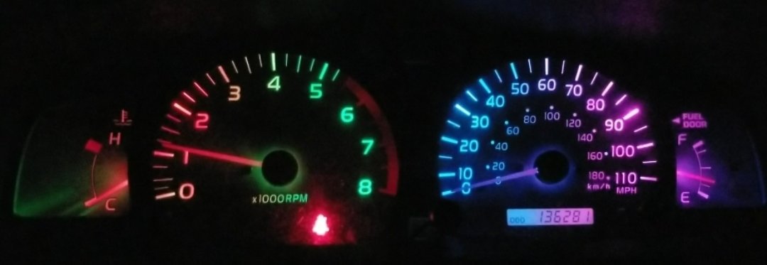

    Turn signal mod
    Screenshot_20201018-122925_Gallery.jpgWhy be locked into any 1 specific color when you can choose em all!

    Can someone clarify what I need to turn my AC lights blue? Just a 4runner faceplate? I have a 2002 Tacoma and my faceplate looks identical to the one below. Any way I can run blue lights without having the 4runner light rings on the faceplate?
