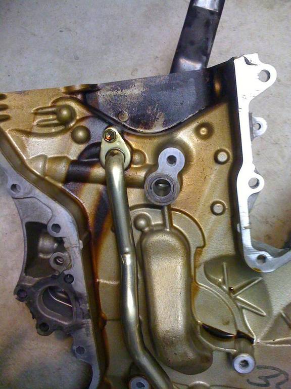

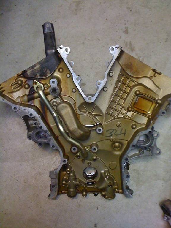

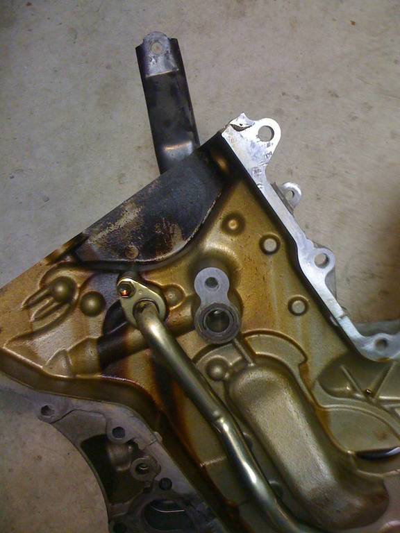

    Second Link:
    notice black streaks where you pour oil into engine. This engine most likely failed because somebody had poured something other than oil. Thats also the side where components had failed. Again, somebody pouring something other than oil into engine is maintenance failure.
