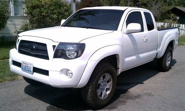

    I paint matched mine myself. I would definitely suggest doing, especially if your buddy is going to do it for you professionaly in a shop. As you can see I also painted the mirror "bracket" or "arm" or whatever it would be called, which the sports do not have. I think it looks awesome like that, virtually nobody on here has that.
    The door handles are surprisingly the easiest thing in world to take off! no door panel removal needed. open your door, pull out the small round black plug, and unscrew the one bolt (it should NOT come all the way out, just let it hang in there). The lock machanism comes right out and the door handle just pulls out, not straight out like you're trying to open the door rather slide it towards the front of your truck. SUPER easy. I rolled down my windows and drove around for a couple days with them out while I prepped and painted and let them cure. just reach inside and open your door that way. Good luck!
    I painted my front grill surround too by the way...

    Paint, believe it or not, is all rattle can. It's all about the prep work and how you lay down the paint. Paint I got from ebay seller Spraycansunlimited, perfect super white match. granted they are really expensive spray paint cans, but they're as close as you'll get to a professional spray gun. In as short of an explanation as possible, the steps are:
    1. rough up mirrors/handles whatever it is you're painting, with fine grit sandpaper.
    2. wipe off with paint thinner or vinegar or some other cleaner to remove oils/grease from your hands and fingers DO NOT touch the parts you will be painting again without using a cloth or something.
    3. Spray a couple coats of Bulldog Adhesion Promoter! let it get tacky inbetween coats (5 mins) and don't let it dry completely before you primer, you want it to be tacky when you start step 4
    4. Primer, a few coats, 5 minutes or so inbetween, don't let it dry completely but it shouldn't be glossy wet. let it dry completely (1 hour in the sun?). Wet sand with scotch brite pad or extremely fine grit sandpaper. this is an important step, it gets rid of the orange peel effect, keeps it smooth. after wet sanding spray it lightly with water to get all the dust off and then again let it dry. now you're ready to paint.
    5. lay down as many coats as you think are necessary, not too heavy, maybe 3 coats, with 10 mins inbetween, same thing should be tacky but not wet but not dry. lay down a final coat thicker than the rest but not too thick to where it drips, this is the hardest part and it sucks! this is where you get your gloss and shine, its not all from the clear coat.
    6. Clear coat - same process, let the paint get tacky then lay down a few coats, 5 or 10 mins inbetween.
    7. let it cure overnight or all day, even if it is dry to the touch it will be soft and delicate and should not be handled or re-installed.
    8. That's the poor man's route to painting! obviously getting them painting professionaly like the OP is a better route, cus you're still going to spend close to $100 on supplies when buying nice rattle cans, primer, clear, sandpaper, 3M tape (did I mention tape off everything you DON"T want painted haha).
    There are plenty of other threads explaining those same or close to steps, read through a few of them to educate yourelf and then go for it. Thats what I did. I've never been a do-it-urself guy until I got some stand up jet skis and I just started teaching myself how to tinker, paint, etc.
    It is extremely easy, as I wrote about in an above post. you don't even need the writeup, I explained it in a few sentences, it truly is cake!
    Tailgate handle looks good! I did the same, just don't have pics of it for some reason :rolleyes:
    $100 and no headache of literally spending an entire saturday to prep and paint AND having it come out professionaly done, thats a damn good deal!
    There you go, process I used explained above.
