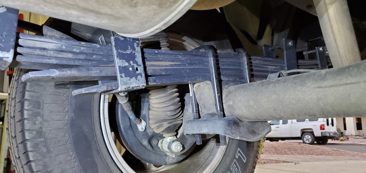

    I'm glad someone else has W shaped springs, I almost made a post about that in itself, there's only about 5k miles on these... Is this normal?

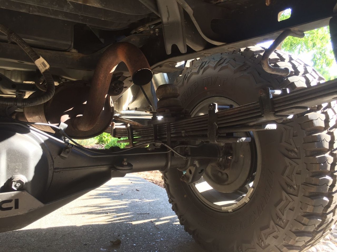

    Cobra 29 WXNWBT, Devil Horns, ARB Bumper, Avid Stepbars, Homer Taco Satoshi thin lip grille, ICON UCA's, ICON EXT Travel up front with King 700# springs, Dakar heavy springs, sumo bump stops, with ICON VS 2.0 shocks in the rear, K&N Drop In, AVS Ventshades and Bugflector, Whelen SPS 660 emergency strobes, Redline Hood struts and tailgate EZdown, Illuminated 4X4 Switch, TRD Floor mats, Flyzeye LED lighting, Kragen 7" HID behind grille, Kragen 4" HID back up lights, Rigid SR Series 10" LEDx2 Elusive elements Lightbar, Firestik antenna, Rear Diff breather mod, Fogs anytime, Hitch Safe, OEM door sill strips, mryo mirror relocate bracket, Prinsu designs roof rack, Tepui Autana RTT, ARB Awning,Engo 10k winch synthetic, Blue seas fuse block and breaker, ARE Topper

    how are those leafs so flat looking? I have a lot of weight and mine are still kinda arched...???
  17. Nov 20, 2019 at 9:42 PM
    #17
    little squirt
    little squirt 808 ALLDAY!!
    Aug 7, 2012
    #84293
    2,336
    808 ALLDAY!!
    6 yrs of wheeling.....full steel skids front--->rear. sliders, winch, full steel bumpers/front & Rear with BF rear HC and swing out w/full size spare, Tepui, bed rack, truck tool box full of chit, full stereo etc.....just wild how those OP pics look soo flat'n out....maybe not seeing something?? or different steel content now days??

    OP leafs almost look "wavy" in a way.....weird, are they the Dakar HD packs? I can grab a pic of my yellow stamping ontop of my leaf pack if you want.....should be able to find it under the dirt etc for @mikalcarbine for comparison if you want.

    Ya they are dakars, I bought the HD pack and already removed the 3rd leaf, to my knowledge I can't remove anymore leafs per ARBs recommendation. I'll contact ARB about the W shape, I wonder if having more arch would improve my horrendous ride quality? These are less than half a year old and I have no weight in my bed

    Those leaves are trashed. Leaf springs should never be W shaped, and there should not be huge gaps between all the leaves. No wonder your ride quality is horrendous. Do you have proper bump stops installed? That condition is usually caused by people wheeling their truck hard without proper bump stops and forcing the spring into such a recurve that the springs are bent backwards.
    The way leaf springs work is that the leaves load from the top down. The main leaves at the top are in contact and support the weight they are designed for. The spring is arched under normal load. As load is applied, the bottom leaves in the pack engage, then the first overload, then the second overload. This gives leaf springs a distinct advantage over coil springs, and it's the reason that leaves are still used today. This progressive stacking gives them the ability to support huge weight shifts. In a hill climb, especially on a rutted hill, leaf springs prevent catastrophic weight transfer that could result in a roll over.
